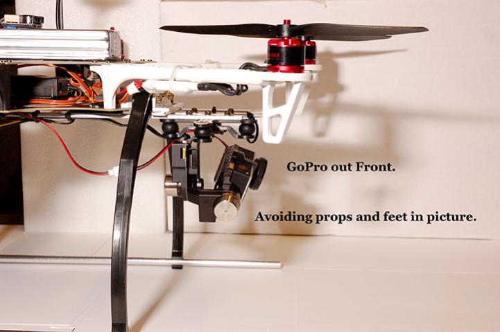

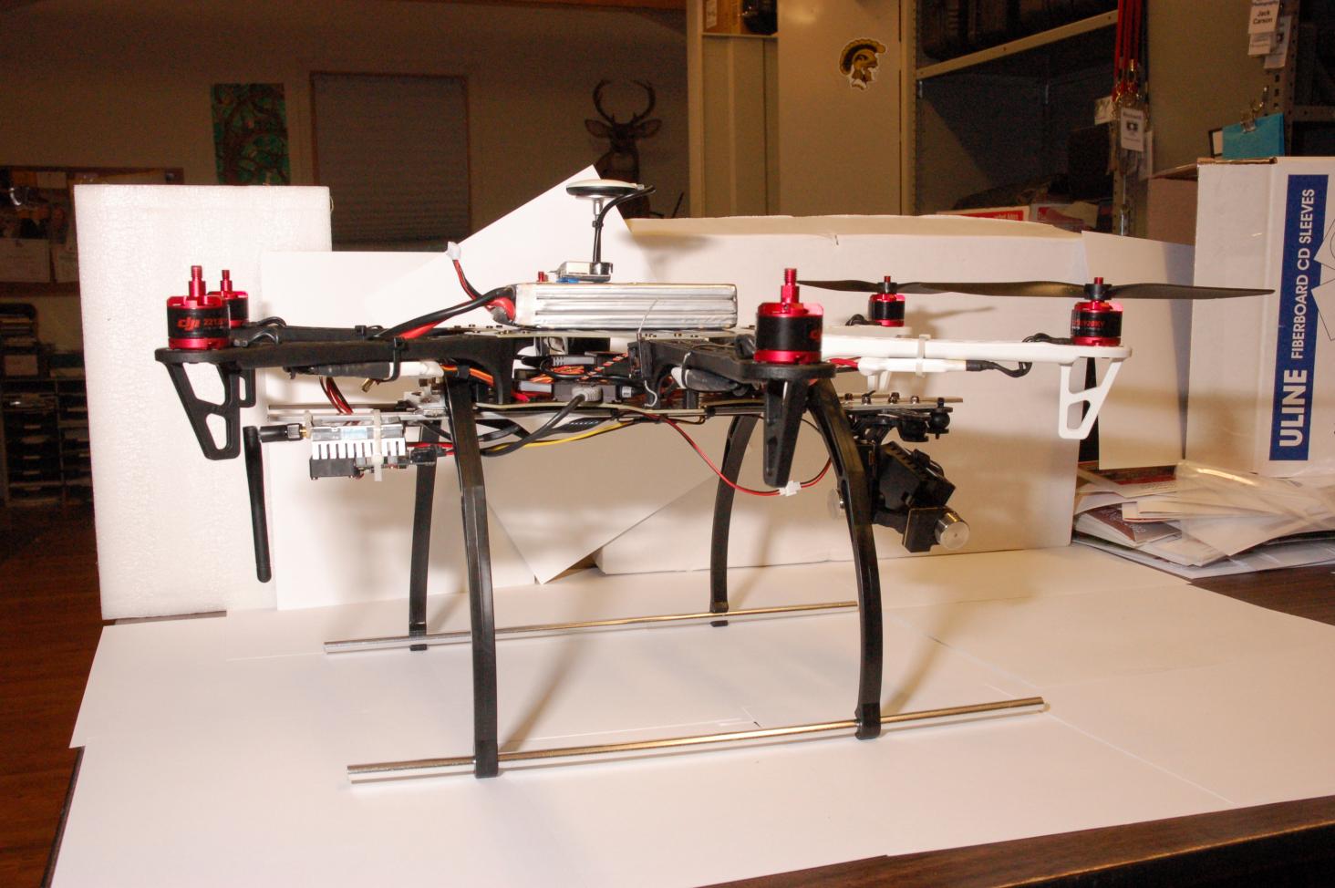

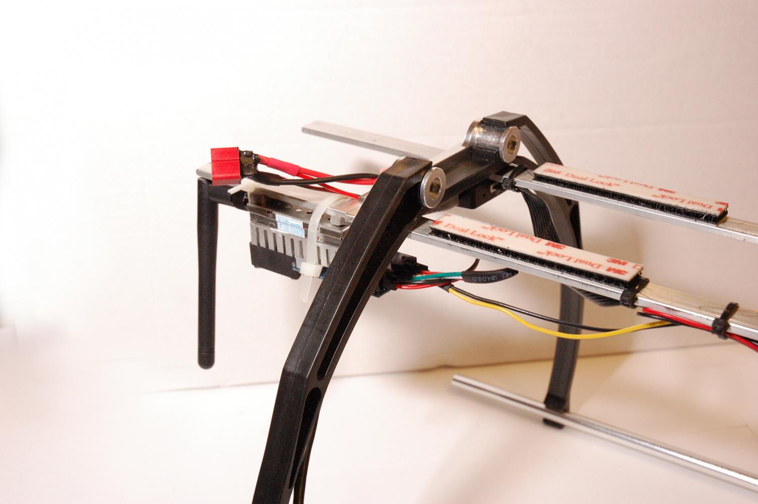

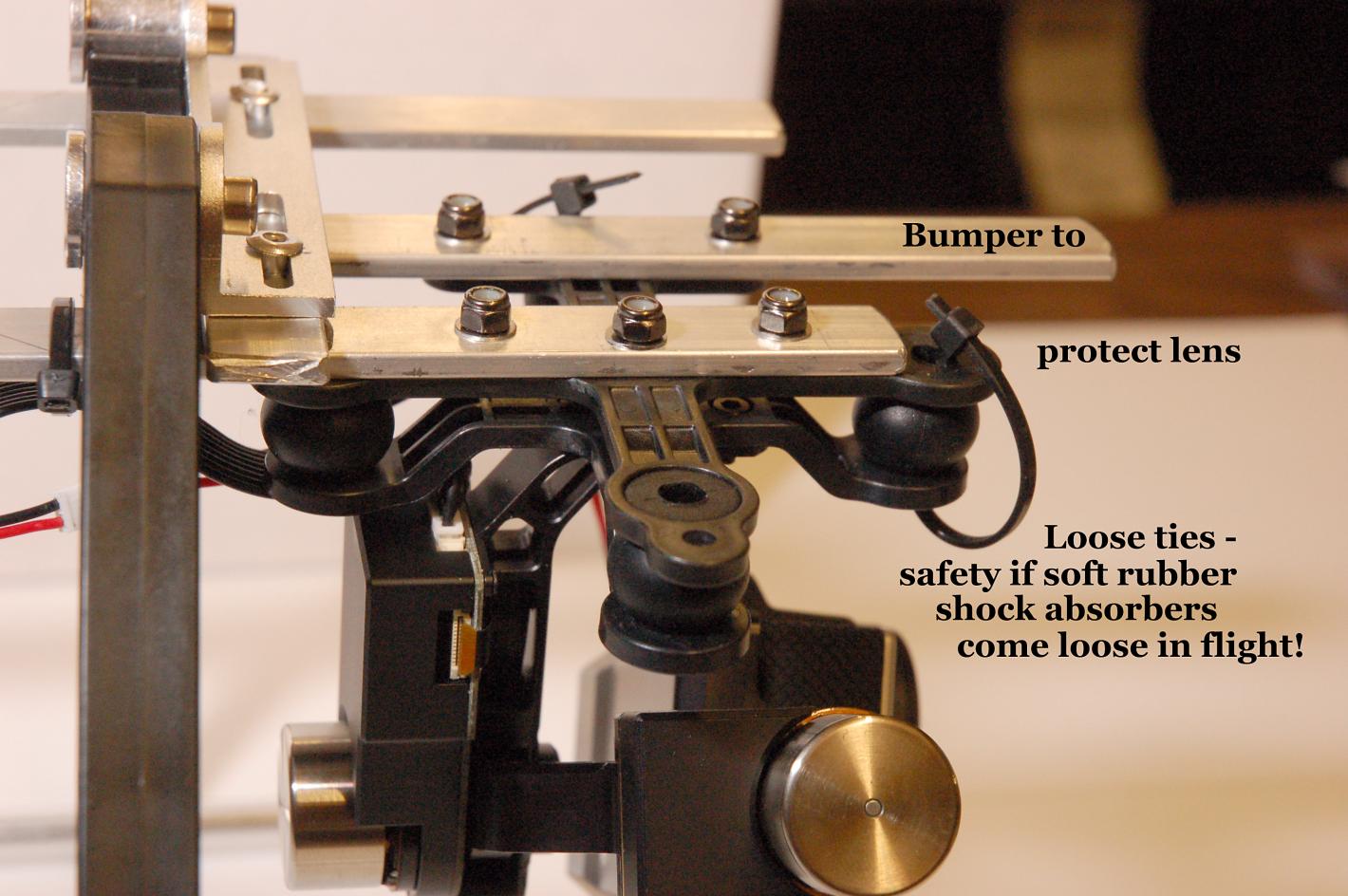

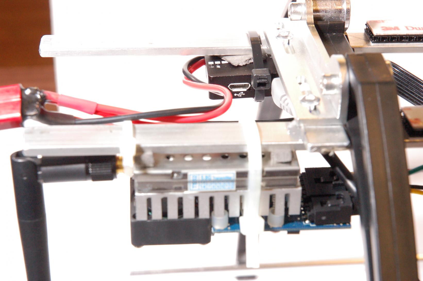

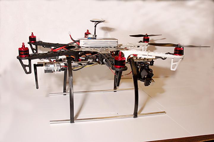

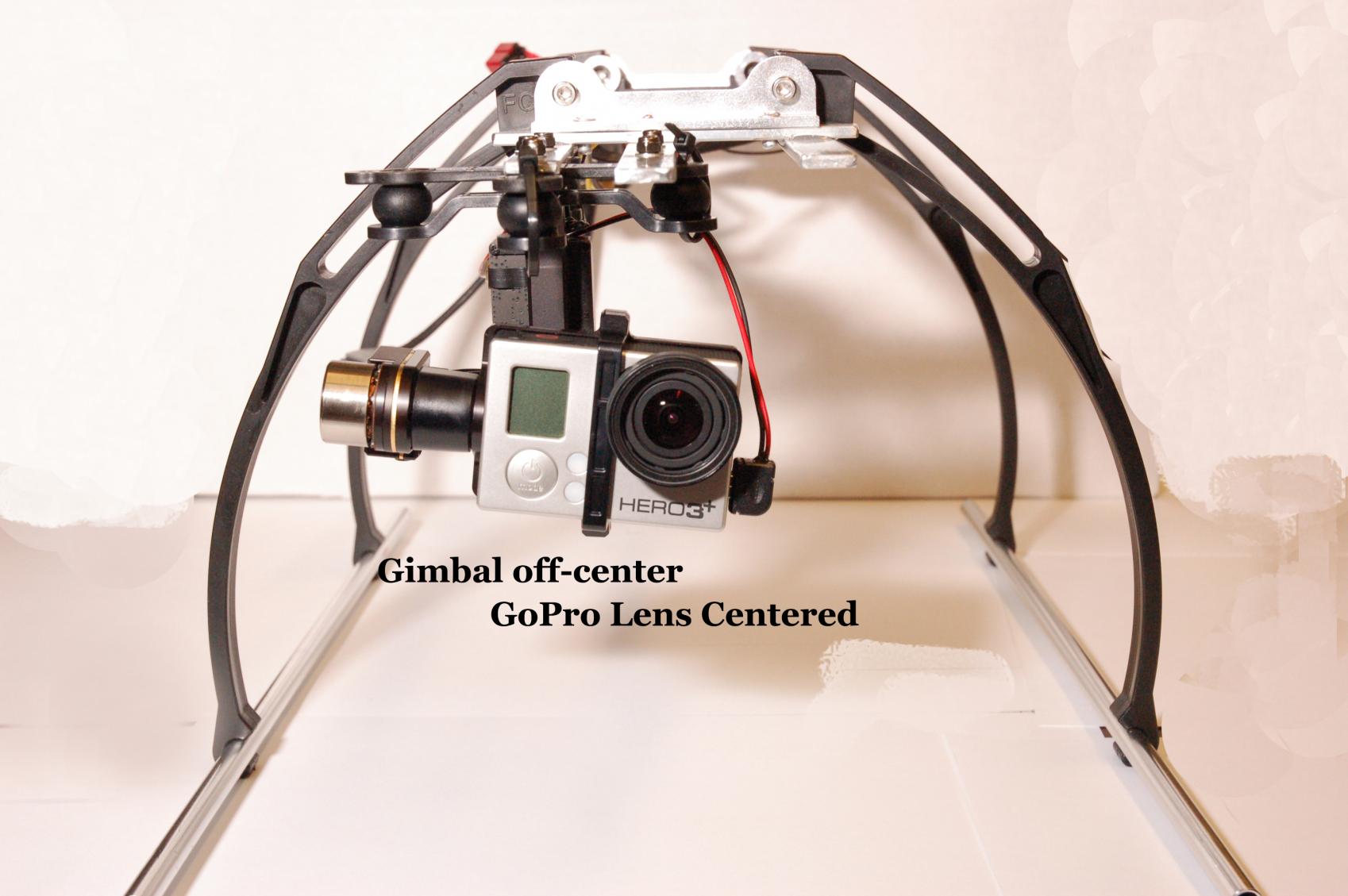

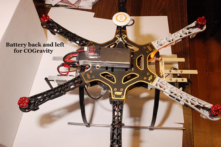

I know how much time I spent pouring over your pictures to answer my questions and come up with ideas. So here's what I have to share:
View attachment 16098View attachment 16099

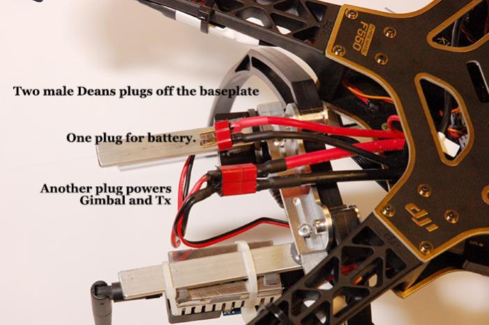

I put my Gimbal/GoPro, GCU, and Video Tx all on the landing gear. This way I can disconnect 2 plugs (Battery harness and GCU to PMU cable) an lift off the 550 for practice flying.
View attachment 16097View attachment 16096View attachment 16095
Using Aluminum instead of Carbon Fiber for the bracket cost me one ounce. 3.8oz vs. 2.8. But I trust my holes in aluminum, and I got to use pop rivets that I already owned. I spread the legs and put the bracket underneath to get the 550 down inside.
I located the TX, the GPS, the GoPro, and the two RX antennas as far apart as I could. Hence the jib sticking out the back for the Video Tx.
View attachment 16094View attachment 16093View attachment 16092View attachment 16090View attachment 16089
Total weight = 4lbs 13.6 oz.

Hi JoeBob,
Thanks for the nod but YOU did it! Glad to hear it flies and everything is working.
Two things though, with the camera mount offset does it still balance down the center (along the roll axis)?
THe second set of wires coming off of the Deans plug, are they going to the power dist pads in the lower frame plate? edit....nevermind, I just saw that you have two wires coming off of the frame plate and one set is the larger size for power to the motors.
Looks great and thanks for posting the pics!
Bart
JoeBob
Elevation via Flatulation
Doesn't everyone roll their hexacopter on a beer bottle to establish COG?
(Okay, I had to use a vacuum cleaner wand for the long axis. Not as much fun.)
The GoPro and the Tx are both offset 1 inch to starboard; but the battery weighs so much more, that .5 inch offset to port evens it out.
Balancing bow to stern was a much smaller input to the rear that I had anticipated. I originally had planned to have the battery strapped back on the bracket above the Tx.
Right. I borrowed that idea from your soldering video. One 12 gauge set of wires from DJI and one set of 10 gauge wire as recommended by Bart. And the liquid electrical tape saved my tush on that one, because those were some ugly looking bumps of solder.
Heads up: If you have two male battery connectors on the plate, and are running one battery and not using the other connection as a power port; you need to cap the free connector. Once you hook up a battery, the free connector becomes a charged male end looking to bite you.
In the back of my mind I'm considering using two batteries for longer flights without the landing gear and camera. But I need the blessings of someone more knowledgeable than myself:
If I plug 2 3S 5200mah batteries into the frame plate at the same time, do I get 6S 10,400mah? Or do I get a small explosion without confetti?
Does the FC need to be re-programmed? For 6S or for confetti?
JoeBob;146619 Heads up: If you have two male battery connectors on the plate said:
You are using Deans plugs then it would not hurt to put a dummy plug on there to stop in inadvertently shorting the connections
If you add batteries in parallel (+ to + -to -) then you get a theoretical adding of capacities so 2X 3s 4000mah = 3s 8000mah.
