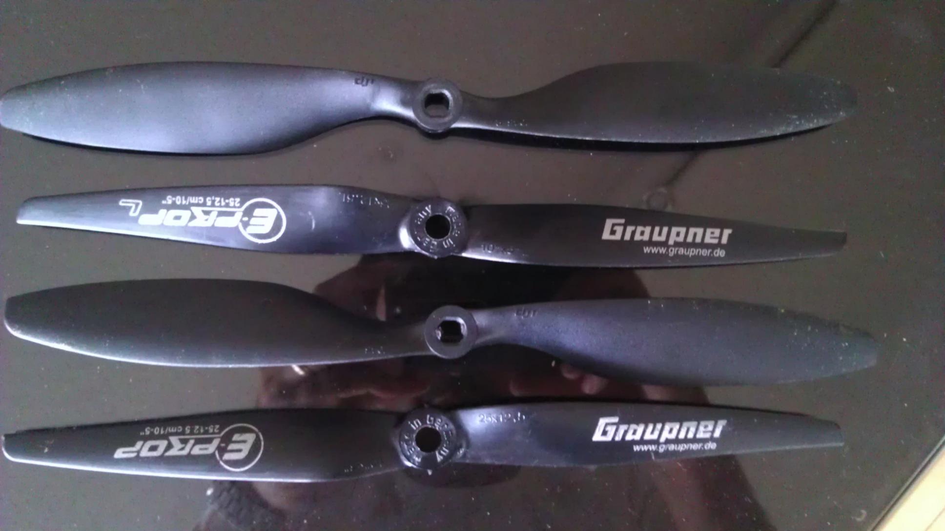

Something wrong and I hope you guys can help.
I put the washers and the props in. Graupner 10-5L are installed on the counter rotating and the one without L on the clockwise rotating motors.
I try to fly and the thing doesnt get out the ground...
Is it the other way around? 10-5L would be the clockwise motors?
if you stand behind the craft and look forward, it is the fornt left and rear right that get the L....... when your still at the back, the prop blades on your side of the motor outermost blade spins in towards itself, if you spin it around, the outermost props spin towards themselves
look at naza assistant one more time if i jacked up your thought, when you pick what kinda mr you have, it shows the spin direction
that was a quad....... i'm not sure on the hex...... i always forget theres other than 4 motors
If you look at assistant and your motors spin right, the props spin so air goes down
frviana
Something wrong... the motors are spinning in the proper direction... just like they were working before.
First front right spins counter clock wise and to the left is clockwise, counter clock...
The counterclock I put the L prop and clockwise I put the other prop.
It won't fly... feels like its trying to go down but when I invert the rotor get out of balance and it tilts when I put power.
take us a picture from the top all installed. when you start the motors, do they spin so air goes down? writing on top?you gotta look at it, but you can make which way it's going by how it spins..... you gotta look at each one, start em, let em stop, that way you see the spin.
frviana
I just put my old prop on top of the new graupner and I see that the L Graupner is the same of my right prop... So weird... I am comparing one by one to see if they made a mistake or something... I will post a pict.
hahaha wtf
we'll get ya flyin, i ask so many questions your bound to stumble on it sooner or later......
frviana
frviana
Got it flying... it is inverted... L is right and blank is Left. WTF
It was out of balance because after I changed the props I didn't balance it... working on it now.

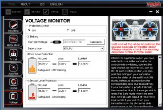

I'm having a problem of my VU start blinking red within a couple min of flight... when I check battery voltage monitoring and
View attachment 6290 its on 15.6 which is too soon according to my config.
Any tips?
tstrike
pendejo grande
it blinks red when you're giving it throttle sometimes, does it go back to normal when you hover?
