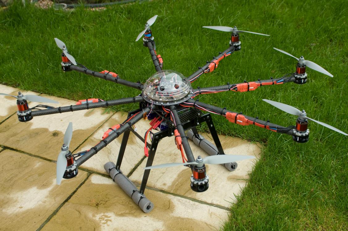

Right guys, here's the story. I have all props connected the right way, all motors spin the right way. I had the Mrs hold the octo above her head & she confirmed the stick inputs are correct. So I placed the octo on the deck, started the motors & slowly advanced the throttle....it lifted off the deck at 7/8ths throttle setting!
Im using 2 x 4000mah (35-70c) lipos(in parallel). Motos are 2.3Kg thrust & using 12x6 props. I did by accident get her about 7ft in the air...hurray my first ever MR flight :)
But bringing her down was bloody awful, bounced her 3 times as I needed full throttle.....anyone have any ideas? Im running 0.86d firmware on a Droidworx SJ8.

Yeah that seem fine. I see that you're using regular ESC, did you do the throttle calibration for ESC? I can't say anything else, your craft should take off with a %50 throttle.
nice job Ross!!! And it even has the ability to fly, eh?? well done.
like ovdt said it should fly at a much lower power setting. calibrating the ESC's is easy with the pwm/I2c converter that you've got and it's explained pretty well in the directions that you've got the link for. try the calibration again and let us know how it goes.
it'll probably fly with even less than 50% considering the big motors and props you've got there. you might want to consider a bit of ballast to help mellow it out a little. smaller props would also do the trick if you have them handy.
