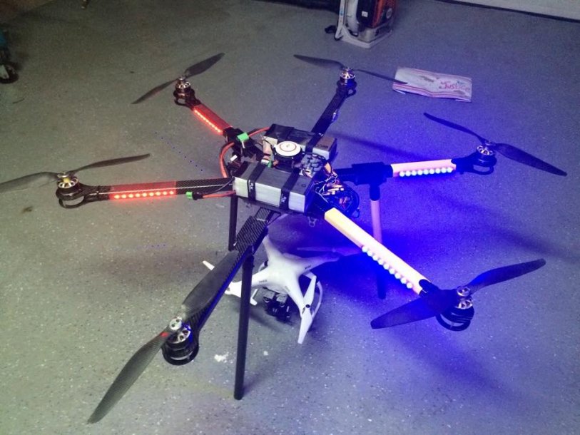

I've had a chance to use the tarot retracts the last few days. They work flawlessly. I did order spares as I didn't expect much for $25 but like I said in a previous post they appear to be very well made and smartly designed. I don't know why 2 of the mounting holes are drilled and tapped for 3mm and the other 2 holes are drilled as 3mm clearance holes but no big deal.
If they last they could be the best value on the market.
