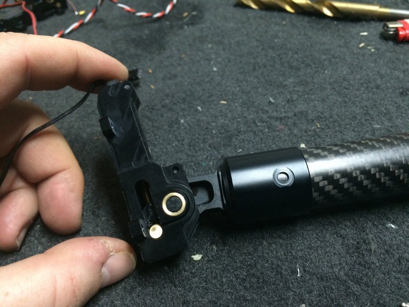

I just got them. They appear to be very well made. Friction points are bronze on steel. The body is cnc'd aluminum. Very light and come with a 25mm leg cup. The downfall, You need their controller to make them work and it only has 2 outputs which is fine for most applications but I like 3 straight legs vs 2 "T" legs. It is more stable imo.

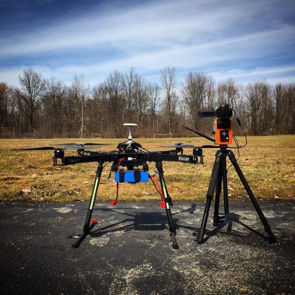

I have 3 sets of the Tarot retracts on rigs from 9lbs to 28 lbs... they ROCK. And for the price having a few extra as back up is feasible.
This is a "smaller" rig I was testing the Soloshot2 robot camera man with, but it usually has a Zenmuse strapped to it... :D (and usually a WKM.. HAHA)

Here is a pic.
I'm just wondering if the control can handle enough current to drive 3 retracts or maybe I'll have to use 2 controllers. I guess the only way to find out is to test.

I would use 2 controllers, the controller has a safety built in, not sure you could tap a 2nd retract onto that channel and have it still work.

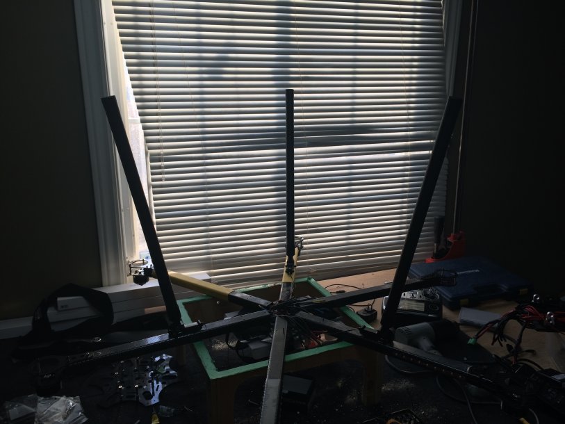

This is basically how mine will be mounted. Imo a tripod is just so much more stable than two "T's".
So instead of the kit I just ordered the actuators and 25mm legs. Rather than using the rivits to permanently attach the legs I will use pins so I can remove before putting in case. Sorry about lightingView attachment 24119

Pumpkinguy, I agree on the tripod, but I'm flying two X8's. I could make it work though, it would just bug my OCD :D
