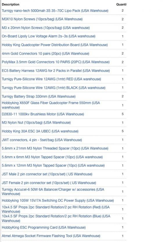

Here is the parts list that I initially ordered from Hobby King. The additional items were the Multiwii board from Witespy, which takes a it more tweaking, but is far more flexible with a ton of features, if you're willing to put the time in.
You can see that I ordered and extra ESC, and an extra motor. I ordered extra props as well, from both HK and Witespy. If I had it to do over again, I would have ordered some extra arms and motor mounts from HK the first time around. But after several crashes, it's still holding up pretty well, so I haven't really needed them. Again, remember that this is MY build, and was an attempt to get me what I was after, namely, practice and eventual aerial video. So your desires and goals may differ, and there is certainly improvement to be had in these choices I made...
