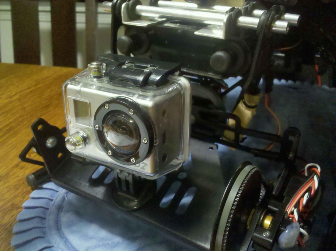

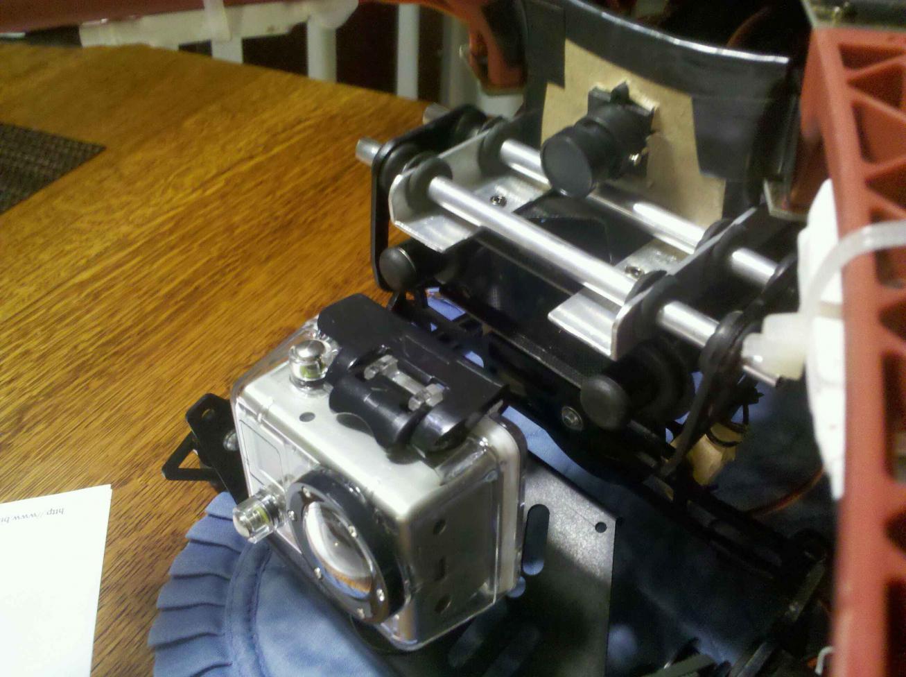

I have that same gear and camera mount. I ended up making a couple of rails out of some small aluminum L stock. I mounted these rails on the top side of the camera mount that comes with the landing gear. Two short pieces of aluminum tubing mount the CX113 to the rails. There wasn’t enough room to mount CX113 on the bottom side of the support tubing and keep the camera mount off the ground. The mount is very solid on the aircraft.
I have been working to smooth out the video quality which has been a problem. I don’t have any jello but there is a consistent shakiness that is causing me problems. I think the problem may be caused by having the camera out in the prop wash. I can side the whole thing aft an inch or so and see if it helps. If that does work, I'll see if I get the mount positioned directly below the center of the bottom plate...
Here is a short clip of the shakiness http://youtu.be/BV8DCXmHrYg

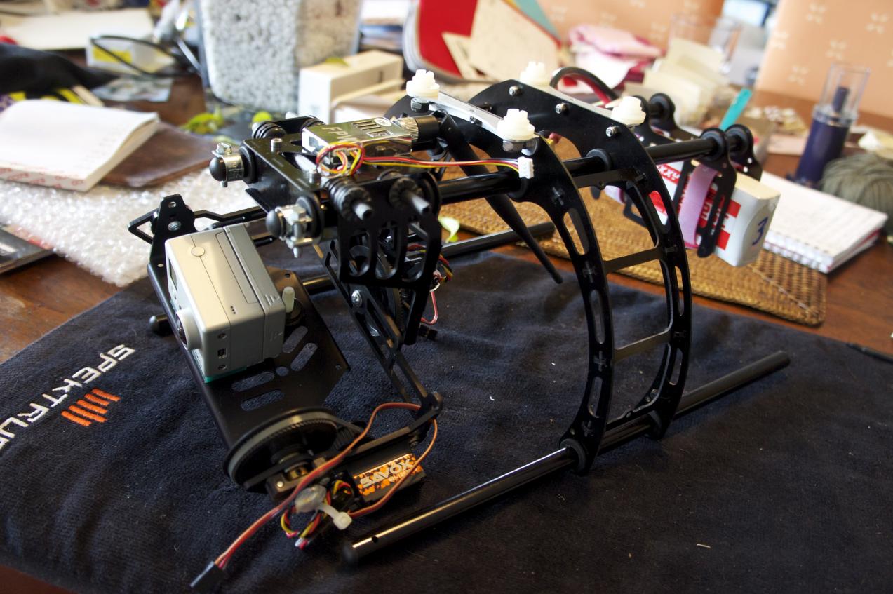

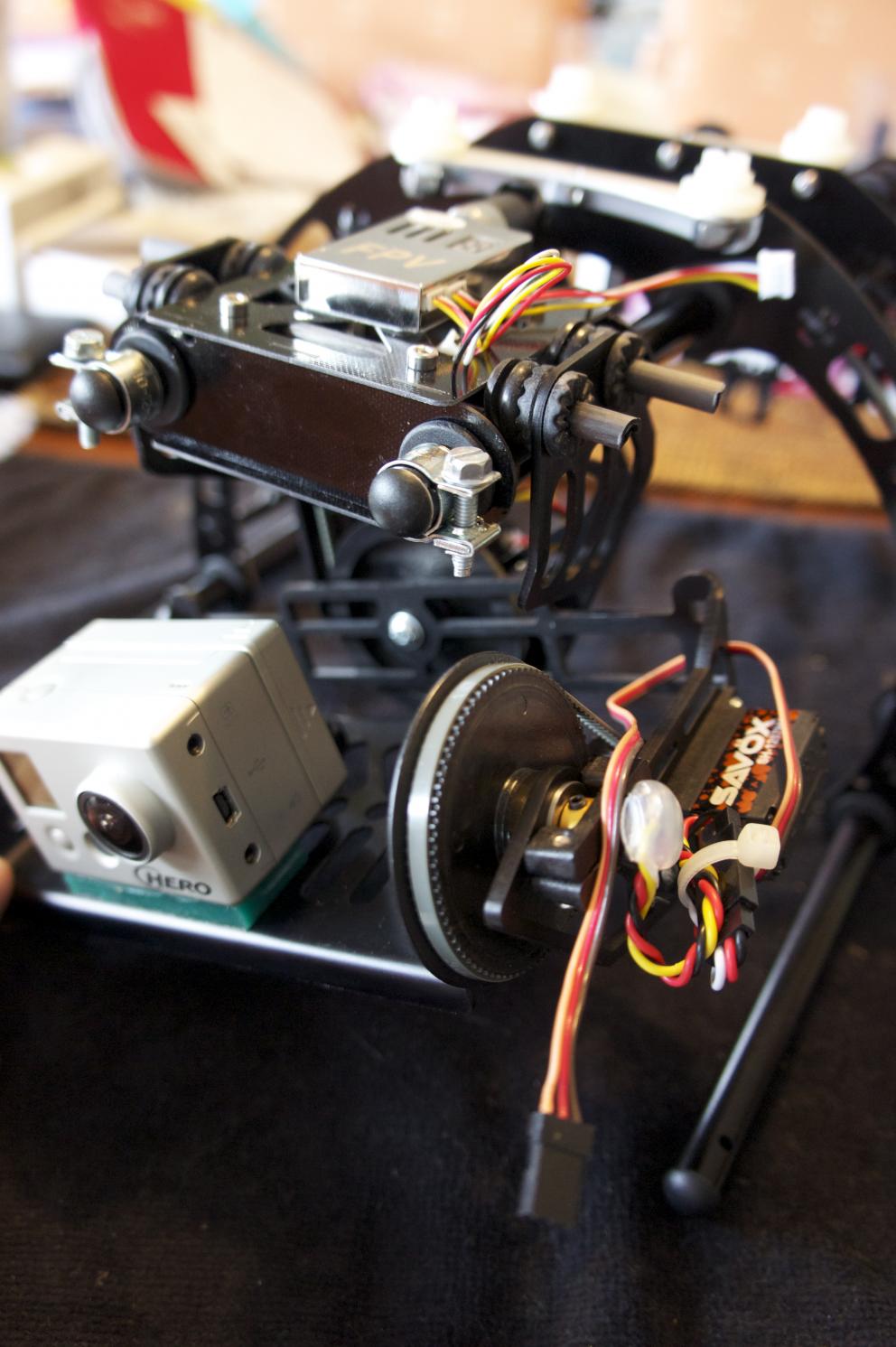

Almost completed my build . Seems like we came up with the same solution with minor changes.
I've decided to remove the GoPro plastic case mostly because of the lens cover, the camera is attached to the Gimble with Kyosho double sided gel tape.
The tubes i used to hold the gimble to the L'G's camera support are 6mm carbon fibre passing through it and kept in place with 4 pieces of rubber O-rings. The O-rings found in the Aeroxcraft LG kit were to large in diameter for the carbon tubes i used so i placed'em inside the camera support to avoid the gimble to slide side by side and used my own as a replacement.
