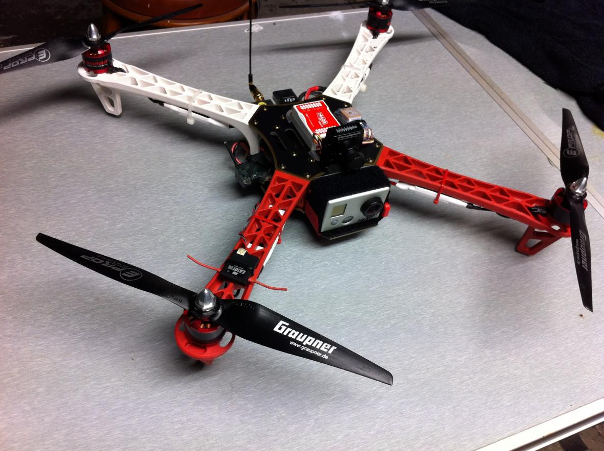

Yesterday I thought I'd see how my F450/gimbal setup worked in strong gusty winds. We have this condition in southern California right now called Santa Ana winds, where a high pressure system over Nevada sends winds in a southwestern direction towards LA, compressing, heating up and drying out the air as it goes up and then down the mountains. This pushes the temps, even at the beaches, up into the 80s, but it also means it is windy as all get out. Where I'm at, we easily get 25-30 mph gusts. In places closer to mountain passes, it can 2-3 times that.
Anyway, I had one heck of a time, trying to fly this little F450. Even at a not-so-svelte 4-1/2 lbs/2.1kg, it was being tossed around quite handily. I tried several times to get the gains dialed in, but frankly, it was just about impossible to tell whether I was getting oscillations or if it was just the severe gusts. The gimble did a surprisingly good job, but I was really having to yank it all over the place, just to keep it from taking off on me.
In any case, this test was of limited value, as I can't see ever trying to do a video shoot in these sorts of crazy winds. :)

Awesome fun just to free fly in strong wind though, the F450/Naza combo handles the wind way better than i thought it would, it feels almost impervious to it, apart from a bit of oscillation.

Yesterday the winds were less, but still a bit gusty. I decided to try the stock 10" props, but I'm really not too happy with them. I spent an hour making sure all four were perfectly balanced, but there's no way they are as smooth as the 11x5 Graupners. I'm guessing it has to do with the fact that the Graupners are a lot stiffer. The vibration isolators, on the mount, kept the vibes pretty much out of the video, but I can detect a slight lack of smoothness, at certain times, with the gusting.
The motors seem to run hotter with these props on as well. With the Graupners, the motors were warm, but not so bad that you couldn't leave your fingers on them. After this flight, it became too uncomfortable after 3-4 seconds. The ambient temp was 81F/27C. Next, I'm going to try my GWS 9x5x3 3-bladed props. On my other F450, these produce the smoothest performance. The Graupners won't work there, because it is a lot lighter setup, and the disc loading is too light for the 11x5s.
Eventually, when I get some Graupner 10x5s, I'll do some more comparison tests.

I just did another test flight , with the 9x5x3 props, and These are definitely the smoothest, so far. I took the time to really balance them and they are a ton quieter than the 10" stock props, and the motors were barely even warmer than ambient. I'm sticking with these, for sure. :)

Did another quick test yesterday, with the 9x5x3 GWS 3-bladed props. I balanced them first, and it is amazing how much quieter they are than either the 10" stock props, or the 11x5 Graupners. Also, the motors were barely above ambient (about 68F...). I guess maybe they like the faster rpm? I don't know what to think. I've never been a airplane guy, just helis, so this whole prop thing is fairly new to me. All I know is they seem to work best with this setup, with zero vibes.
The winds were pretty much down to our normal ocean breezes, which we have almost year-round, but there was a few big gusts, especially right at the end, where I just about lost it. The fact I even got it back down on the ground sort of impressed my 24-year old son, who normally has little faith in my flying abilities. :highly_amused:
Anyway, I'm sticking with these props, and I will also use them on my new DJI hex that I'm just finishing up.
