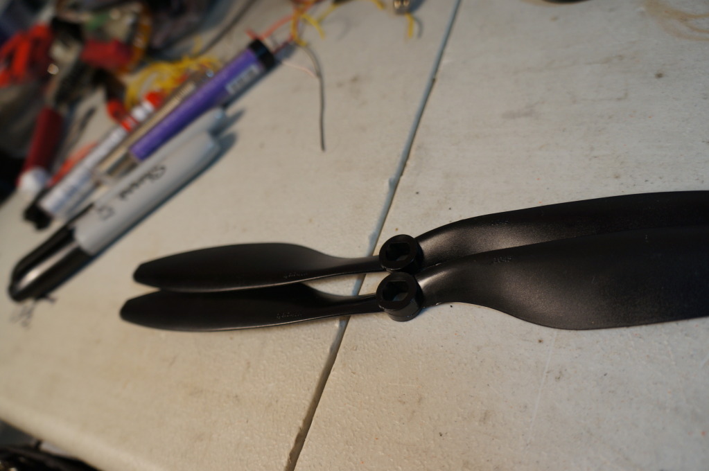

Can you post a picture of the two props that will show the difference between the old and new and improved prop from Xaircraft?
No Problem !!! Am not in the shop at the moment ... It is after hours will post some after while. Have a NEW video with 2215 motors and a GoPro Mount ... These are the NEW props ... GoPro Hero 1 ... Propellers are not yet balanced.
XAircraft NEW Propeller Series, Notice the texture of the propellers. One has texture to the center hub. The other seems to be smooth as it reaches the HUB. The NEW propeller, it's texture is constant and more plyable. It is a very obvious difference. Notice also the slight difference in the center HUB !!! NEW propeller is the upper propeller in the photo. I believe the reason for the breaking props was due to uneven temperatures in the mold setup. The center seems to have been heated to much casuing the plastic to be weakened thus the propellers had failures in flight due to material deficiency.
