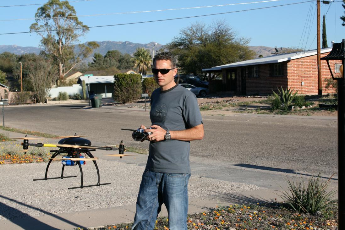

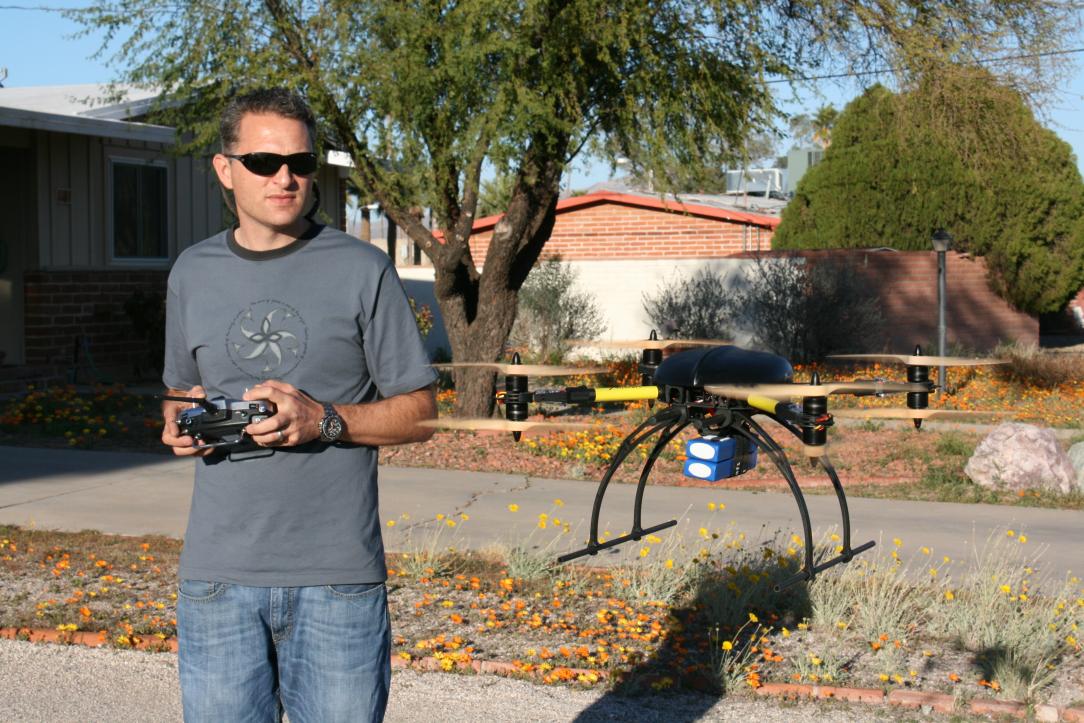

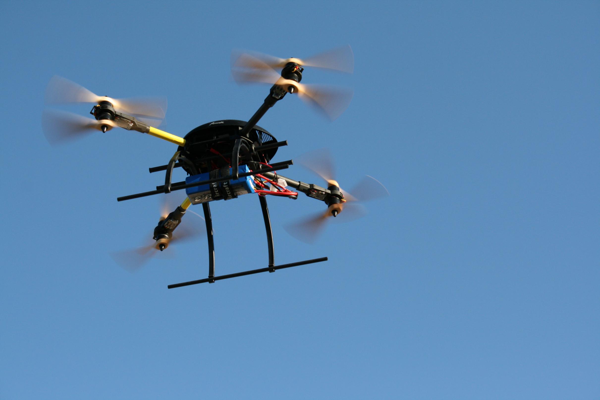

teryn1
Thanks for the info. well, I scrapped those junk stock rotors and put some zinger 10x6's on there. No more worries about blades exploding. Now waiting for the GPS...
Teryn
video: http://www.youtube.com/watch?v=I73XtNNmE3E

xvin
TeryN1: It looks like your wooden props are performing well. After two seperate xAir prop breaks, I installed Graupner E-props.
Nice flying btw... I thought you were going to fly it into the open door:tennis:
