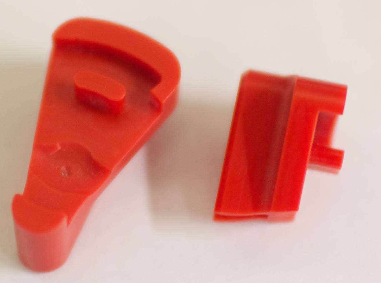

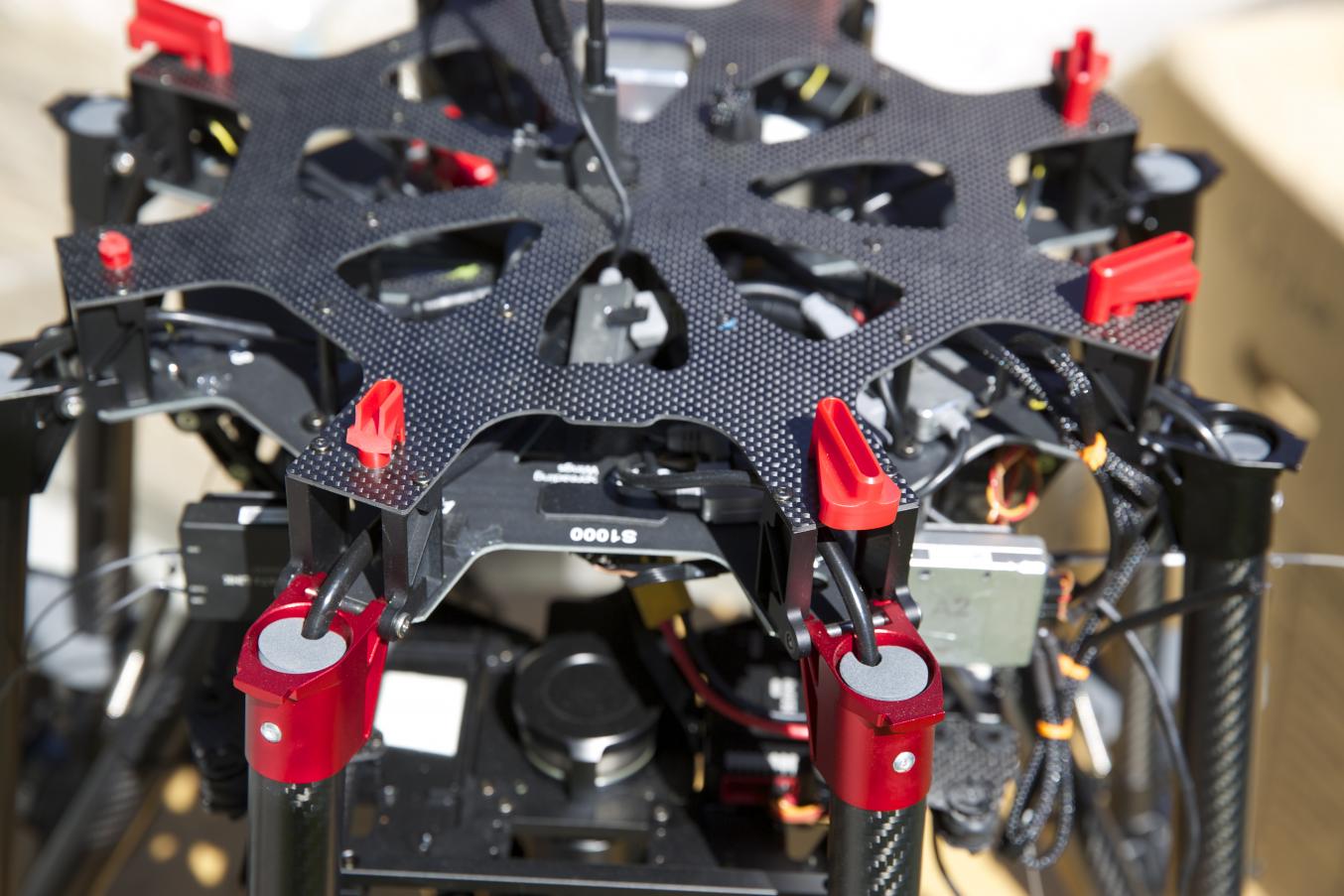

View attachment 17403View attachment 17404Dear DJI and Future Customers of the S-1000
Here is a warning. We recently purchased a DJI S-1000 with folding booms as a feature. The RED PLASTIC BOOM LOCKS are FAULTY. They snap. These parts are made from cheap styrene plastic. Not only to they snap in the air but they can snap on landing. We now have a 15K boat anchor. We have sent emails to DJI with no response. Being here in Los Angeles we took the next course of action. We went to the service center in which we were greeted with angst and shock and 100% lack lack of service. The rep looked like he just rolled out of bed and could not be bothered and told me they don't stock ANY PARTS and that I needed to send the entire S-1000 back to CHINA. Really? He asked who sent you , who gave you an RMA. We have a 2500.00 job this week that needs to be canceled because DJI sells faulty " Professional Gear" We have 40 yrs in RC and have never had such a poor experience. The rep was not even remotely willing to help. My next plan after this is to show up at NAB with rig in hand for everybody to see. Dealers , production companies , distributors and the list can go on. PLEASE see attached photos. BE ADVISED if these boom locks snap in flight you will end up with a catastrophic disaster and if you injure somebody lawsuits , loss of wages. DO NOT buy this product until there are parts readily available. Yes there are 4 spares in the box because I am sure DJI is aware of the problem. They are all broken and NO there were no crashes resulting in broken parts

View attachment 21492View attachment 21493Dear DJI and Future Customers of the S-1000
I gave a guy from New Zealand two to replace a broken one on his S1000. The replacement parts have not yet arrived in LA. I don't know when they will. I have been in their parts room and there are plenty of parts for the S800 EVO. There will be the same for the S1000 as well. It will take time to build that inventory. I will speak to the LA Operations Manager tomorrow to make him aware of the problem.
