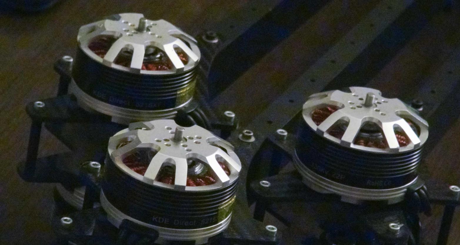

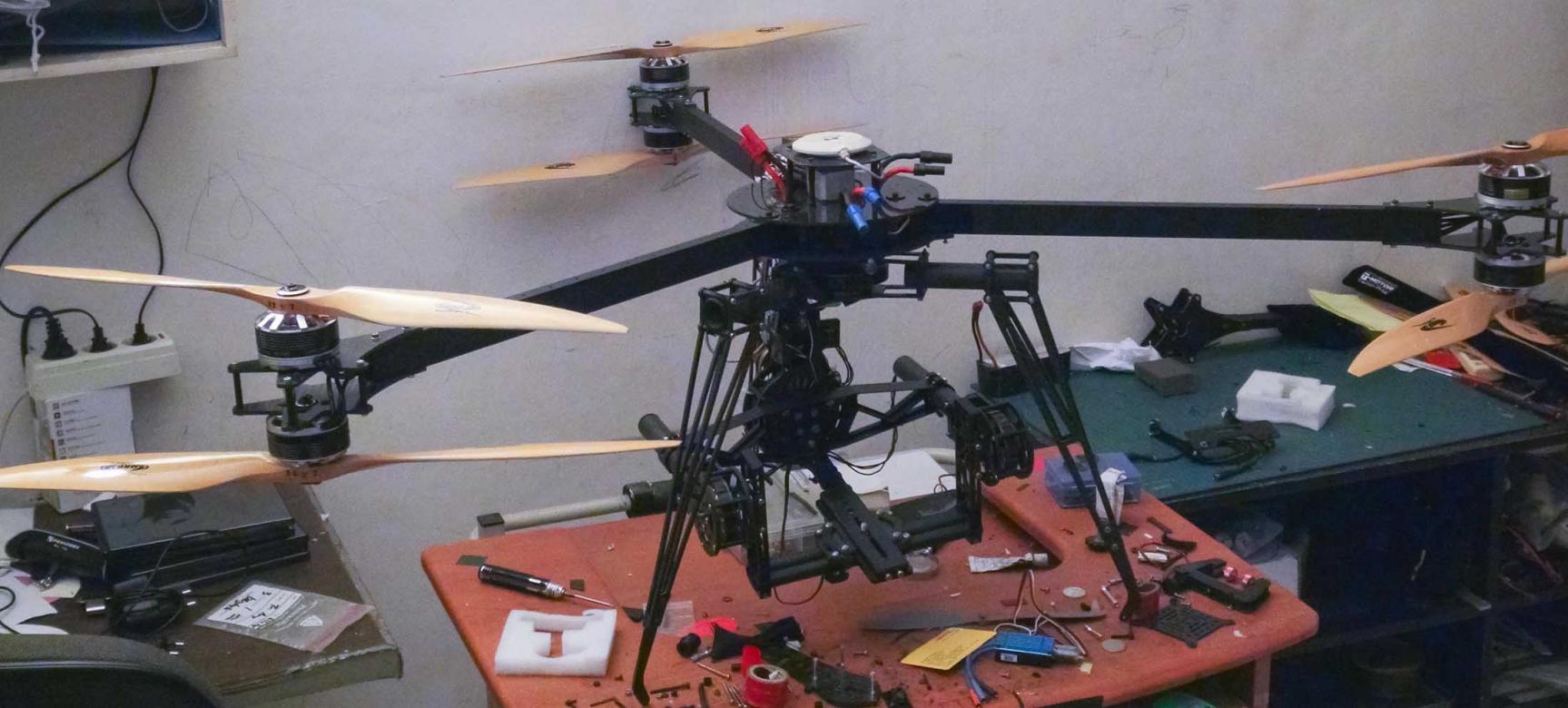

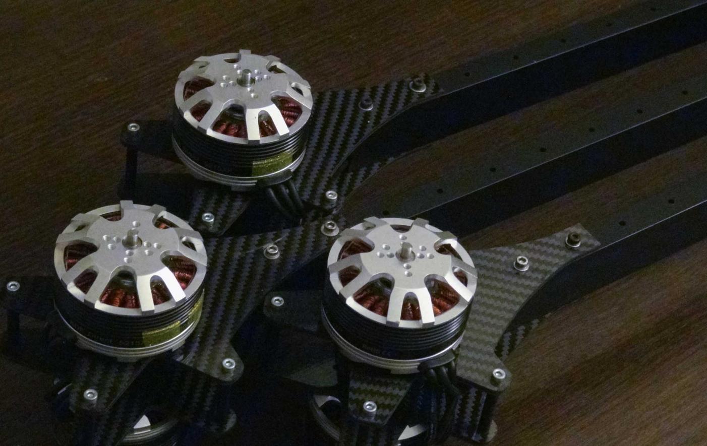

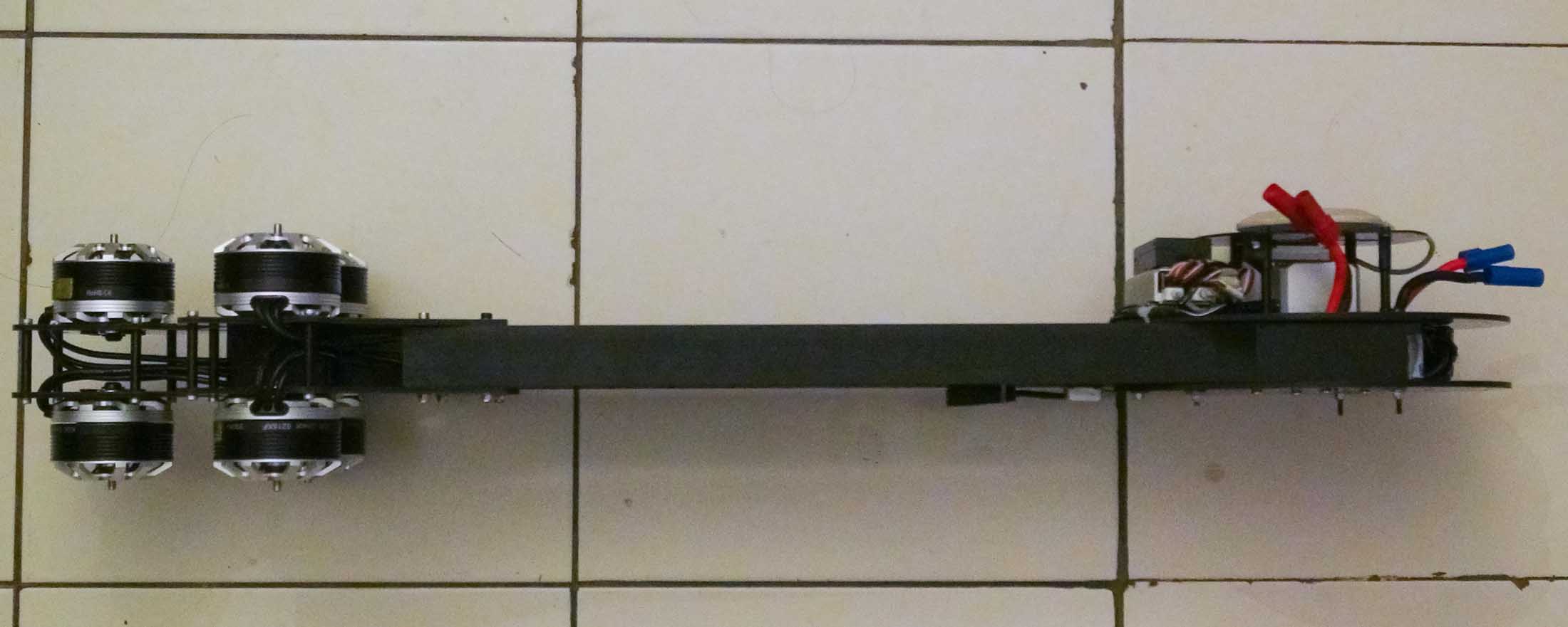

I just received my DJI S1000 Premium. I thought I would share some photos of the build process. As you would expect and you should, the build quality is second to none. This is a complete new octo from the ground up. The S1000 V type design provides large amounts of thrust while improving power efficiency. I'm really excited to see the use of cf arms versus the plastic arms of the past. The most exciting part of this frame in my opinion is the folding capabilities. It makes transportation and storage a breeze for such a large frame. The locking system only takes a few seconds to fold or unfold, such a outstanding design. The S1000 comes about 80% complete, so the build process is very straight forward and FAST.
