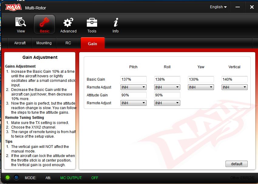

VINHEX
Dji have release 5.22 notes are only showing on 5.20 at the moment..
http://www.dji-innovations.com/products/wookong-m/downloads/
Firmware
Added the Bluetooth function. Required LED-BT-I hardware support.
Software
New UI design, simple and easy to use..
Bluetooth firmware support upgrade online..
Support iOS Mobile device assistant, download on the App Store
Manual
New quick start guide.
VINHEX
