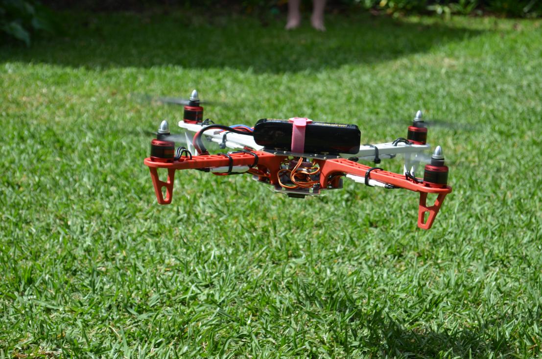

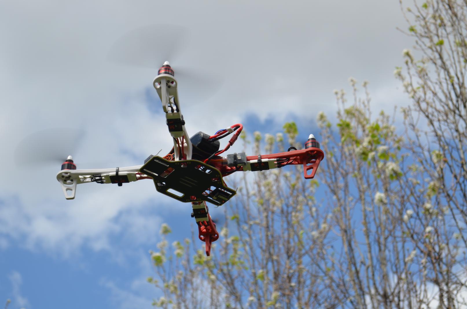

So after receiving my quadcopter back from the hobby store these were the changes they made
"This is what action was taken to repair your quad copter.
We re-bound the radio to blank mode, recalibrated the IMU and set the radio
end points.
The ESC wires were ran incorrectly, we set these up again and also re set
the motor. We set up the 2 position mode switch and then the quad copter was
test flown.
We then transferred the complete set up to your radio and test flew it again
to be sure" - So really it was mostly my fault, but hey, now I've learnt which was is always a positive!
View attachment 13740View attachment 13741View attachment 13742
