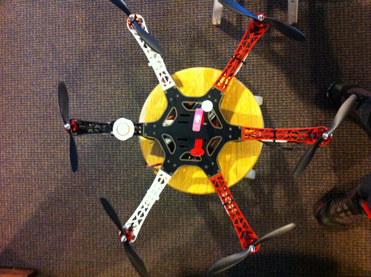

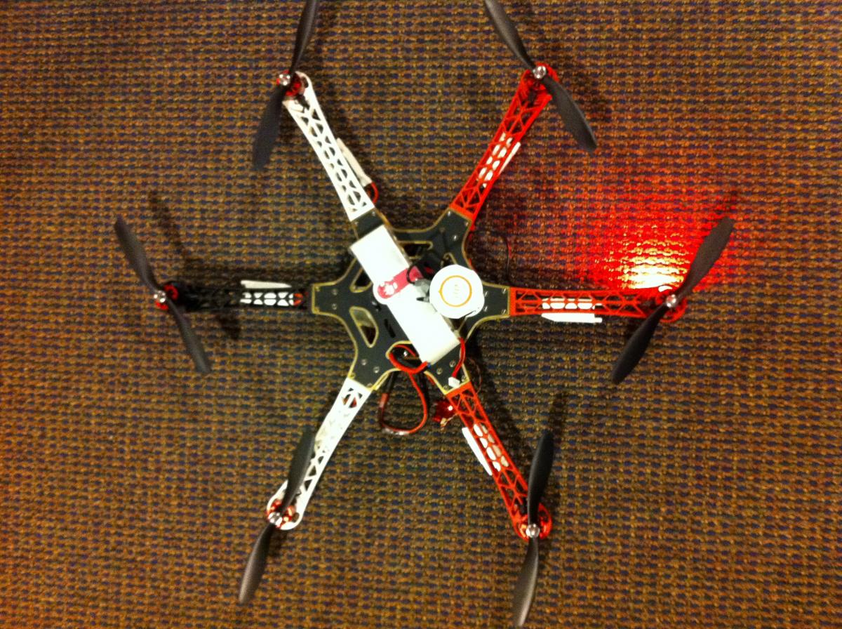

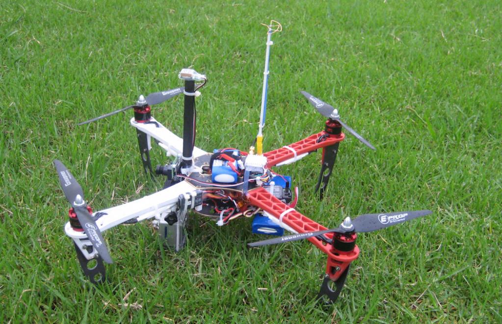

Well it went together so fast and I wanted to fly tonight I just did a quick install.
I elected to go with the 8" props and a 4s 5000mah setup. Total weight is 3lbs 8oz.
Flew it in the house real quick in Atti mode on the WKM and its rock solid.
This will make for a great small camera platform.
Charging pack and might head out in the dark for a outside flight.
Will get better pics and video this week.
Proof will be how well it does in GPS with some wind.

Alright I couldn't wait last night so I went out to fly in the street.
Like I have mentioned I did a quick install and left all the wires just hanging. I'll clean it up today. For some reason I have this thing where if I do a clean install from the beginning I end having to redo it. LOL!!
I took one of the battery powered round lights that you push to turn on and Velcro it to the Lipo. :highly_amused:
It was a balmy 15F outside last night.
It found GPS in less then 30 seconds.
Here is a quick iPhone video I shot and my hands were freezing. It was dead calm, zero wind at all.
I'll adjust the gains and clean it up this morning.
Need my coffee.
http://youtu.be/v-lktp5nC7c

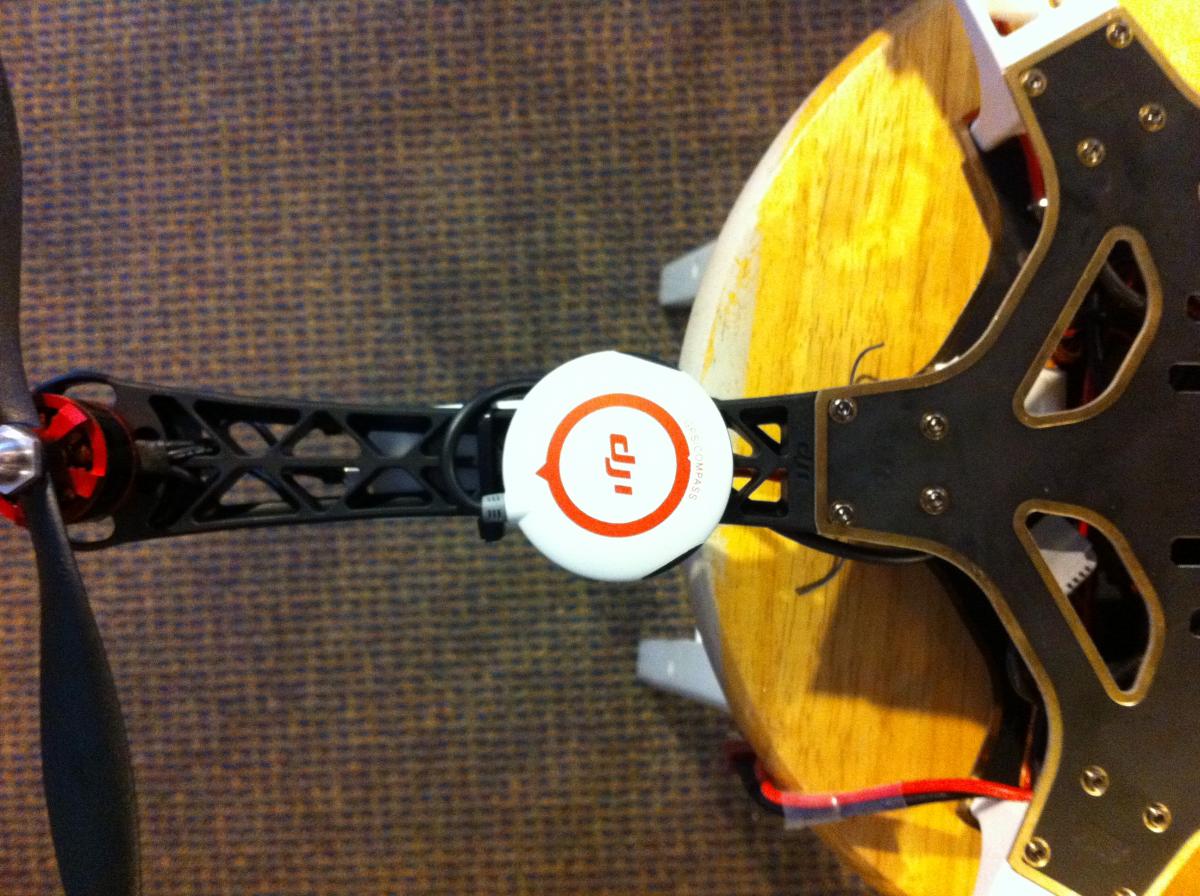

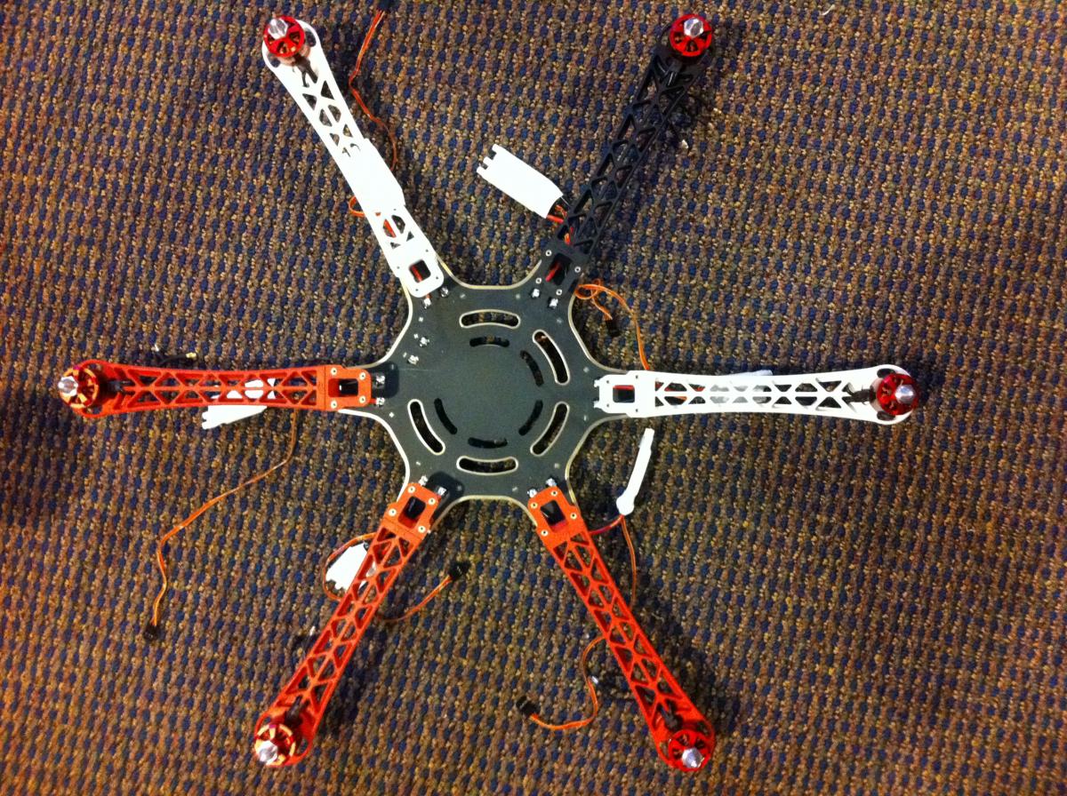

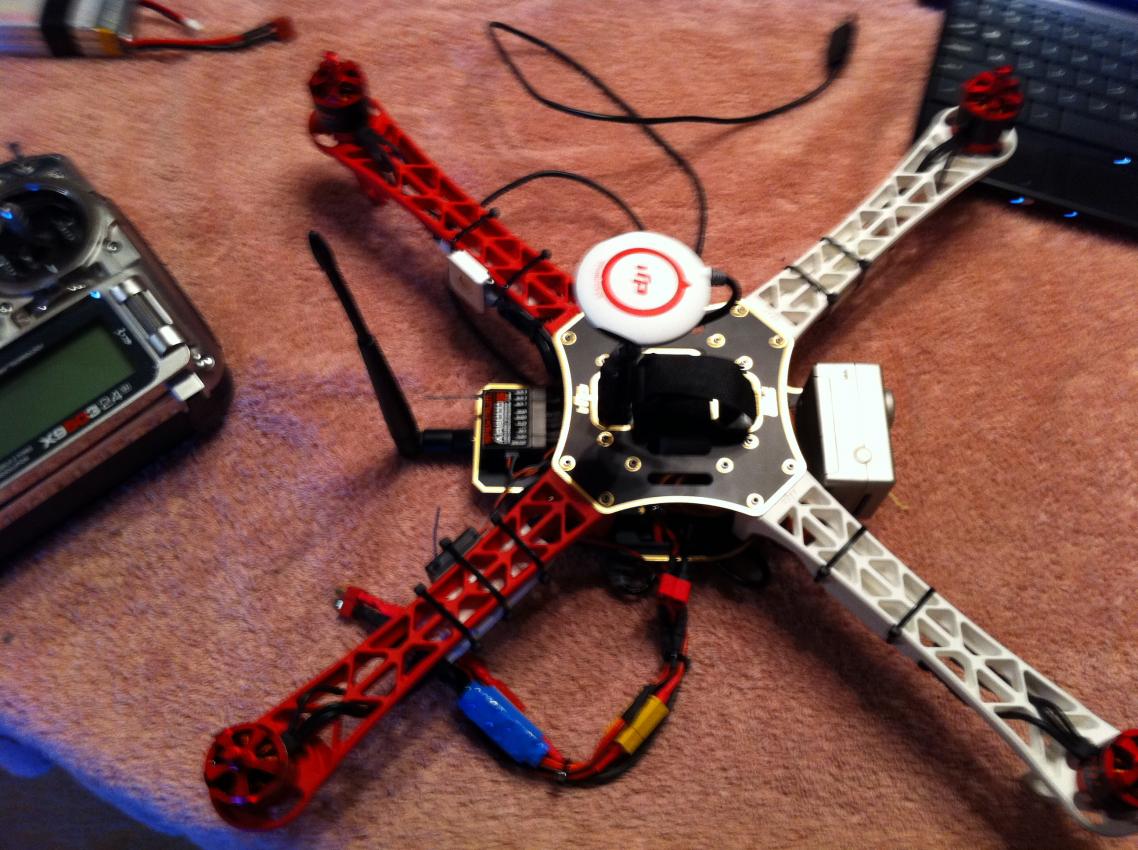

Cleaned up the wiring. Worked on the CG.
I also thought I would try the GPS on one of the arms. It makes for a cleaner install. GPS lock is very fast. Well under 30seconds. I was figuring being so close to the esc (right on top of it) and close the magnets of the motors it would be horrible.
Weight without Lipo is 2lbs 8oz.
