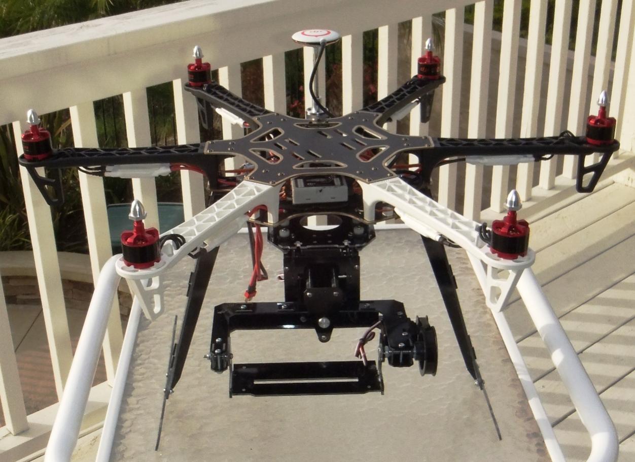

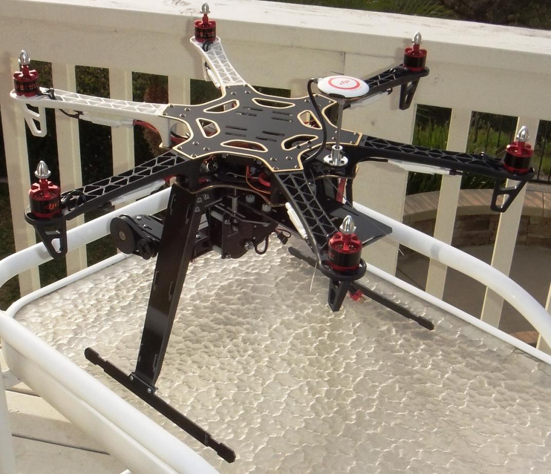

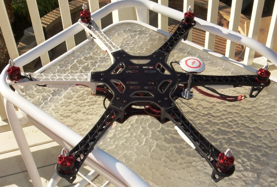

I finally got my DJI F550 hex together, and installed the WK-M on it, which came off my XA hexa setup. All I need to do is throw on some props, and it'll be ready for a test flight.

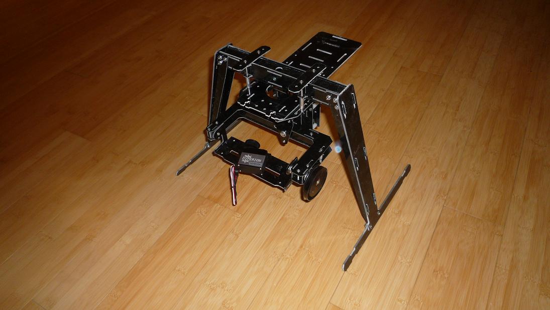

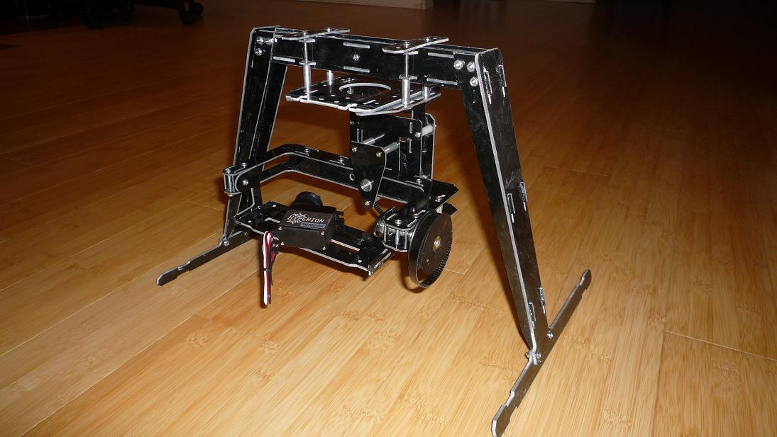

Andrey shipped me the first landing gear/NEX gimbal assembly today. If the planets align, I might get this by Saturday, which means I might have it flying by Sunday. :)
-- Gary

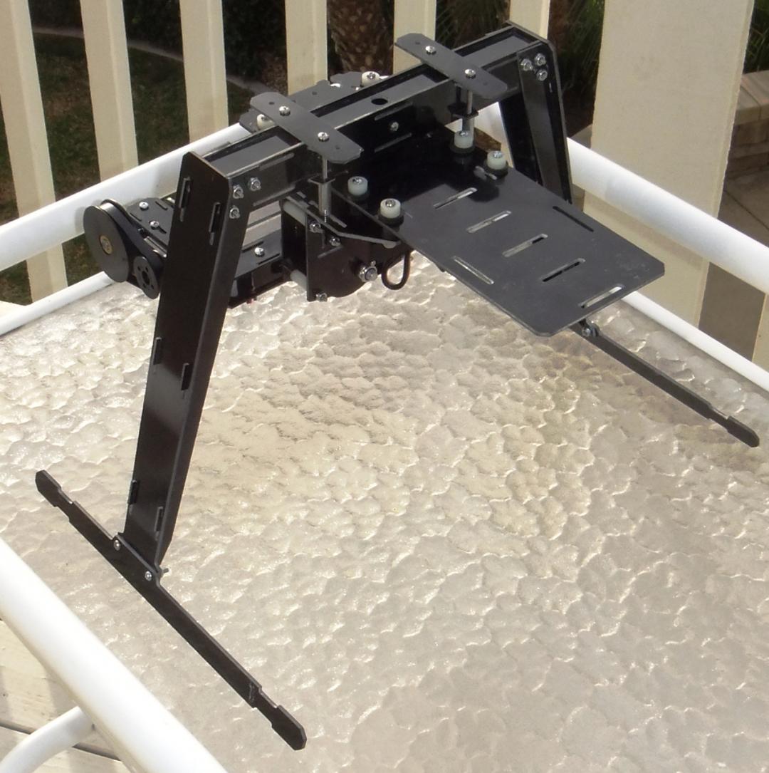

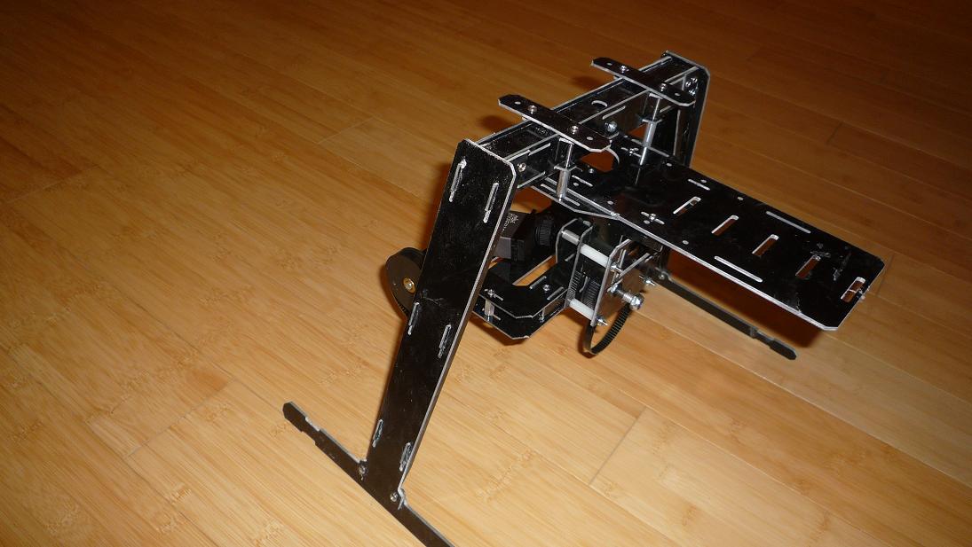

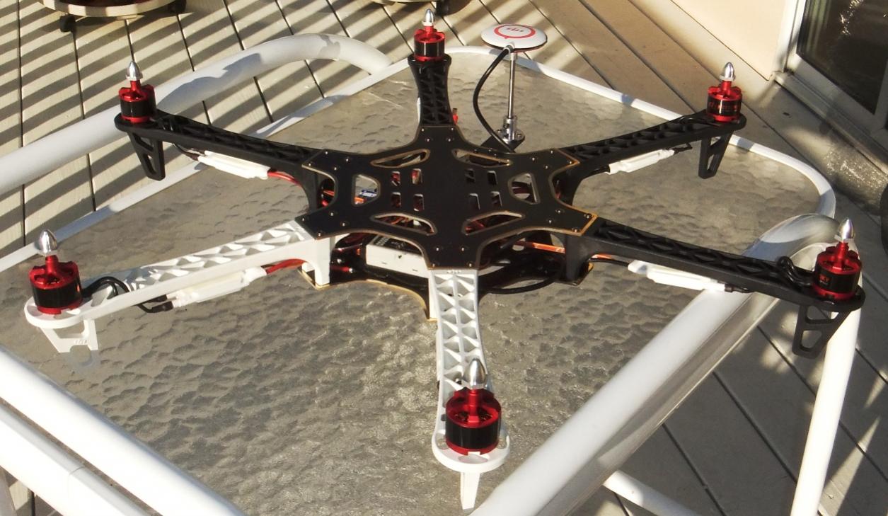

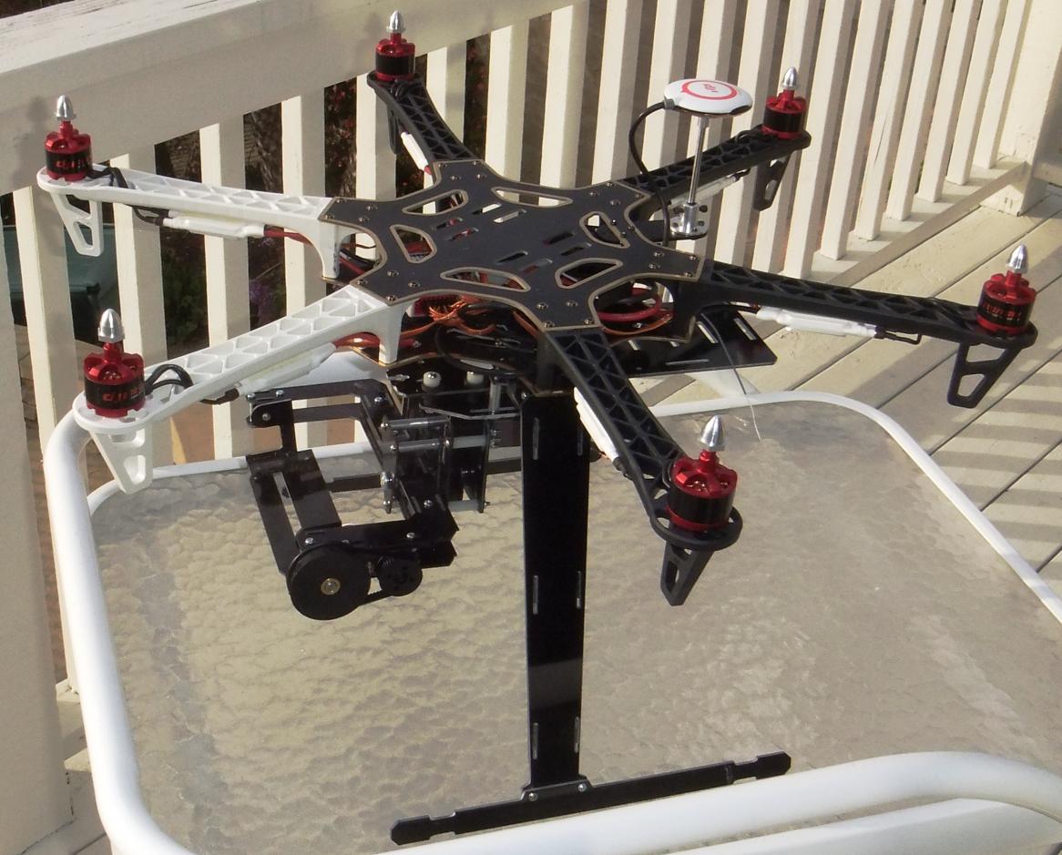

GGoodrum

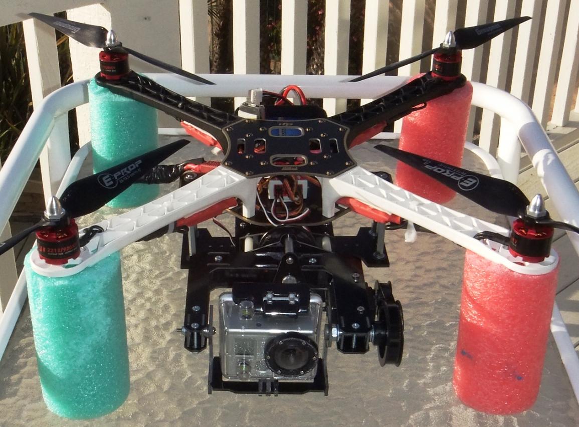

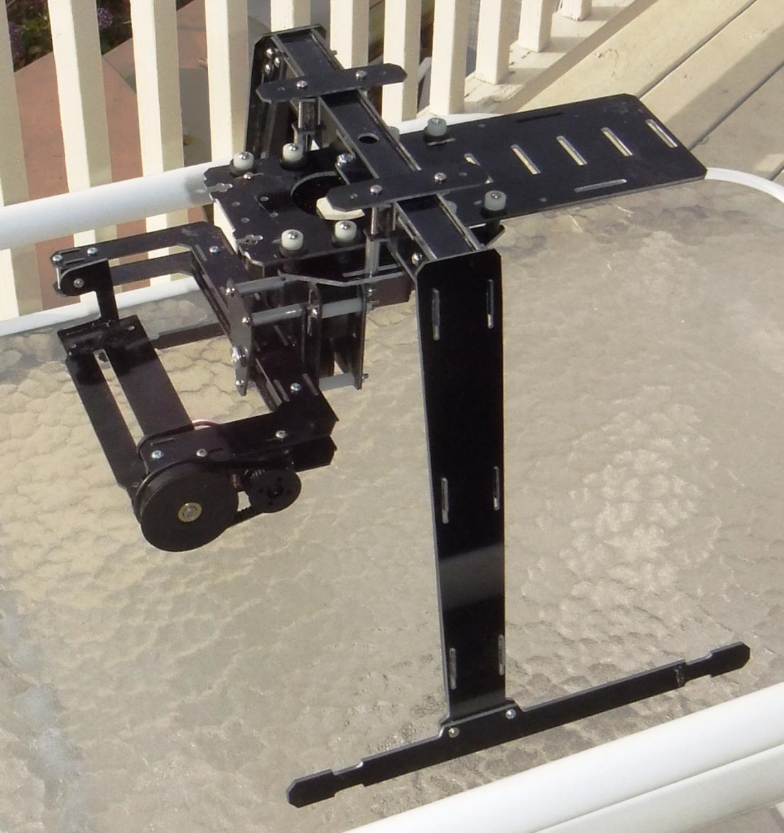

Got the gimbal/LG/battery plate assembly together, and installed underneath the F550 hex frame. I think this is going to be my favorite setup, as everything is very robust. :)
I still need to do a few things, like program the servos, add some pool noodles to the skids, put on props, and then start tuning everything. Hopefully, the first flight will be tomorrow.
-- Gary
