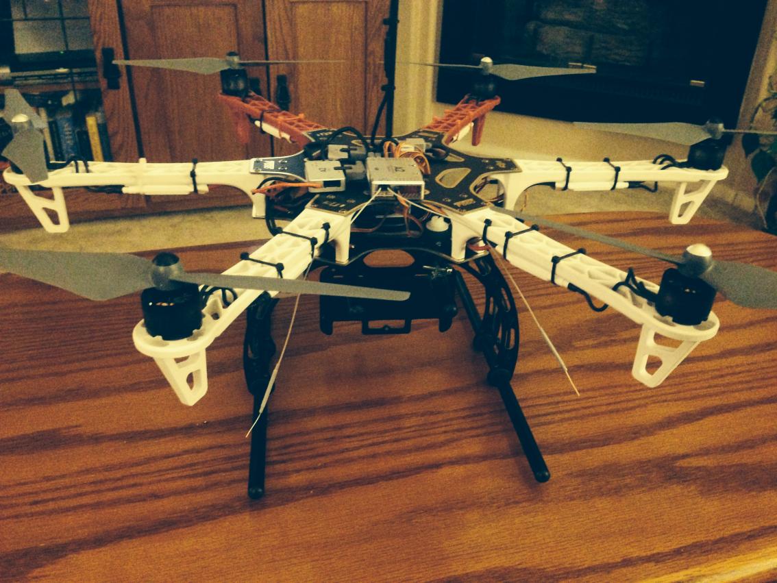

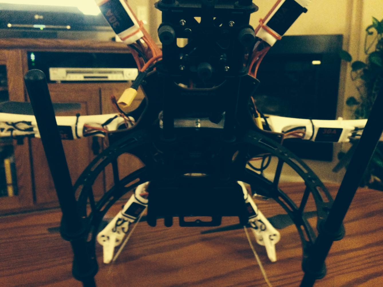

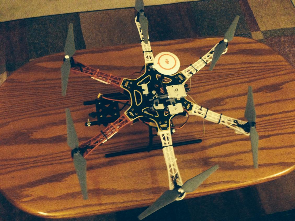

Tahoe Ed
View attachment 15425View attachment 15426View attachment 15427
I just finished moving my A2 from my S800 to my F550 for further testing. I have it set up for a H3-2D with GoPro, iOSD MK II and video downlink. I mounted the E300 motors and props. I have not swapped out the esc's yet. That will be another time once I have everything sorted out. I am hoping that the new firmware works well. I will be able to fly a little this weekend.
