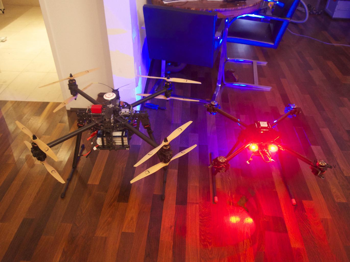

Taking up the A2 on my x8 the first time on sunday and my AQ x8, keep you fingers crossed that they come back in the same state :)
