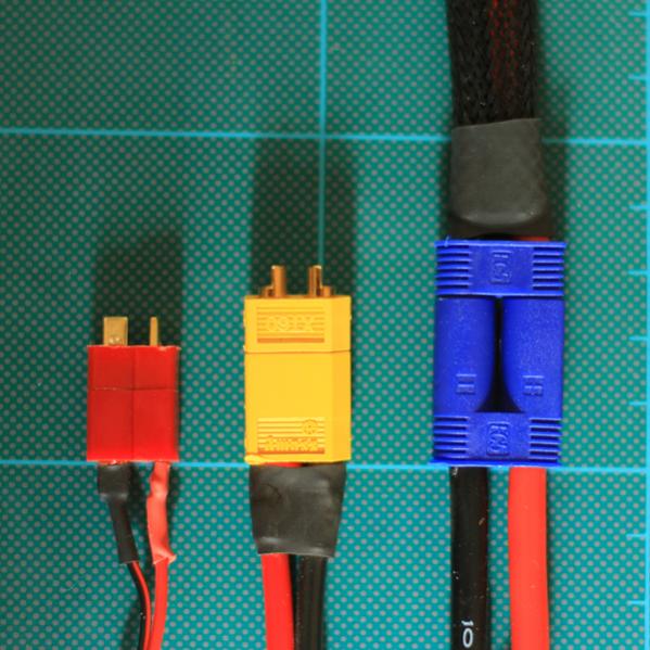

On the EC5 bullet connectors there is also a small holde on the side. Most of the time when soldering the wire onto the connector this is where the solder spills out. I now always make sure when the bullet connector is inbetween the wood panels the hole is blocked by the wood so the solder does not spill out. This reduces a lot less greif trying to remove excess solder on the outside of the connector.
My first try I also managed to fit to the wrong bullet connector in the wrong housing. I did wonder why it seemed so tight lol. So the last lesson is to make sure you are fitting the right housing on the right bullet connectors!
If you tilt the bullet 45 degrees and put the tip of the iron in the hole and feed the solder through the top next to the wire that works well too.

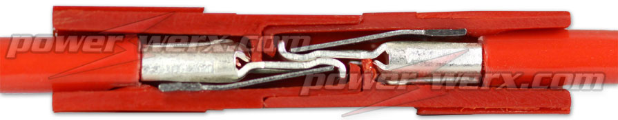

Of course, like Jes said, with A.P.P. it's simply "crimp, crimp, snap, snap" and you're done.
No "male/female" issue either. That's actually what pushed me over the edge, I copped a space and soldered on about 8 sets of ESC bullets backwards (female vs male), the next day I ordered a bunch of APP and haven't looked back.
The housings are easy to remove and re-use as well. I'm a big fan.
Anyone want to buy a big bag of used EC3's and bullets? :)
Today and yesterday I replaced all my power cables with 10 AWG wiring this also meant that I had to solder it onto my MK PDB. This was not hard to do although I have never liked the fact that the positive and negative pads are so close. A stray wire to could lead to trouble so double check to the connectors with a multimeter after.
Yesterday was a lot of greif with the EC5 connectors although now that I have learnt a couple of things I can avoid problems in the future.
As jes1111 mentioned dont get solder on the outside of the bullet connector otherwise the connector wont fit into the plug. If you managed to get a lot of solder on the outside you may be able to remove the solder but sometimes its easier just to use another connector and try again. Any small bits of solder I got on the outside I removed with desoldering braid and fine grit sandpaper.
If the wiring is short dont snap on the plastic housing until all soldering is done! One of my plugs housing melted. I didnt realise they have a pretty low melting point.
When soldering on the bullet connector I get a vice, 2 small sheets of wood and place them in between the vice. I then place the bullet connector between the two bits of wood and tighten the vice. This alllow the bullet connector to heat up properly so the heat does not transfer onto the metal vice.

i was watching this video
http://www.youtube.com/watch?v=y8ODI8fAU_k
trying desperately not to fall asleep but noticed that the contact tabs aren't very robust. how do they hold up to the sparking that goes on each time power is connected? the video is a lower AMP version of the connector, maybe someone could post a pic of the higher amps ones being used for multi's.
