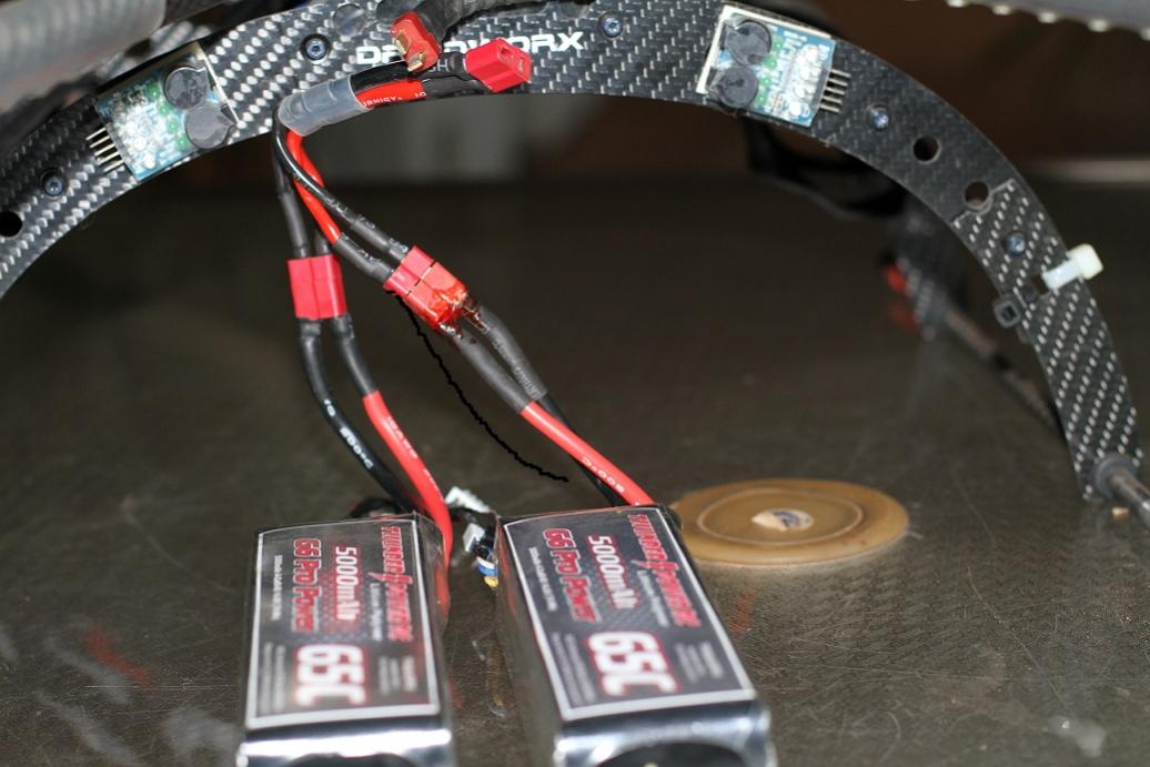

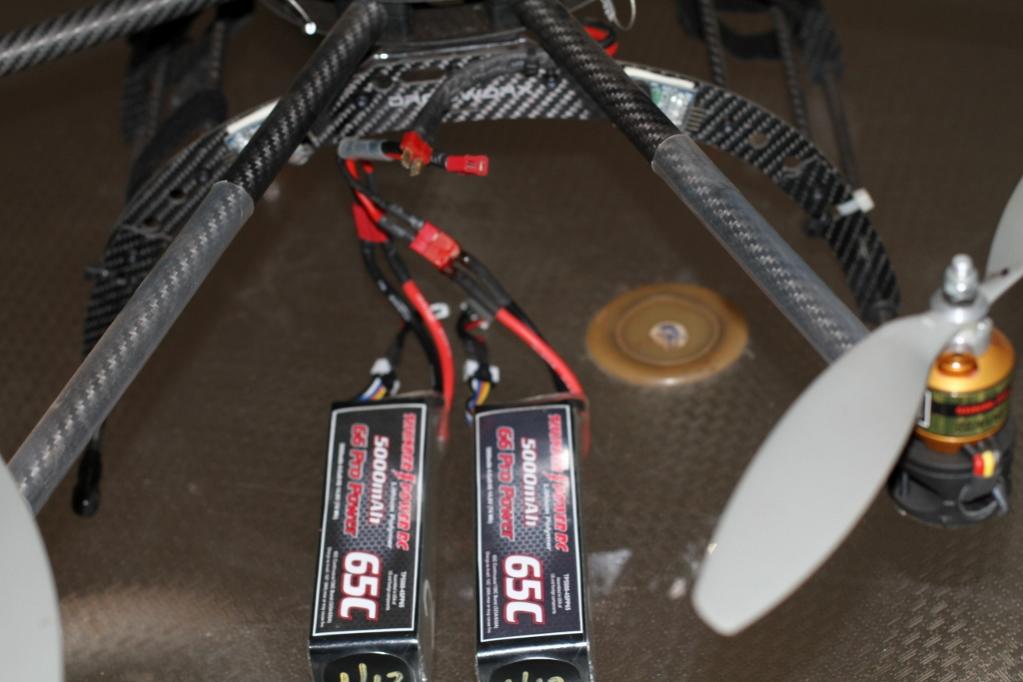

A couple of Pics to show the setup. Batterys used have been the Nano Tecs 4500 and 5000mah and the Thunder Power 5000's.
The prob is that 1 battery gets drained, this has happened at least 50% of the time - didnt matter which battery set I have used either, the TP's or the NanoTecs.
Have replaced the parallel leads, and the battery deans connectors.
Some of the original Nano Tecs had the HK Deans copies, replaced them - didnt make any difference.
Got the HK voltage screamer on there attached to the balance leads - that works well so I have been getting a warning when alls not right.
Motors are the AXI 2814/22 and Chalagi the wire size I guess are about 12g. Thanks for looking...

Some more questions:
(1) I have to ask - what's the shiny deposit around one of the battery connectors in the photographs? Is it something you applied or did that leach out of the connector/wire?
(2) I'm guessing this rig pulls around 150A at full throttle - so that's certainly exceeding the maximum rating of a Deans connector. After a flight have you checked temperatures with your fingers? Is one of the battery connections hotter than the other, particularly when this uneven drain occurs? Are the wires hot anywhere?
(3) You are using a Y-piece parallel adapter, feeding into a single cable. Where does that cable go to? i.e. does it go to a Power Distribution Board from which the ESCs are fed or does it split out from a soldered junction to go to each ESC? If it's a PDB then brand/details and a photo will help.
(4) Wire gauge - I can see the markings on the battery cables (10AWG) and the final piece of the Y-piece (10AWG) but the two branches of the Y-piece look like they might be thinner (12AWG?). Please confirm. Also please confirm the gauge of the wire from the single master connector onwards.
In the meantime I'm pulling together the list of part numbers for the relevant parts - you're right: it's not easy with so many choices :)
I'm asking these questions because with that kind of amperage I think we need to alter your wiring scheme a bit rather than just replace the connectors.

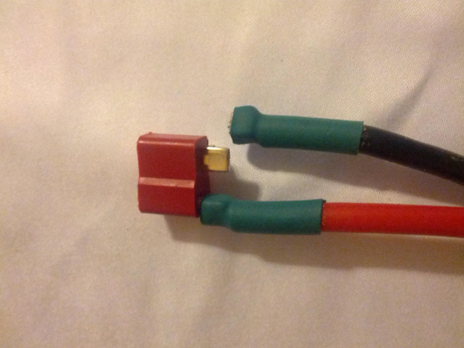

Last night I had a great 7 minute flight with duel batteries. After a recharge I noticed that one of the deans solder had come lose. I used silver solder but maybe I should have used a different solder for the deans plug? Or over maybe I should also change to another type all together. If I would have not ran duel batteries that may have been a bad flight.
But now I don't think I trust these deans (or my soldering)
[EDIT: Looking at this again, its my first battery, this was soldered by the hobby shop not me :)
and they don't use silver solder]
Can't see from this angle - did the solder separate completely from the contact area, or is there some solder left on the contact area? i.e. did the solder itself break or did the solder lose its grip on the surface completely. If the solder broke, then I'd blame vibration. If the solder came away cleanly from the surface, then it's your soldering ;) - before soldering you must clean the contact area with fine abrasive paper or a fibreglass brush, then isopropyl alcohol. If the wire you are using has been sitting for any length of time, remove and discard the first few inches so the ends of the strands you are going to solder are not already oxidised. In addition to using flux-cored solder, you can also apply (compatible) liquid or paste flux to the wire and the contact area before the soldering operation. After soldering, flux residue should be removed with a proprietary flux cleaning solution.
This is one of the reasons I don't advocate soldered connectors - good, reliable soldering is actually much more involved (and tricky) than it might seem. :)
I don't know whether different solder compositions would make any difference here. The modern lead-free solders tend to be used for ecological reasons, not performance per se. Lead-free solder is a b**ch to get right, though - I wouldn't recommend using it unless you are a ninja with the soldering iron :)

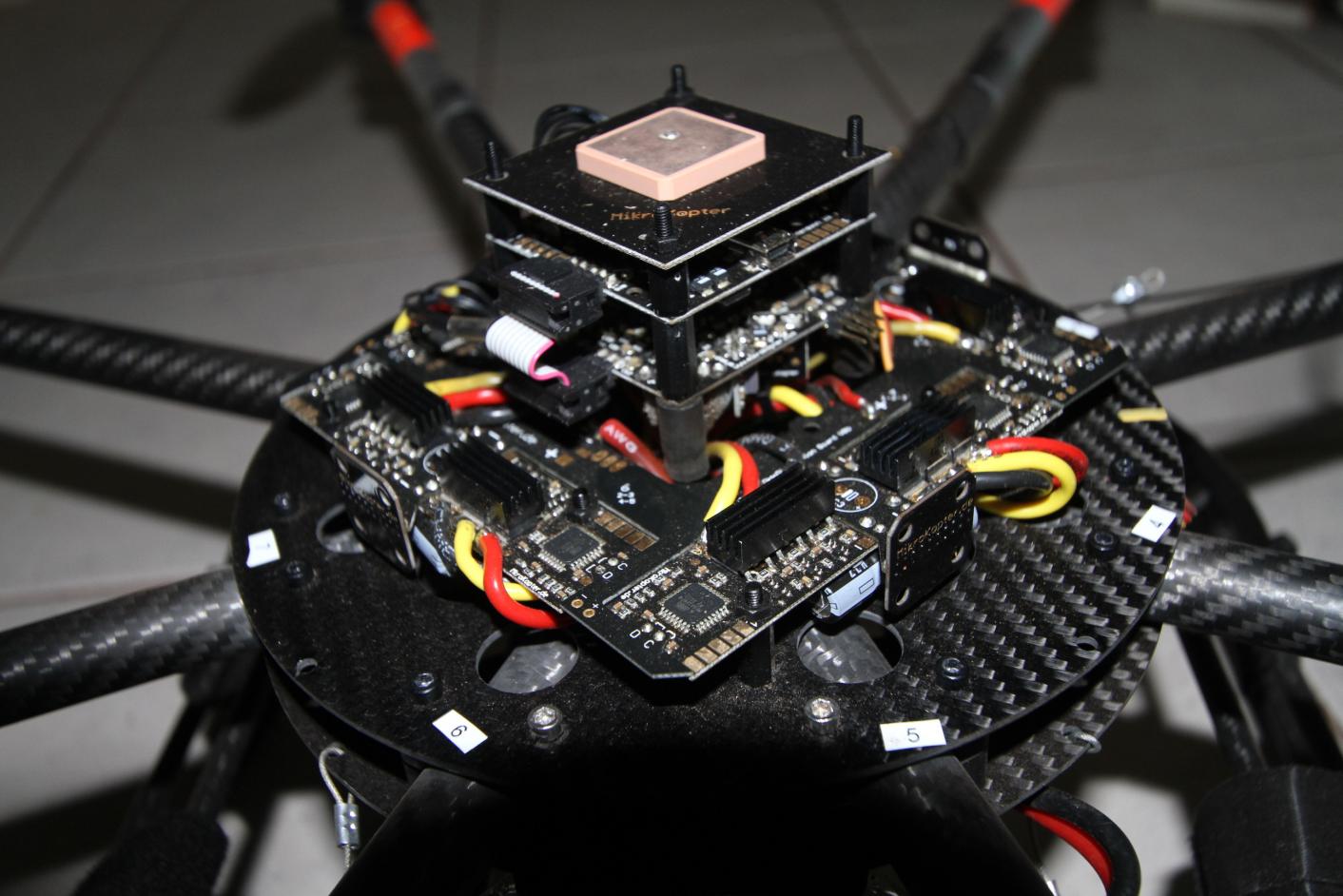

Thanks jess1111,
Here is some info and more Pics -
re Q1: It is just "Liquid electrical tape" the shrink wrap wasnt quite in position.
re Q2: Havent noticed any hot wires anywhere, that includes the Deans connectors.
re Q3: "You are using a Y-piece parallel adapter, feeding into a single cable" - Yes correct,
Where does that cable go to" - only guessing here as it vanishes into the guts of it, would assume it runs to a PDB also its a 12awg wire and its all Mk equipped.
re Q4: The 2 branches of the Y lead are probably 14awg (definitely not 12awg) no markings on the wire and yes 10awg feeding them with 12awg going into the PDB (?) and 10awg leads on the batteries.
In the first Pic you can see the main feed + red wire under the ribbon. That is not the original Y lead, I have swapped / replaced it several times - same prob.
