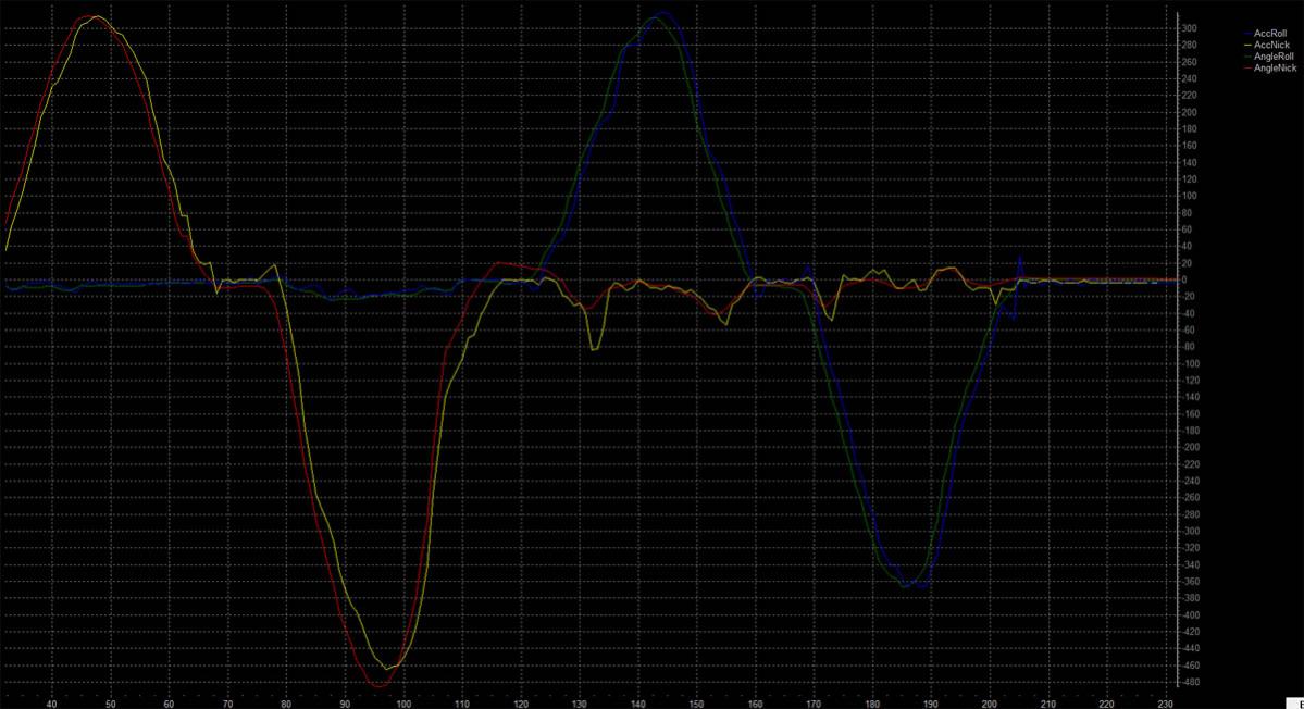

Here is the telemetry screen of MX20
And here is the log of trying to lift up

With those numbers just moving slightly I'd say its normal. You would know if the gyro was playing up because those values would be going all over the place. For me at the start it gradually increased/dcreased in value until the value was something stupid like 300 or 3000. Can you press START on the scope and then tilt the multicopter forward, back, left then right. Only turn on the scope parameters AccRoll, AccNick, AngleRoll, AngleNick so its easy to see, something might show up when you do that.
Malcr001
looks normal to me :hopelessness:
That looks normal, although your angleNick is a little jumpy but shouldent be enough to cause the problems your having.
Overall it doesnt look like the gyro is the problem. Thats a good thing! But I guess it still leaves you in the dark.
I next suggest you hookup up your MK and click on the 3D button. Be careful, I cant remember if it works without initialising the throttle so take the blades off. Basically the model should tilt in the direction when you give some input to your rc tx. The point of this task is to make sure the controls are all working correctly.
