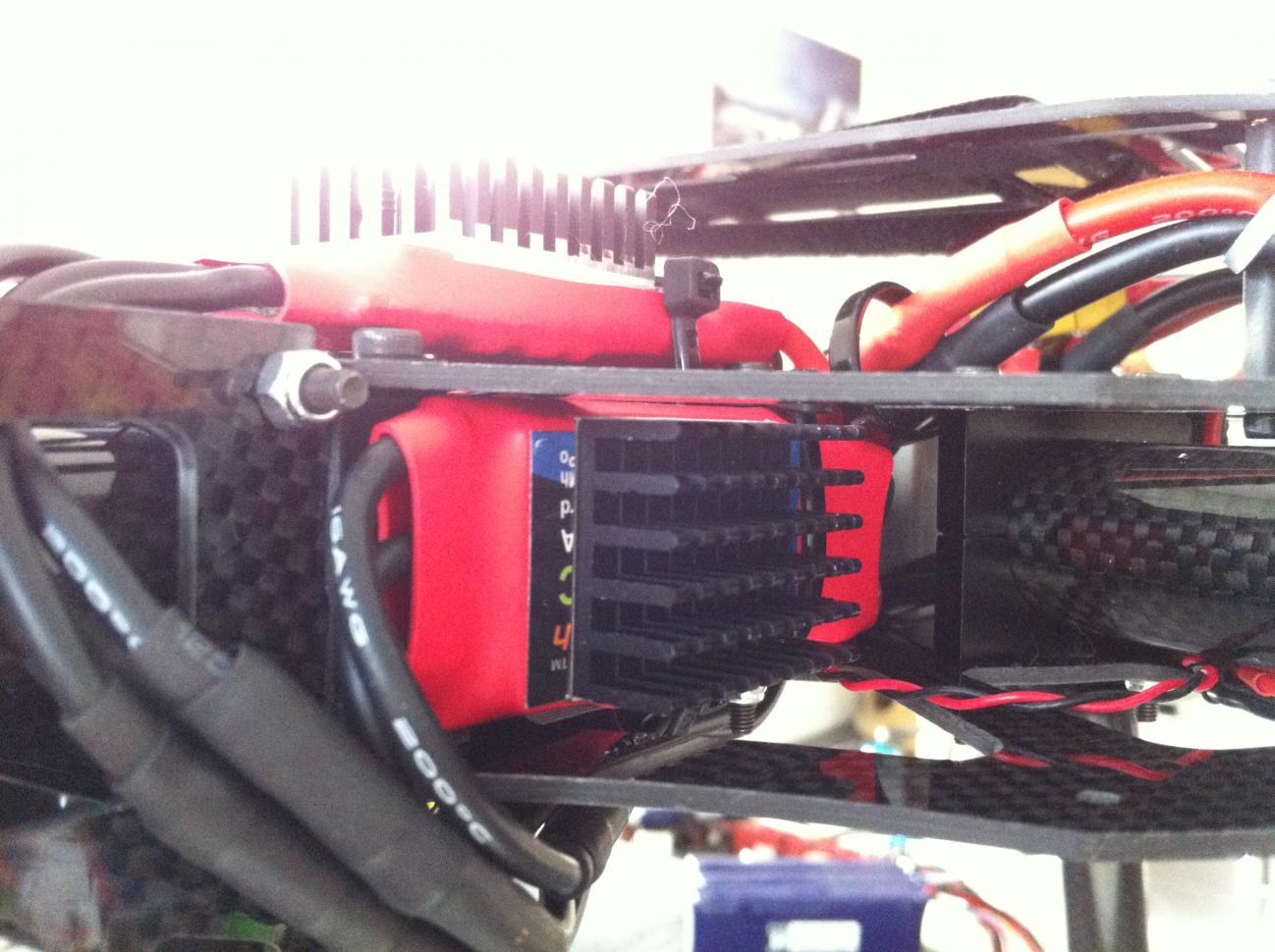

I've been very satisfied to YS-X6 after WKM in my CineStar. Actually i just sold my WKM as i haven't used it since i got YS. YS fits to Cinestar frame reasonably well without bigger mods. I know it could be neater install but it's just working well and makes it easy to maintenance.
