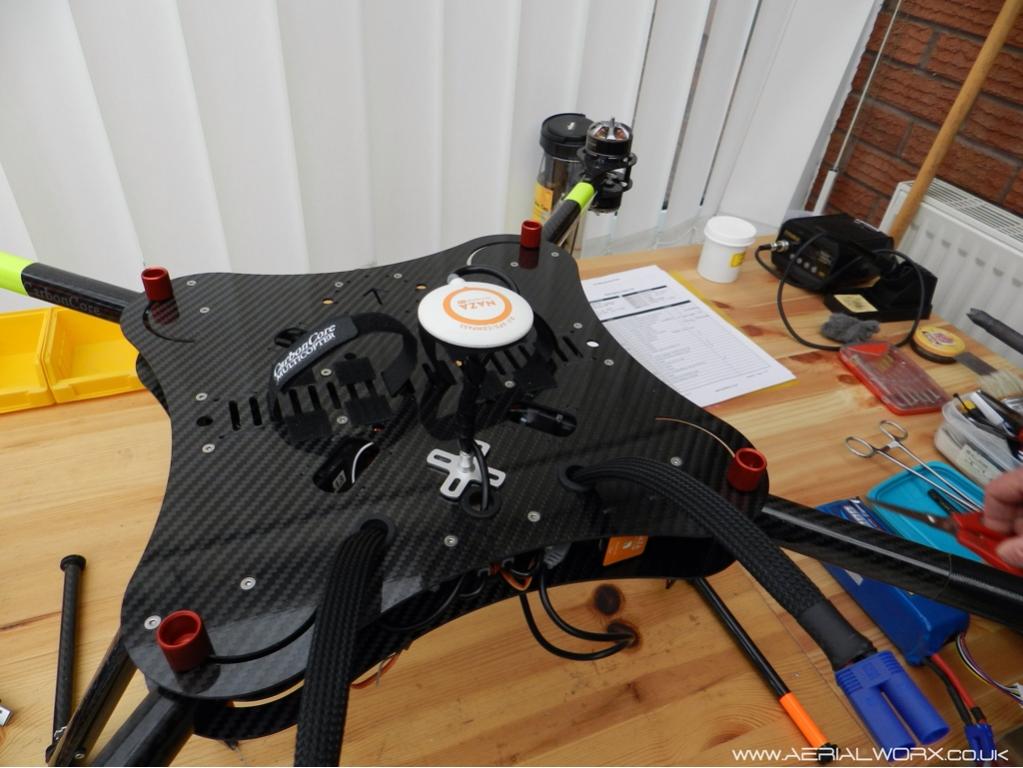

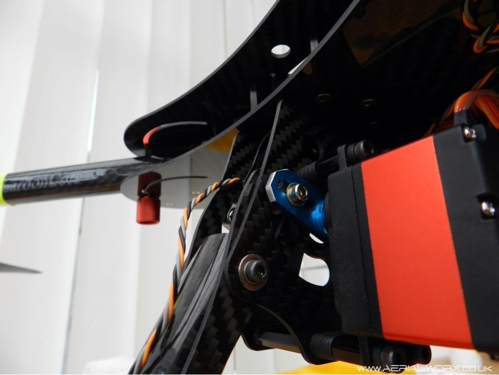

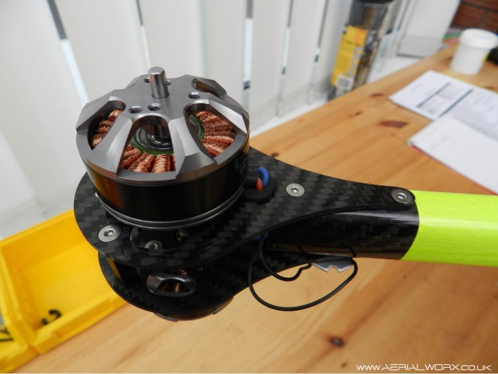

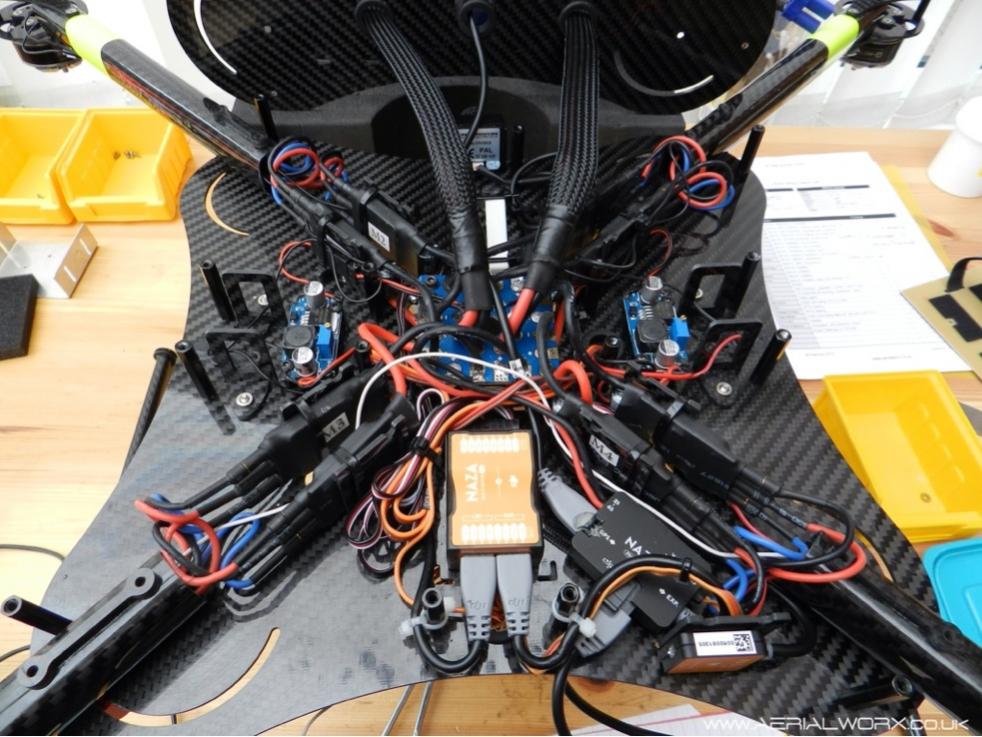

Quinton
OMG she is doomed :)

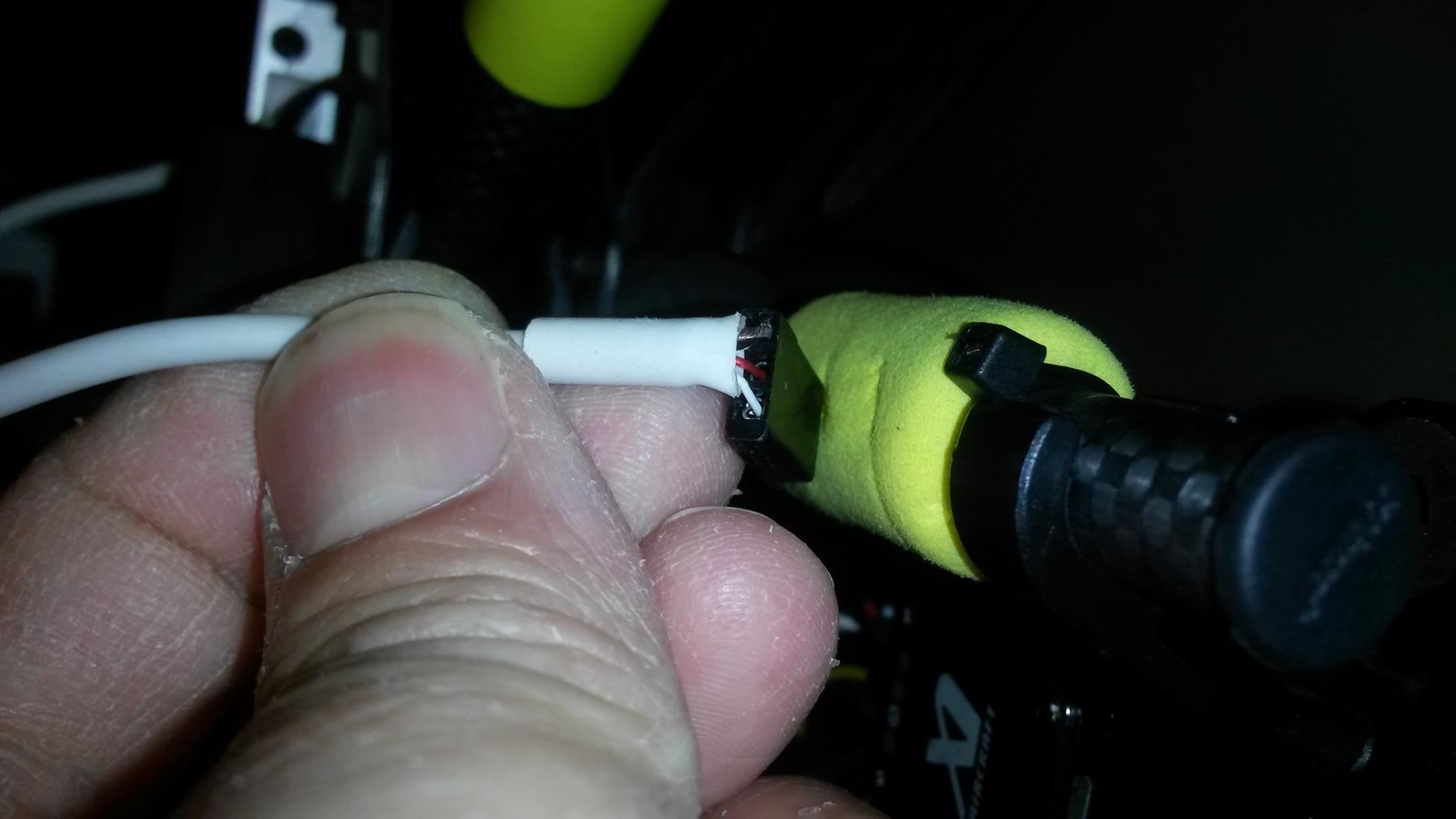

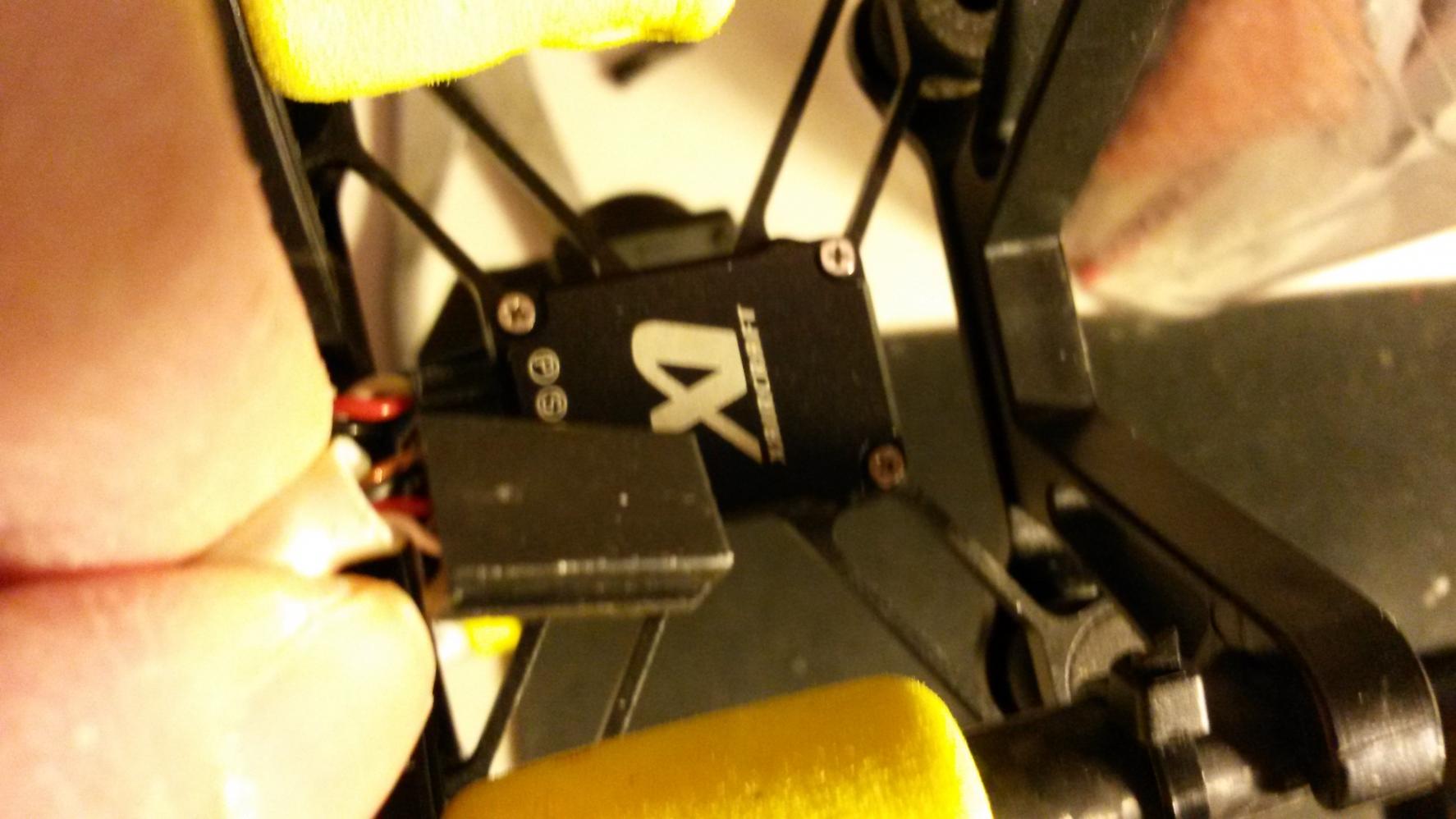

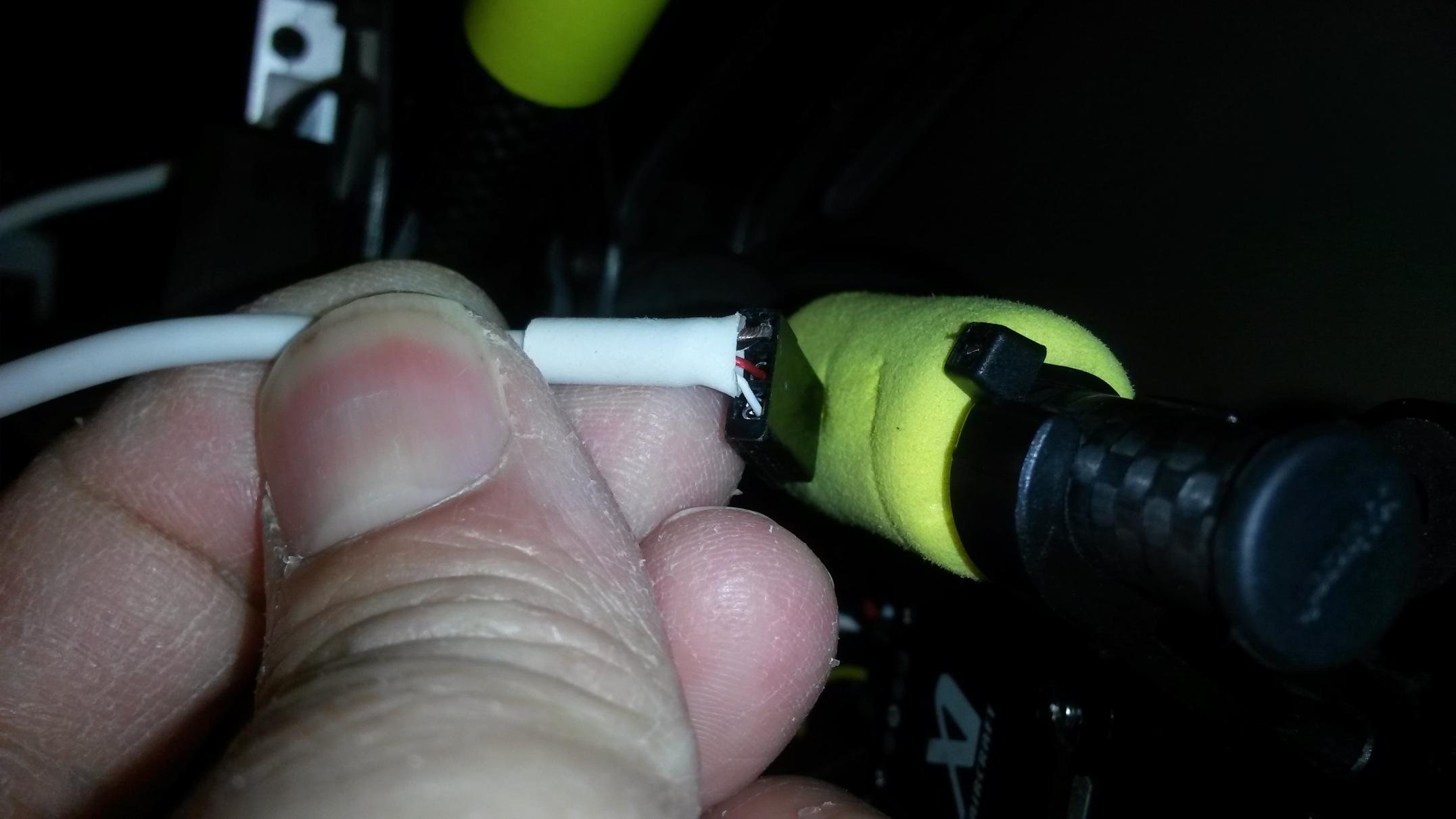

Now that is very interesting regarding the retracts servo arm, as it is not the one that comes from CC
Theres not a lot of room in there, is there.
Also what I don't understand is they are def the CC (CarbonCore) ESCs, and they look like the motors too, which is not the same ones as posted on that site?
