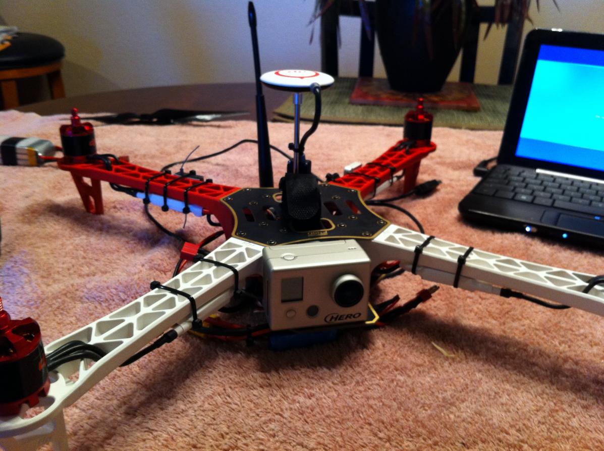

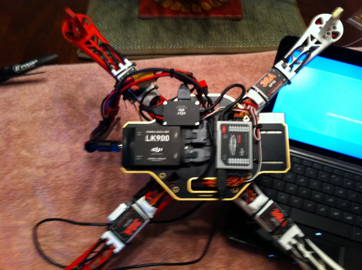

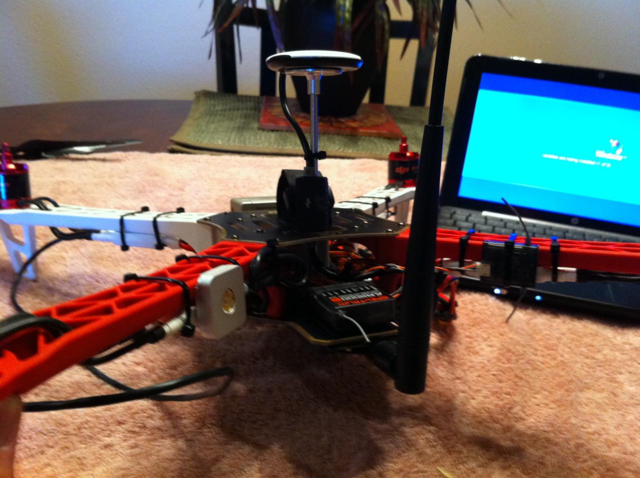

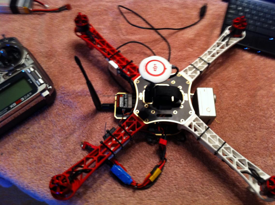

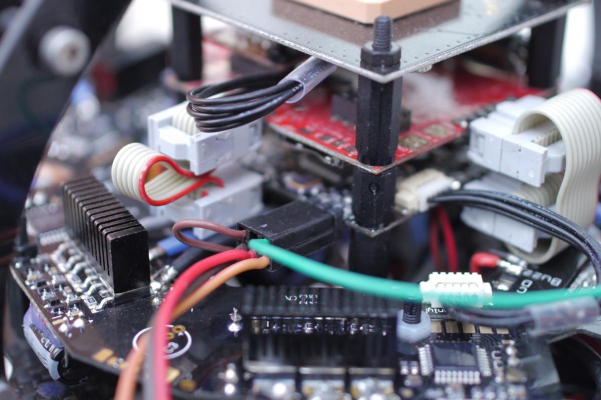

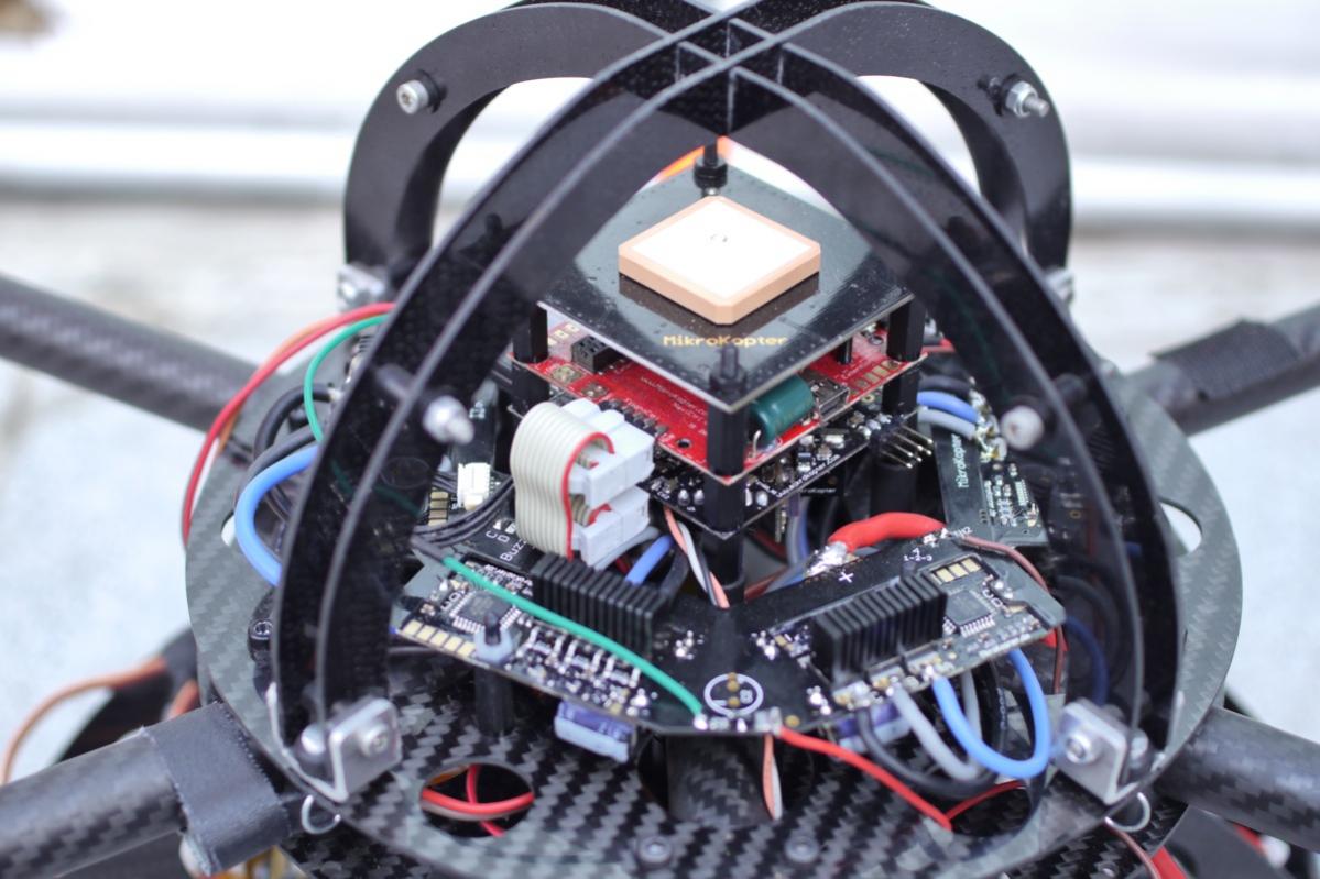

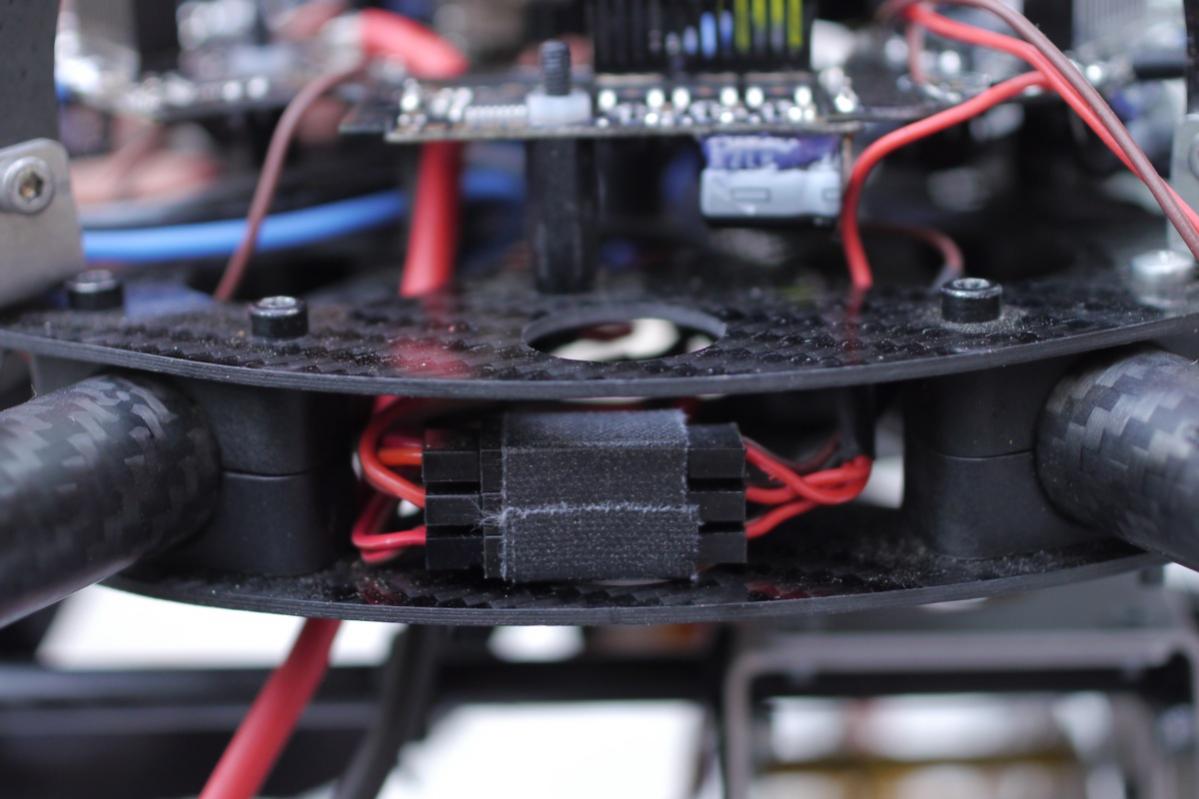

Yeah, that does look clean but you have a lot of vulnerability on the bottom there. Where do you stick the battery?
On my large hex I got wires sticking out left and right. but I made the carbon pieces to fit fewer components originally so it is kinda my own fault. I'll have to CNC some larger discs for this to be pretty.

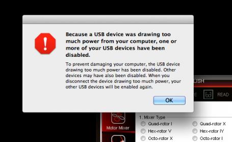

Hi Guys, I've got the same problem that it looks like Yuri had but I still can't figure out how to get around it. I've tried 3 different computers all with the 32-bit driver, nothing happens. Solid blue light on the Wookong's main controller. I think I might have a faulty WKM? This is so frustrating as its taken SO LONG to get all these parts to Australia, simply to find I cant get the driver to work!!!
The first time I tried to connect USB it gave me an error saying it was drawing too much power, so its been disabled? Don't know why it would do that!
Any help would be hugely appreciated!!
