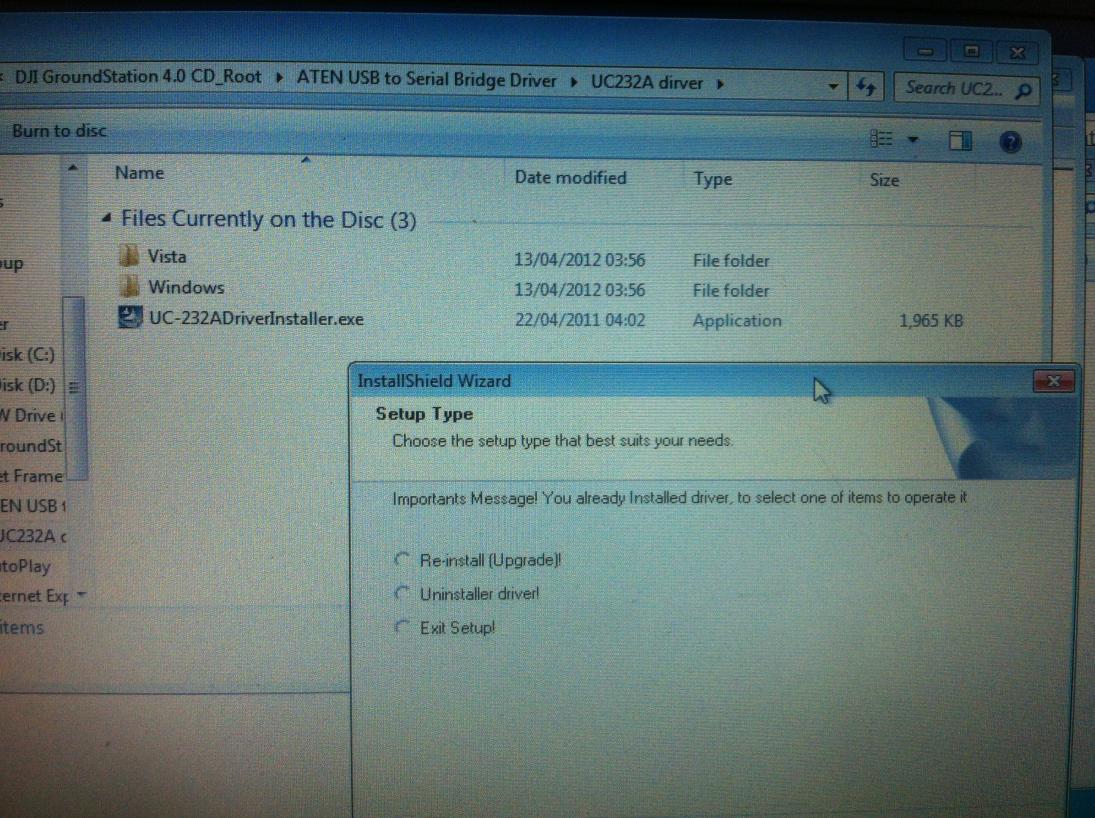

hazardpro
Thanks for your reply, although as above... it says its already installed (and I have tried re-installing multiple times).
If I run the disc and select to install the driver I get this: (which would indicate the driver is already installed)
Nevertheless I select to remove and then re-install. I've even tried it by running the install files directly on the disc.
Weird huh?

hazardpro
View attachment 9485Ok just reinstalled driver again, now I have no warning in device manager but instead a ? With 'no driver installed'
if I then try to load the driver from disc is says the driver is already installed?! WTF
Zzr
Weird! First you plugged both USB from GS receiver while install it? What OS system u're using?
Weird huh?
