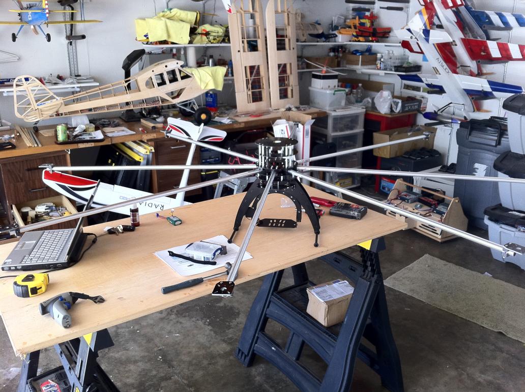

@ flyeye.....big is right....I don't think it's going to fit in the trunk of my Honda Civic like my MK Okto does......hmmmm......may need to think about my next (used) car.

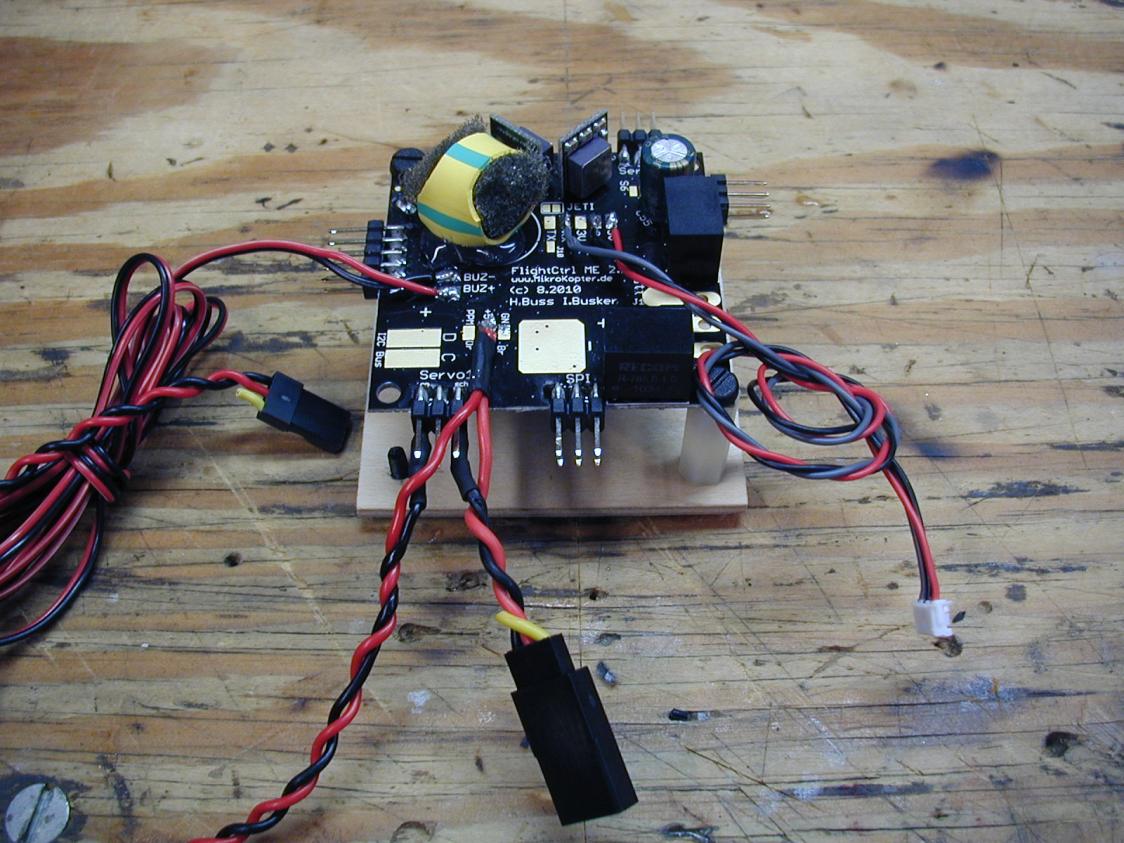

I've been in the basement getting the flight control ready to mount to the frame. In the pics you can see the foam heat-shrinked to the pressure sensor and you might not see it but there's a glob of hot glue under the sensor so it can't vibrate and break the prongs. This happened to my first MK board, caused a crash, and now they're saying to do it as standard practice over at MK.us since the XL MK's are seeing more and more of it happening also. I tried to find the least dense foam I could so it wouldn't impair the sensor's ability to pick up on very small changes in pressure which should result in better altitude hold performance. If ambient air pressure can't be sensed at the tiny hole in the center of the sensor then the FC can't control altitude as well. Leave the hole completely uncovered though and any airflow inside the dome could confuse the sensor.
I've got wires for the Spektrum diversity board which will allow me to use multiple receiver satellites and two leads from the top SV2 position for my LED's (red for the front, white in the back). The last spool of wire with nothing on the end will go to a low voltage beeper which I won't be able to hear but at least when I get to the crash site, if it's still beeping, I'll know what happened.

Since I'm not using an MK power board, I assume I need to bring power to the flight control board somehow. Do I just bring full battery (4S LiPO) power to the big pads at 14 and 16? 16AWG wire ought to do, no? I'd bet my little stash of 20AWG servo wire would do just as well actually since it's only powering the brains and LED's (and the not-so-loud beeper).
FlightCtrl_ME_2_1
14 - Ground (GND) connection for the Flight Controller
15 - Positive (+) connection for the Flight Controller (if a power switch is being used)
16 - Positive (+) connection for the Flight Controller (without a power switch)
In looking at how the Molex connector replaces battery connection directly to the FC board, it's amazing to me that the tiny wire in the molex connector brings power for the FC and the two RECOM which power the servos. That seems like a lot of current for such a tiny wire.

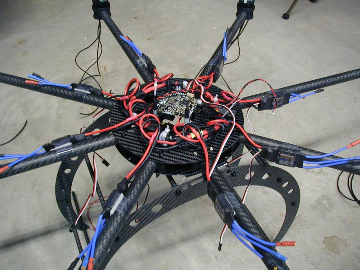

Thanks for the input Ken. I'm also in the process of trying to decide what to do about my ESC wiring. The power leads on them are kinda short but I'd like to avoid a solder joint mid-run so I'm considering pulling the power wires from the ESC's and soldering my harness wires directly to the boards where the wires were. more work but i think a neater installation

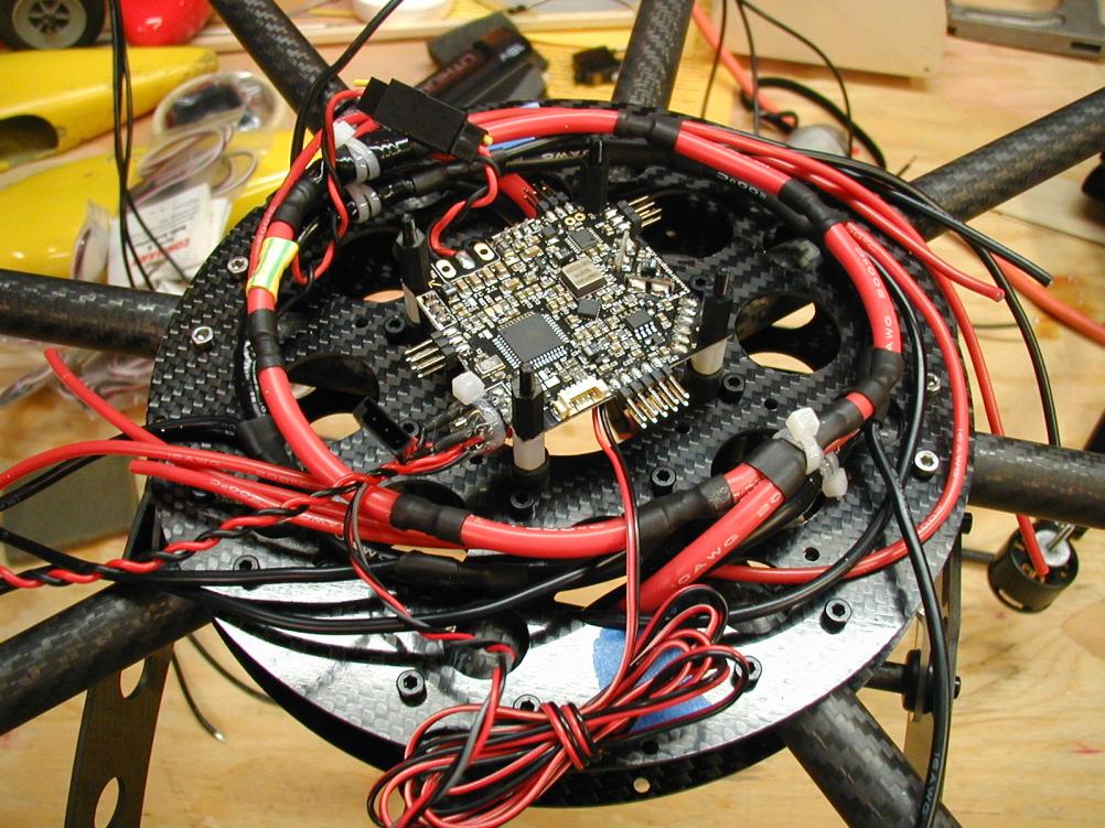

my wife has the kids at her mother's house so i've been in the basement all day enjoying my last day off before starting duty tomorrow. finished powering the ESC's and mounting them to the booms. next comes sorting out the I2C/PWM converter.

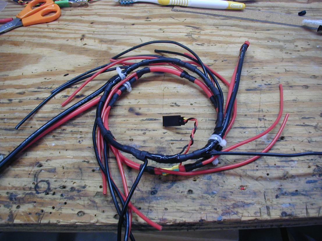

as far as the power harness is concerned I took two lengths of 10AWG wire and attached deans plugs to the ends. then i toyed around with ideas about where to mount the batteries and how to route the wires. with that decided i then looped the wires so they tied into each other so i'd end up with two battery terminals each feeding the 10AWG loop from either side. i did this for redundancy so i'd have two independent battery connections rather than one with a parallel Y cable like my other MK. so the 10 AWG loop is fed by two batteries and there are 8 16 AWG branches soldered onto the loop for the individual ESC's. I also pulled power with 20AWG wires and servo plugs for the FC power. power to the FC will only have to power the FC/NAVI/GPS boards and the LED's (edit: and the gentLED for the camera since it needs 5v).

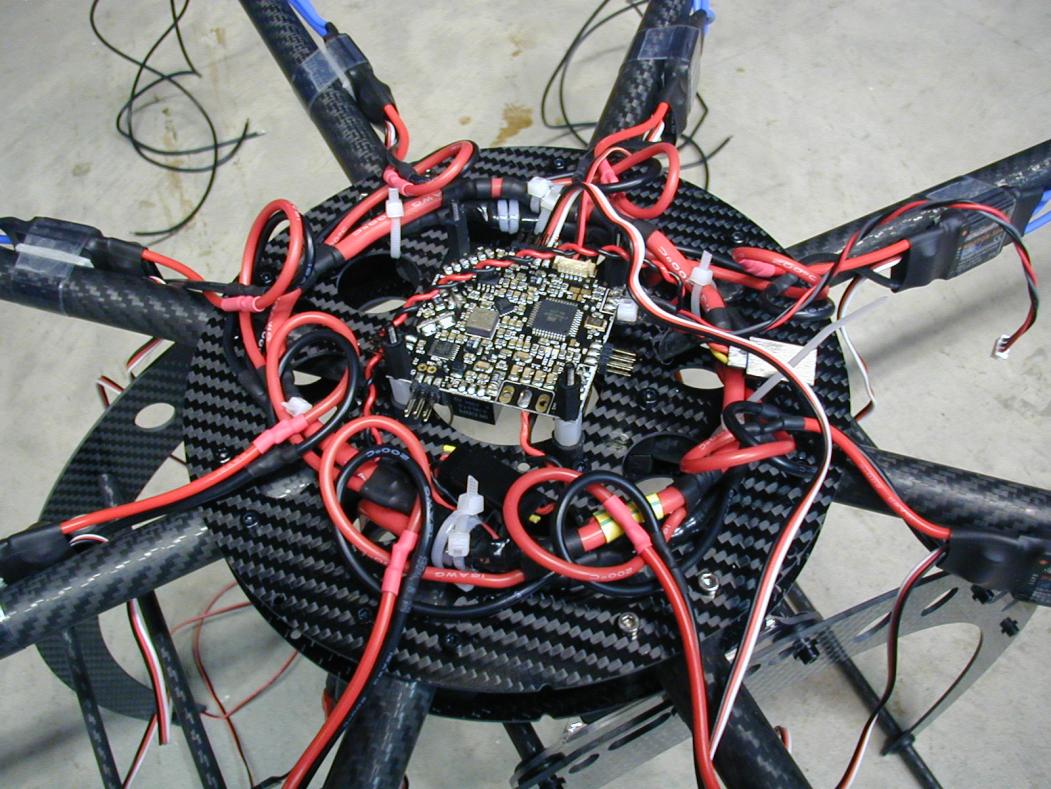

The pic shows the connections for the I2C to PWM converter. The instructions say you can use a servo connector but I opted to solder everything. Thank you to the heavy duty servo extension that gave its life so i could use twisted wires everywhere.
edit, after wiring the converter to the FC I found out that you can't calibrate the ESC's while the FC is attached to the converter so it's been undone and I'll use a servo connector like the instructions say to do.
Moving right along, today I'm hoping to have the motors connected just in case the props arrive in the mail later on. Have to see the Dr. at 1:15 about an achy ear so there's that to tend to as well.
Commentary: With all the work involved in going the I2C/PWM route with ESC's and wires seemingly everywhere, I'm not so sure I'd do it again on an 8 rotor. It's just a lot of work and it isn't quite as elegant as the MK power board. It's amazing in building all of this how many tiny solder connections there are where failure of any one of them can be game-over. My first MK was ARF'd by Ziggy and I was in such a state of amazement with it that I didn't notice so many of the tiny details. This build though has me intimately involved with all of them so it's a real eye opener. There's a conversation in another thread about quality vs. redundancy and I'm ready to vote, I'll take BOTH!

The clear material is regular 3M vinyl tape. It's about $2 at hardware stores but I'm pulling it off and replacing it with regular old black electrical tape. That tape is going to collect all sorts of dust and dirt and, since it's clear, it'll look like hell before too long. It would be nice if I had little flat mounts that sit tight on the round tube so a small zip tie could be used. I may try to make something that can be glued to the arm for the ESC's to sit against or maybe velcroed to. I don't love the way it is with the tape.

just finished the power harness, the servo connector is for the power to the FC. next comes the connections to the ESC's. View attachment 1076View attachment 1077
Hey Bart,
I noticed both + and - loops of your power harness are connected (complete circle). I was informed a while back that this can cause noise in the power lines. The best way to eliminate the noise is to not have the negative complete the circle. On one of my hexa's I had it make a complete circle and never had a problem, but from there on I have never had the negative form a complete circle. It may not be an issue for you but thought I would pass the knowledge on that was bestowed upon me from some folks who know about electricity.

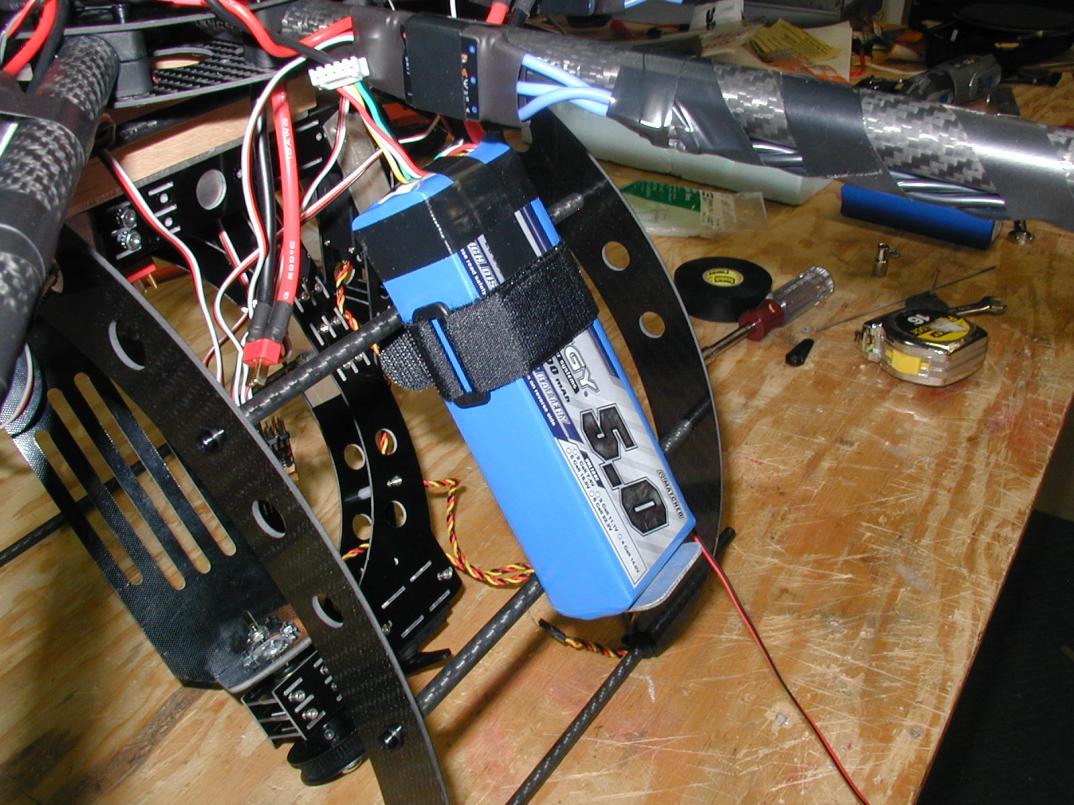

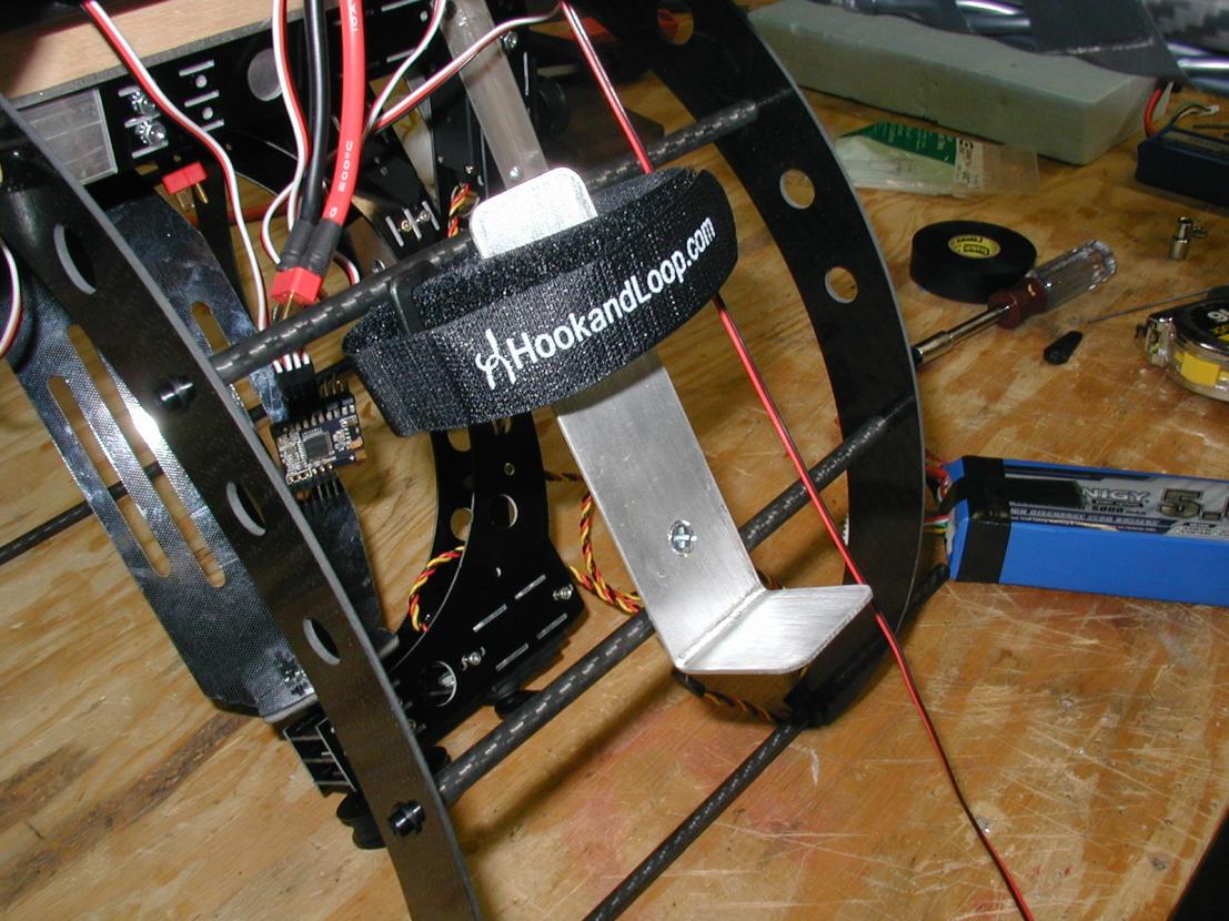

Things are moving along and I'm about ready for a first flight. Given the nature of my flying lately I thought I'd post a few pics before the flight rather than after.
Here are the battery mounts for two 5000 mah 4S Lipo packs, one on each side. The goal is to have a battery slip out the bottom of the mount in a wreck rather than stay attached and have it's weight do damage to the frame. This has worked pretty well with the flimsy plywood mounts I made for my MK Okto.
View attachment 653View attachment 651View attachment 652

Macsgrafs
They look great Bart, shame I cant do that to my CS8...my camera mount is controlled bu a camera op & she has to be able to swing the camera, but for a fixed forward camera this is great.
Ross
