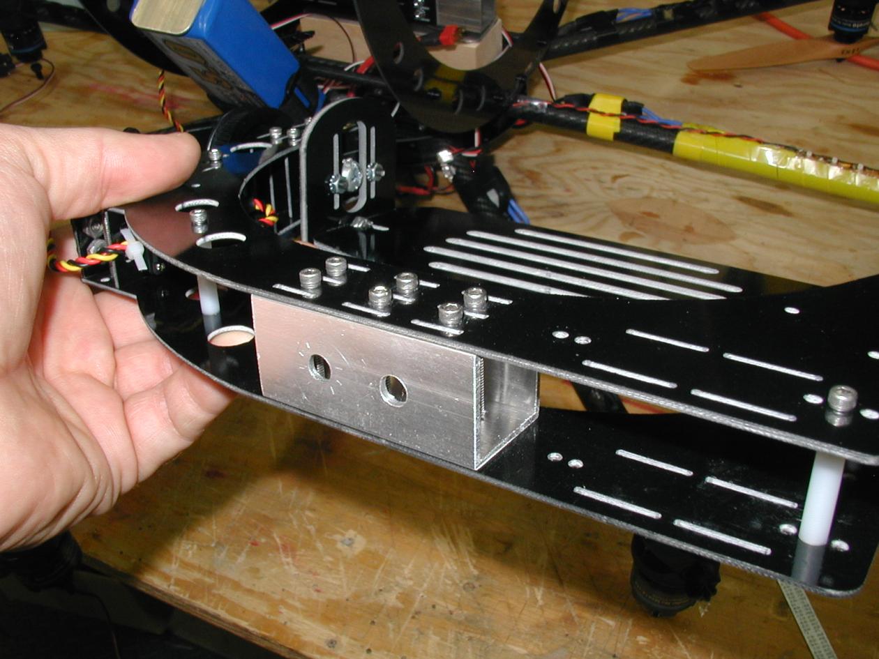

I finished assembling the averticalview.com camera mount a few days ago and had to come up with a way to mount it. by itself it had a tendency to lean left or right and that would be worse as the cameras got bigger so I had to drop it down a couple of inches and find a way to make it fairly rigid to the frame so it wouldn't rock. In another thread I said motion can't be controlled by some stabilizing force then it has to be constrained. Since DennyR is exploring the world of completely decoupled mounts and heli's I thought I'd make the mount fairly fixed to the frame using a 2"x2" balsa block, a 1/8" aluminum bearing plate to keep the balsa from crushing, and long 5mm screws that go through the frame and arm mounts to the top side of the center frame. I've seen Gopro cameras mounted to frames with velcro and the results have been surprisingly good so I thought I'd lock everything together with minimal vibration isolating materials and see how it works. the mount has two Hitec 7985 servos so we'll also see if the digital servo route is all bad or not.
I also replaced some of the flat G10 pieces with 1" square aluminum tubing since it fits perfectly and is more rigid. There are also two short pieces of small aluminum angle that are keeping the mount's arm from twisting. The goal here is to have zero free movement of the mount other than what can be controlled by the stabilization.
View attachment 657View attachment 658View attachment 659
