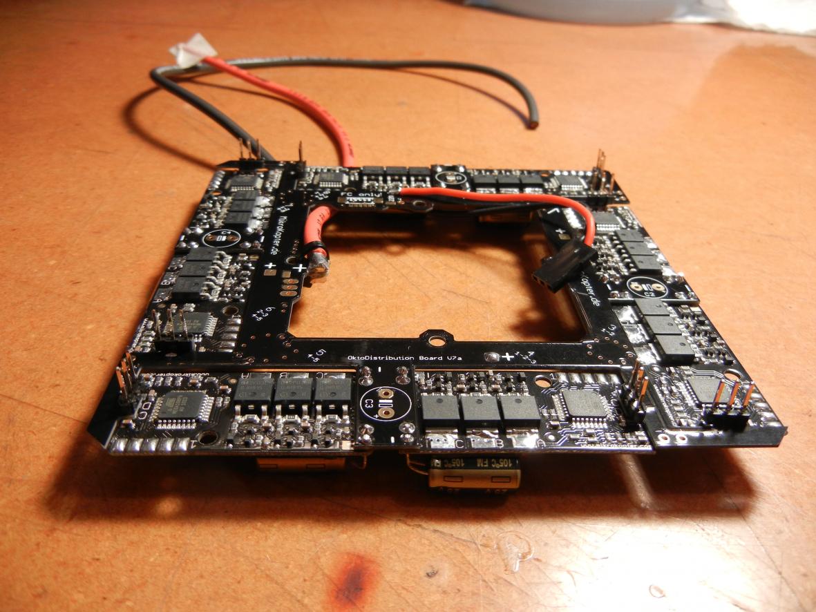

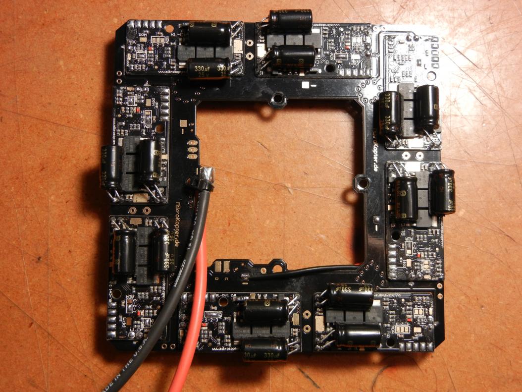

I hated the standard PDR also. The layout was cheesy and weak plus it was a PITA to remove a bl if you needed to.
The Octo XL board is a lot better setup as it overlaps the edge of the bl's and the jumper wire is straight through plus it attaches at 3 points instead of 2 making the bl more stable. I have the standard lift Octo but I liked the XL PDR so much I put one in mine. I also found a neat way to make the I2c connections for the Isolator.

Dave,

Bart,

Fox,
do the BL's come with the three prong servo plugs already attached for the I2c isolator wires?
No I added those. The circuit trace for the I2c is visible on the board so just cut the trace right at the esc and then soldered in the three prong header where you are suppose to install jumpers anyway. I mainly did this in attempt to cleanup the wiring some but could also help with trouble shooting if the need arose.

Thanks for the pic. Do the plugs extend through the BL's to the underside and get soldered there?

FOX222
Yes they go through a small protrusion on the PDR and then through the esc at the "C" & "D". The XL PDR has holes that align vertically with the holes in the esc so it is sitting just under the PDR. If you need to remove the esc from the PDR you just heat the pins on one side and push the esc down then the same on the other side. I like it a lot better then the standard PDR plus it allows for two caps on each board (better power handling) and you have 2 circuits for power between the boards (less resistance).

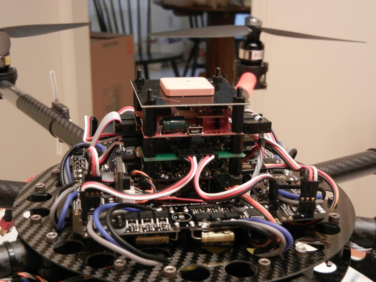

Fox222.. do you know what temp your BL get to fully loaded up?
Bart I am not sure it is so much of a problem if you put them under the hud on the AD8. Have you seen how Sandor at Digitech keeps his cool? His latest video is very good and he addresses cooling of the BL's.
No I am not having any issues but I am using the smaller motors so it's not the best platform for comparison. I am starting on a hexa heavy lift today so by the end of next week I can tell you more about temps. We are already getting temps in the upper 80's here so I can get good ideal of how they handle in warmer weather.
