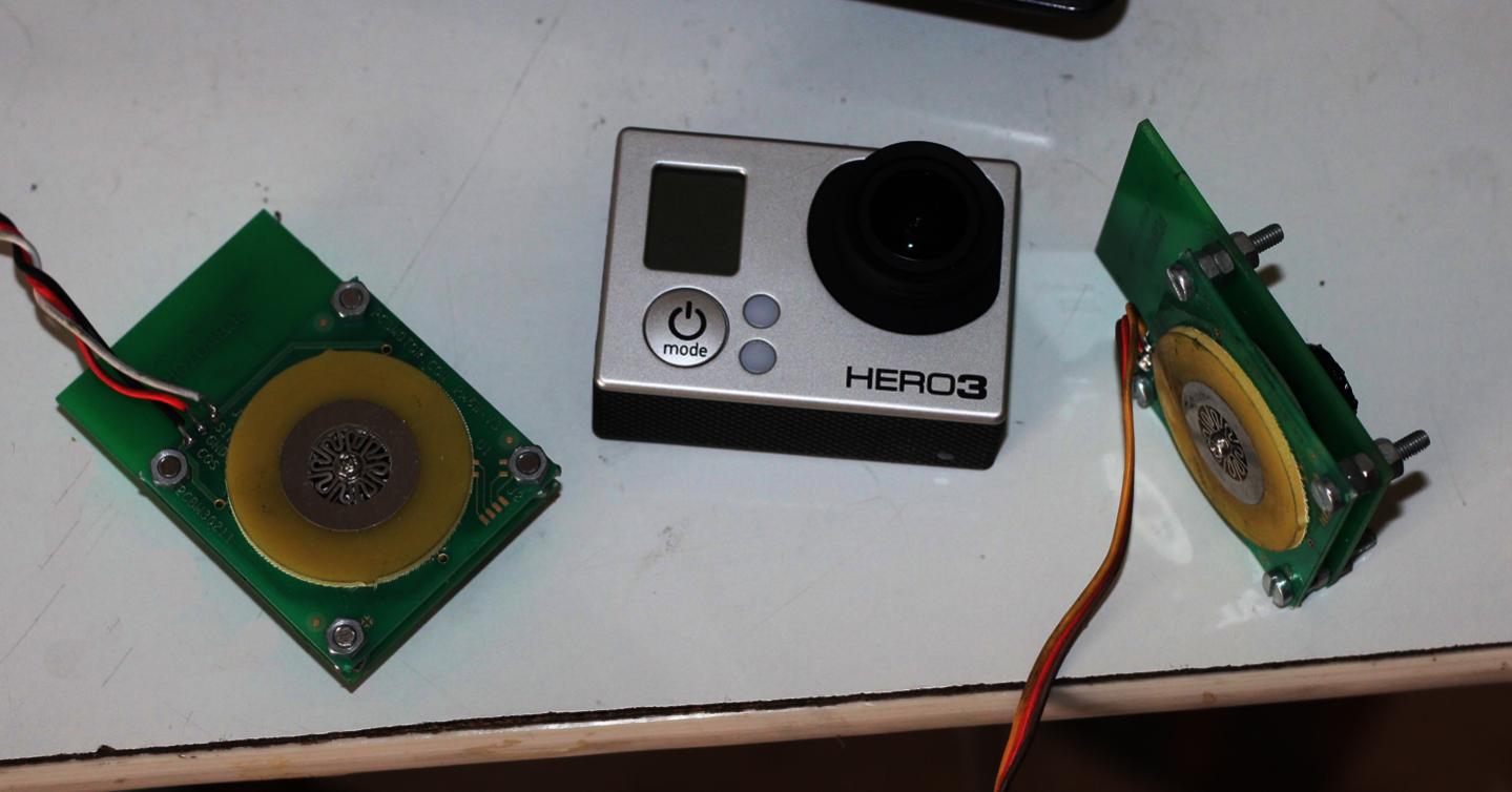

Yes I have been working on a similar project with something that could turn out to be even better, smaller and lighter using these flat Piezo PCB motors.
well I mean the electronics
do you know if someone is already working on different motors as well?
I suppose I can modify a couple of good motors and upgrade my already direct drive gimbals with this new elements

heheh funny one not sure in which way i mean it :)

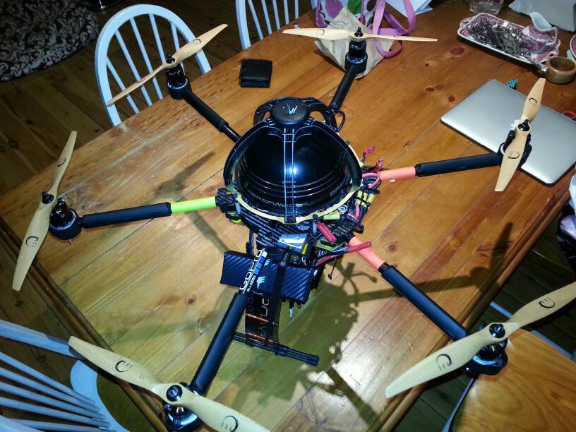

during you video for the brushless gimbal what hexacopter platform are you using i really like it. if you could please reply with the brand name or if it is custom built it would be much appreciated. i love what you are doing with the hobby. thanks!
BorisS
It's not my frame or gimbal :) just to get misunderstanding out of the way. I'm cost commenting some jada jada. Right though the frame is from flyfuino. Have one here. Good choice for the money !!!
