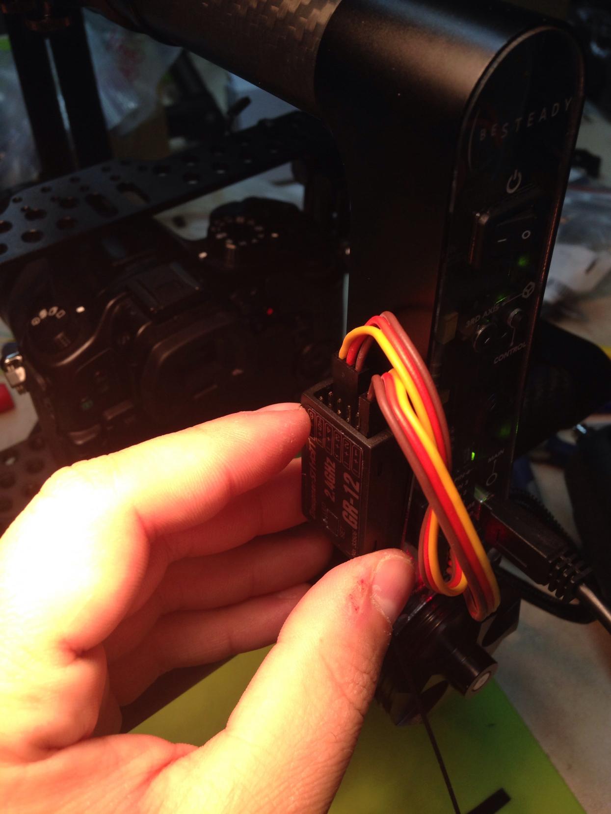

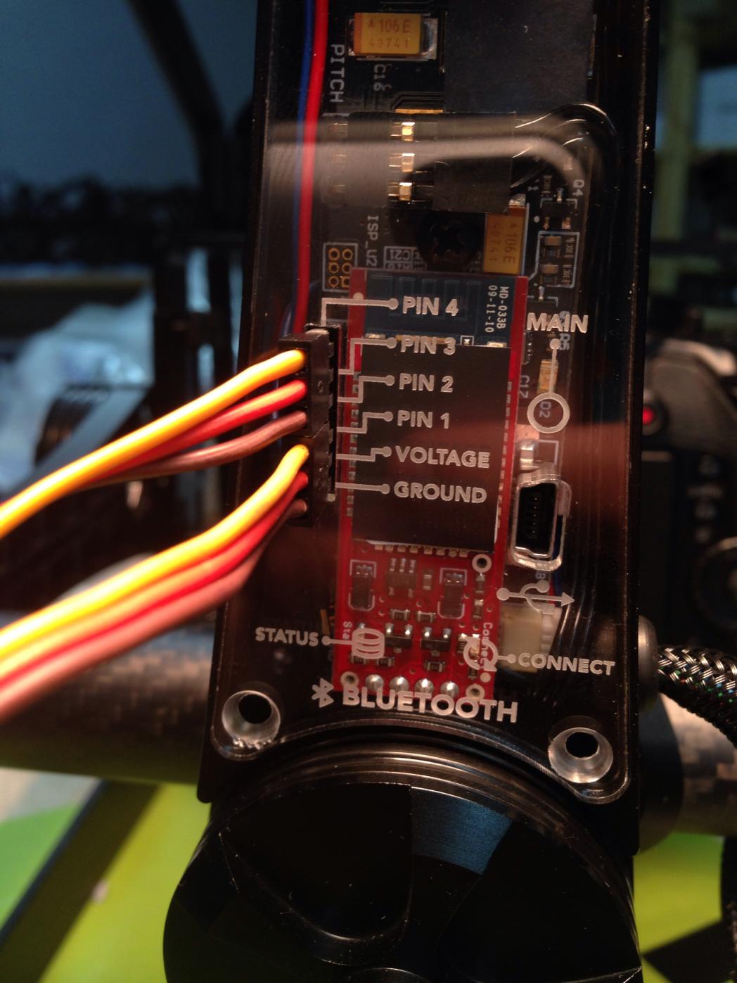

I fired an email off to Prokopi this morning asking how to set up the RC; he was kind enough to reply within a few hours with a slideshow of images that were good enough to get me going. No text, but the images should be sufficient. Pretty much confirmed how I thought it would be done.
If you pm me your email, I'll forward the email I got from Prokopi to you.
In a nutshell, use a servo lead from the ground, positive and pin1 to the throttle channel of the receiver. This will provide power to the receiver and gives one signal line. The connect another servo lead from pins 2, 3 and 4 on the besteady to the signal ports of say channels 2,3 and 4 of your receiver...assuming 1 is your throttle. The two servo leads in the back of the receiver will be at right angles to each other. Then go into the GUI and set up the various parameters, which you wont be able to do with a dodgy usb. Have you tried bluetooth? I read on the besteady facebook page that the pairing password is 1234; dont know if that's correct cos I havent used it.
e2a: I think I'll be attaching the gimbal to the Droidworx the same way. Cant for the life of me see how the multirotor adapter plate will help.
Got the images thanks, so the receiver doesnt require any power then, its gets its power from the Besteady without any BEC or anything?
I'm raging now, I would love to give it a go but can't:)
You are correct...it gets its power (I assume 5v cos it hasnt fried my receiver) from the besteady pins. Dont use the servo lead on the stage, thats 12V I believe! I can imagine your frustration, are they sending out a new unit for you?

Don't have the Besteady any more, but here are the pics to connect it to a receiver.
View attachment 17841View attachment 17840
