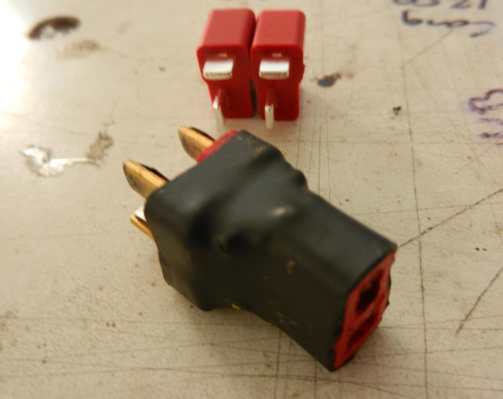

it would be a parralel connection. i take deans and solder them into these kinda things, no wire, just the connectors like this, ben the paralel ones together to the opposing sides ground side, top + side is just one big slab of solder

I'm thinking of dual packs in parallel. Actually, that's a great idea. I'm also thinking of running a 4s bat. Will try one out tomorrow when my best friend comes up to Ottawa.
Thanks man, Yes I'll try a parallel. I actually use Anderson Power Poles. They are the best! and no soldering necessary.
