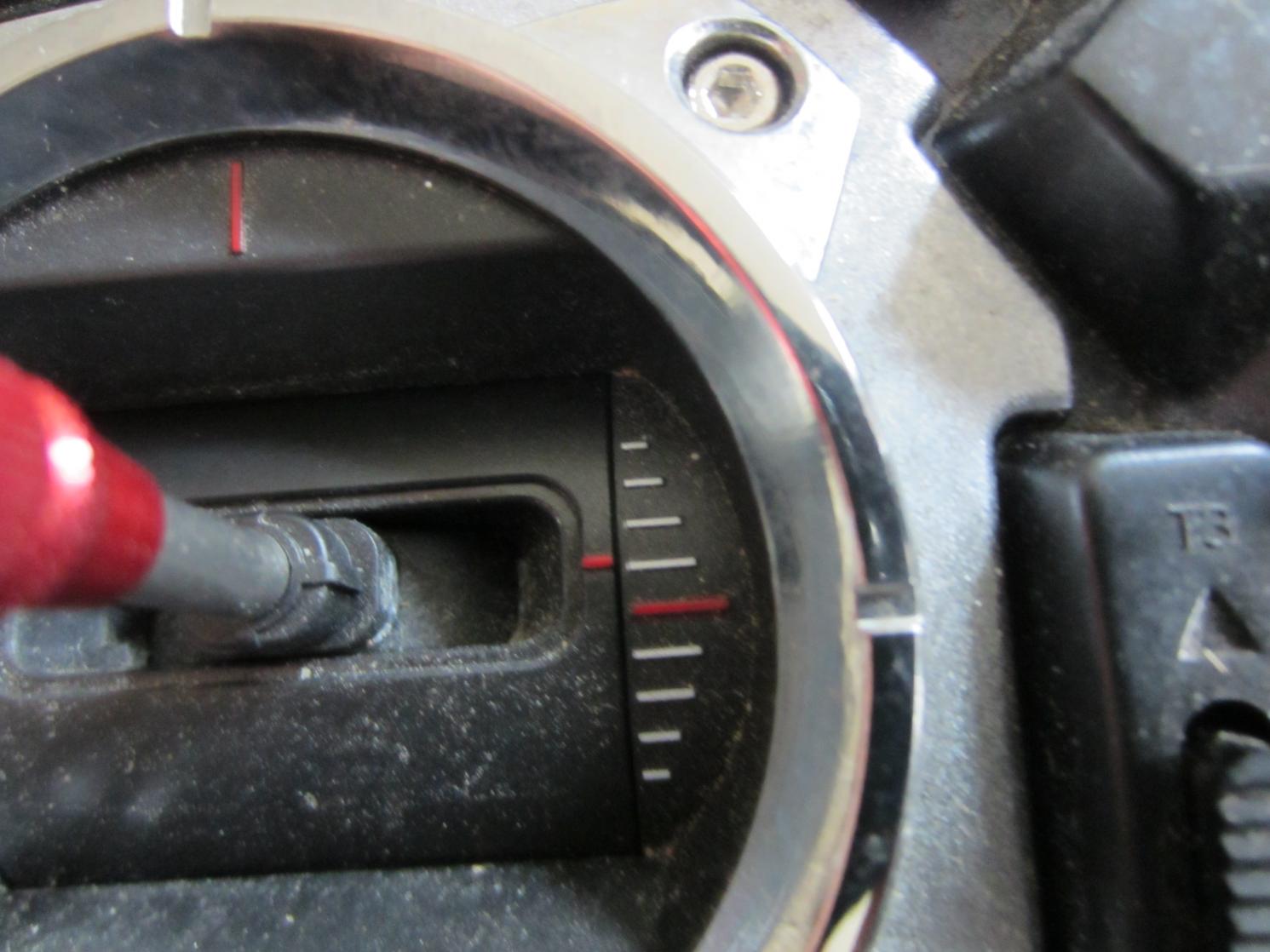

Here a photo of stick position in a hover in Manual

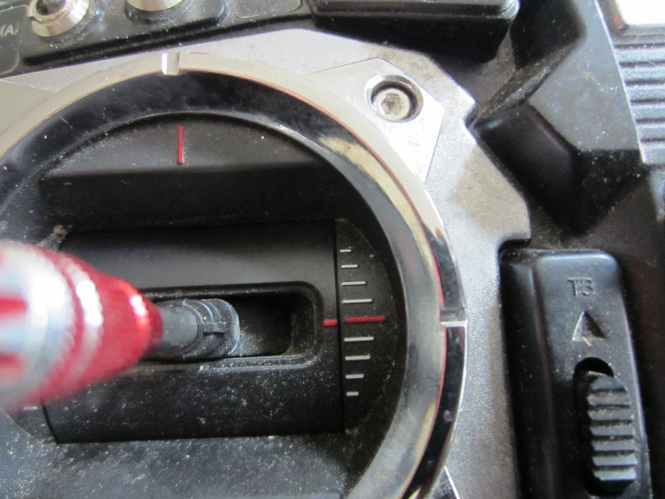

And here's a photo of centre stick in Attitude.

yea, so that's why the going up when you switched.
If you set it to mid stick, do the assistant calibration, hit finish, you could correct it with the throttle curve easily. does your radio have that?
