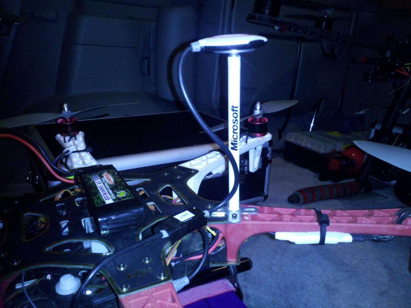

took a cheapo BIC Pen.. removed the ink, and some pen, you just have to trim the first few inch off the tip where the ink comes out...
Perfect fit around the original mounting.View attachment 6992View attachment 6993

Thanks for the reply guys, I'm very relieved the GPS doesn't HAVE to rely on the mast, love the BIC pen solution BTW, very cool :)
