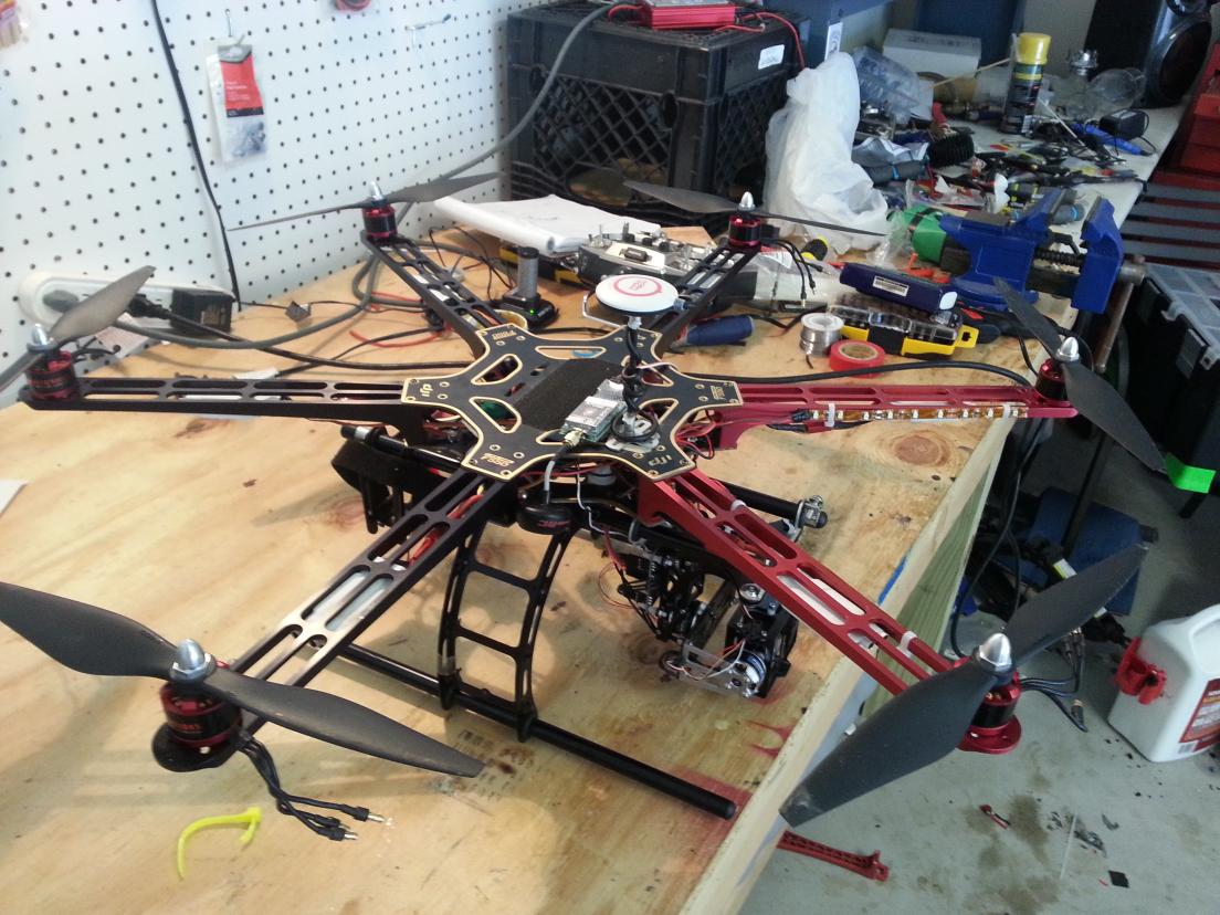

Something like this then.
My F450 X8 is currently stacked as I have been wanting to add my FPV gear back on.
As seen here it does just at 10 minutes with a 4S 5000 35C Hyperion or Mad Dog battery
2 4S 5000's supply up to 15 minutes of flight time and it lifts that easily.

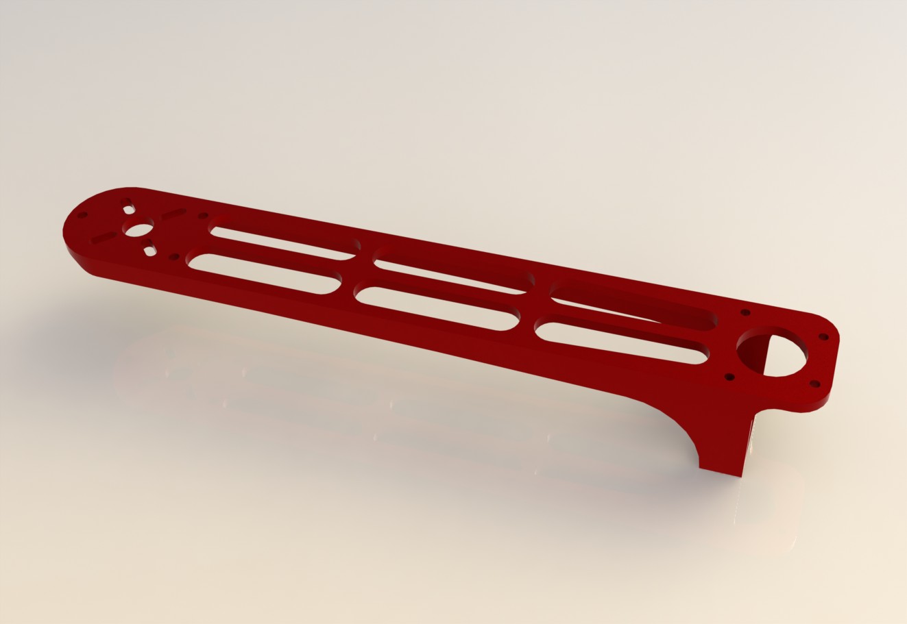

Maymidroix
ALUMINUM ARMS for frames using DJI Style arms. (TBS DISCOVERY, NEX Quad)
Hi everyone,
I'm Michael, the designer of the AIMDROIX Aluminum arms. I wanted to share a few pictures of the arms of some customers.

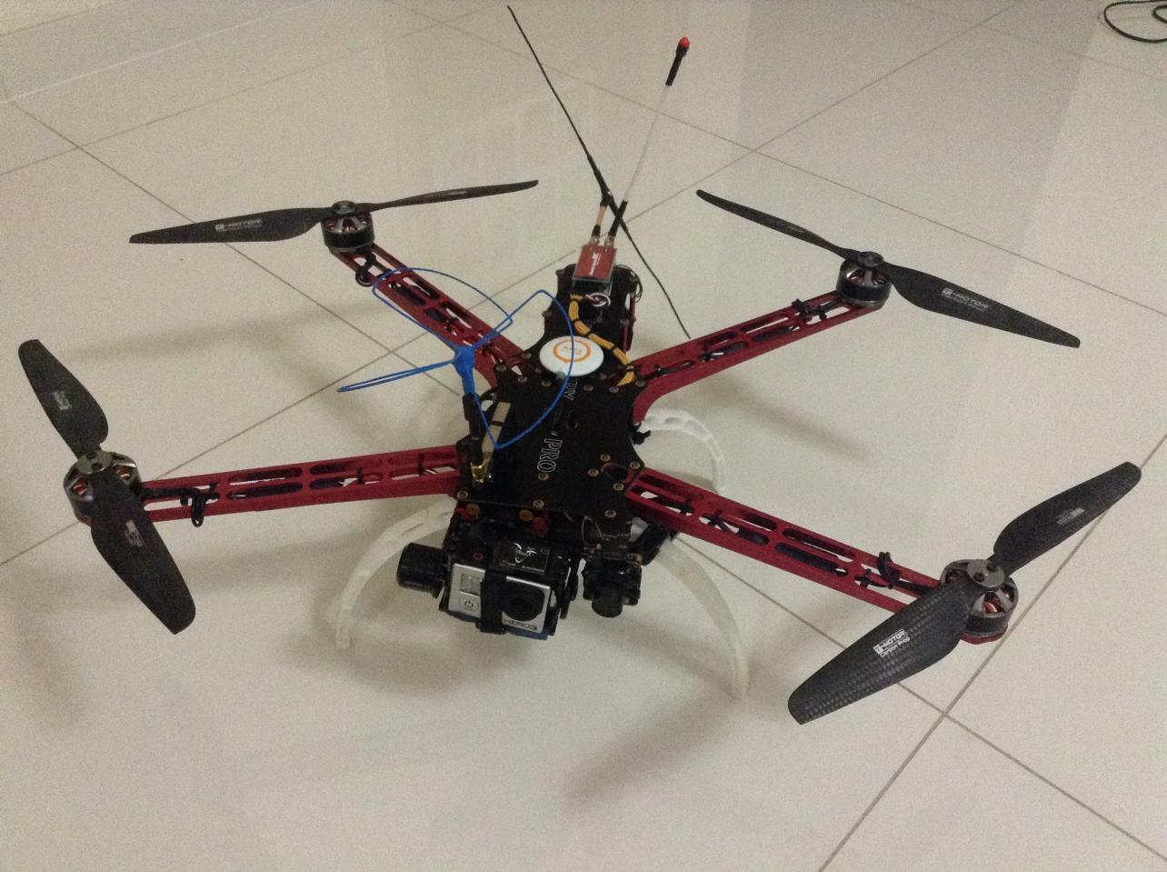

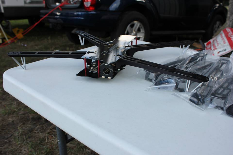

TBS Disco:
View attachment 14753 View attachment 14754 View attachment 14755 View attachment 14756
DJI Hexa:
View attachment 14757 View attachment 14758 View attachment 14759

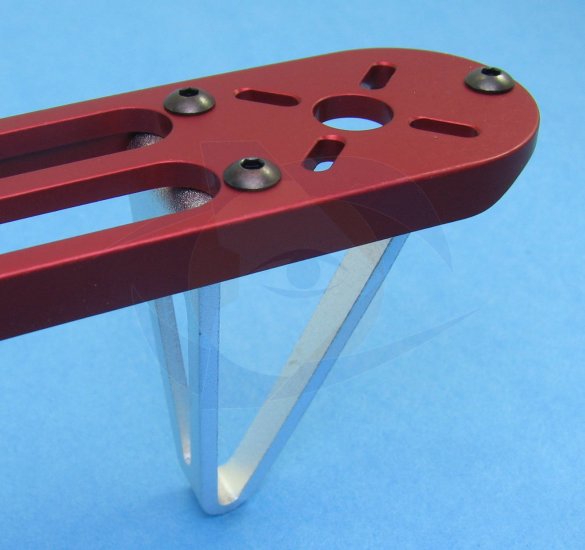

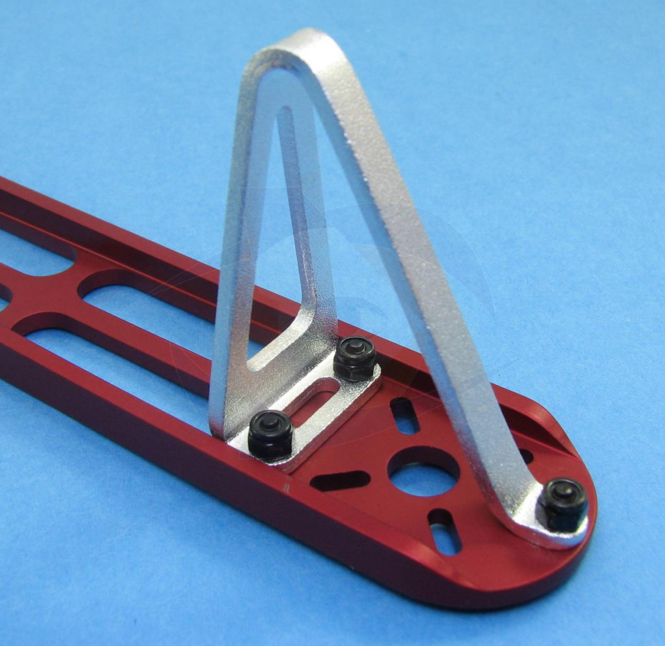

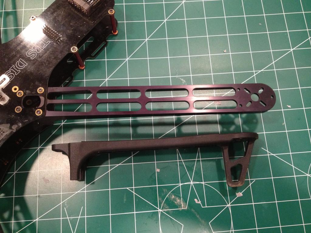

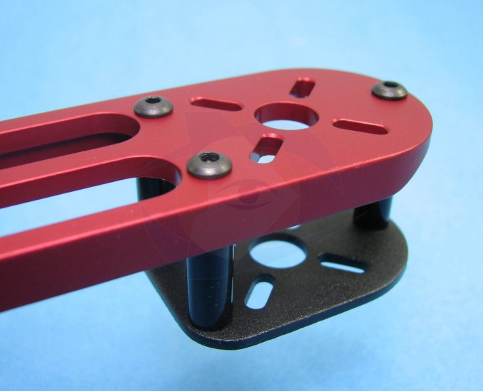

Recently I released some accessories for the arms. You can choose using aluminium legs of the same height as the dji stock arm or the coax motor mounts:
View attachment 14760 View attachment 14761
It has been a lot of work during the last 3 months, but finally all my products and are available at Ready Made RC. http://www.readymaderc.com/store/index.php?main_page=index&cPath=165_295
You can find some videos in youtube. http://www.youtube.com/results?search_query=aimdroix&sm=3
Please like my facebook page. https://www.facebook.com/aimdroix
Feel free to ask me any questions.
