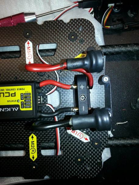

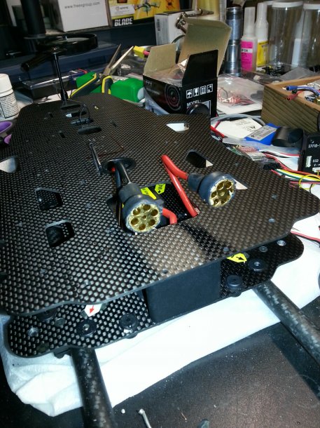

here is how i added more power outlets since i needed the original six for my motors. Will secure it some how if i can not find the block align uses. And picked up 12 3.5 bullet connectors to feed wires .

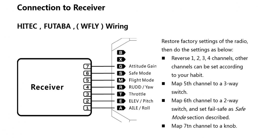

Sorry, for some reason I thought you meant right yaw. Drift is either cg or try redoing radio stick calibration. And you do have the first 4 channels reversed with that futaba as per manual? I also disable trim on 1-4.
Yes radio setup as per manual first four reversed,think I it maybe the cg . Align had thiers in middle of frame which is three inches back from where they say the cg is.

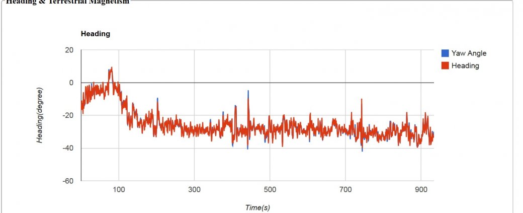

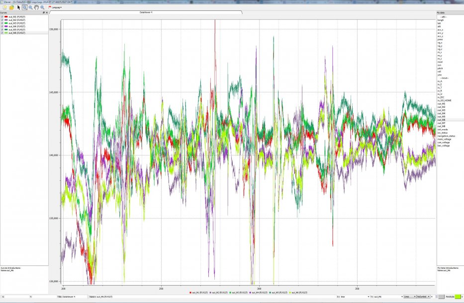

6 sats to lock.Yes it does matter on calibration direction. Unless you post a log file your not going to get definitive answers.
If you worried about disclosing your location, just post screen shots of the report pages. I can tell immediately if your compass is calibrated or not.
fltundra
here one i just did after calibrating radio and compass
http://log.xaircraft.com/#2015_05_13_185750.500_5.1.15.33
still the same effect drifts to right and forward , with a little aileron to the left it is solid .

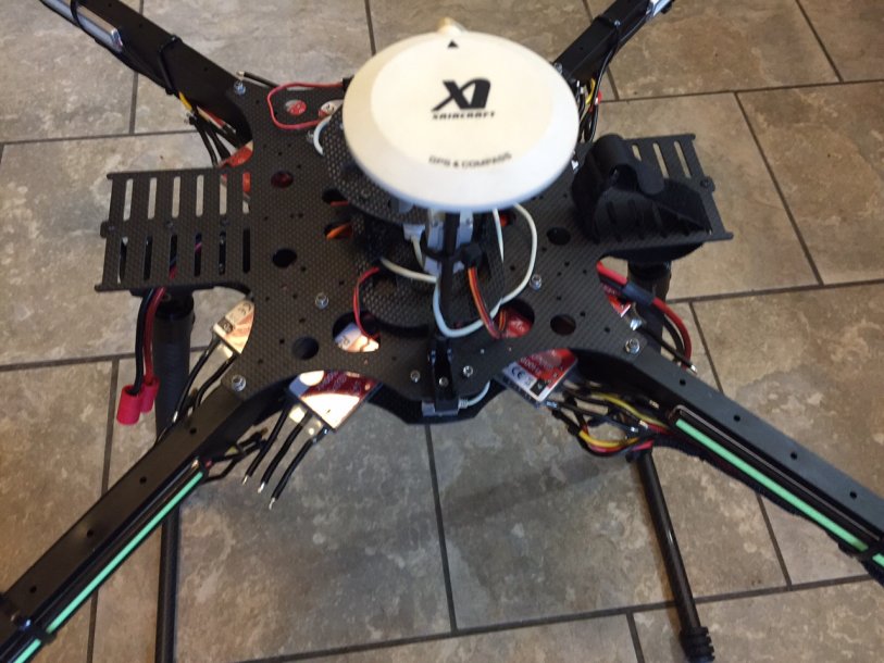

It's like your FC isn't mounted level with the motors. Please post pics of your setup. how have you mounted the FC? And how are you checking the CG? Disconnect the GPS and fly it in Atti mode and see if it still drifts. There's something going on with the compass readings.View attachment 24670
Found your photos in another thread. Look at the location of traxx 2003 FC mounting location.
I would swap the locations of the IO and FC, if it still doesn't fly level with the GPS disconnected.
Run a string between M1 to 4, M2 to 5, M3 to 6, where they intersect will give you best location for the FC.
Funny you mentioned the string I did that last night and the intersection is dead over the arrow on the flight controller. And the position of the align fc is in the location where i have the io.
