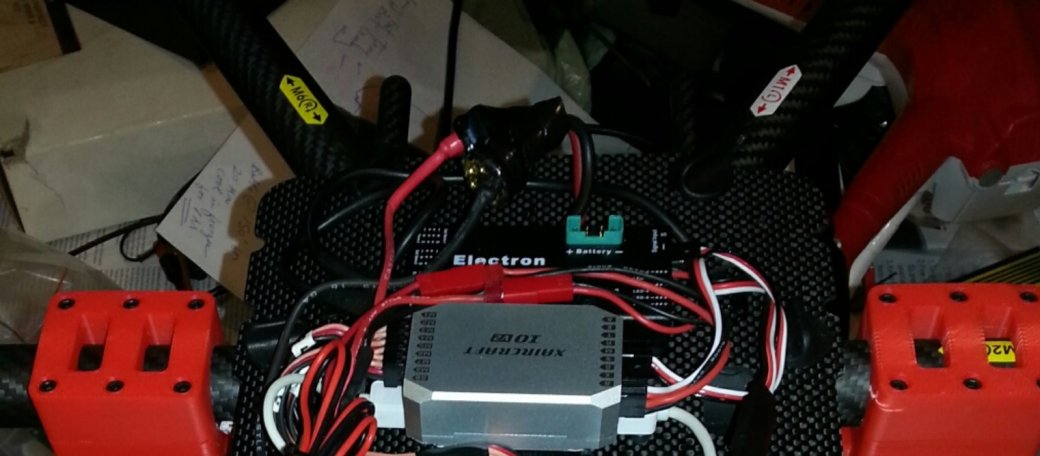

so what does todays log tell you , had moved the retracts to the receiver connected the super x to 6s power and cleaned up wiring . Also checked the level of each motor

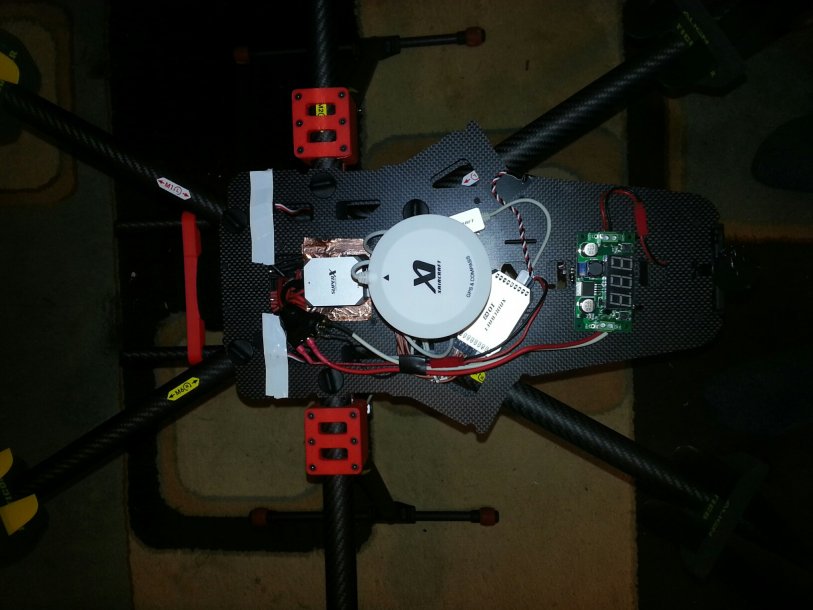

here is my last attempt when wind slows down if this does not work there has to be some thing wrong with the fc or gps because it worked fine with the align fc.
fltundra
Well 10 min this time but when i switched to altitude hold it was back .

You took two steps forward and three steps back. Motor alignment in you first log you posted was almost perfect. Now you have a 20% spread on the 11 min flight. I overlooked the the voltage in your earlier logs. But you only want to power the SuperX off the flight lipo only. It already has a built in BEC. Your retracts should also be connected directly with or with out their own bec. Signal wire from retracts only connected to the receiver.
I am using the super x motor configuration and rotation. They both turn the same direction except the motor counts are opposite from super x to align. But they connected as per super x manual.

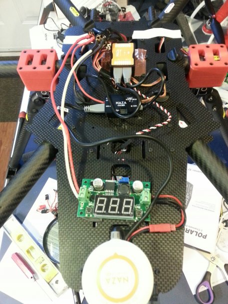

So I installed it in a f450 went thru all the step and the same thing drift right and forward. It did hover in gps for a few seconds when I took to about 30 meters up . Here is the log file for this install
http://log.xaircraft.com/#2015_05_19_184528.250_23.1.06.02
only thing would be to use a different radio , the 450 is much easier to calibrate . Which in the manual it says to do it hort. then nose up and last on the side ,which is different then all the videos out.
update the 690 flies great hold a good hover in gps using the naza v2 and futaba 14sg . So the issue is with the super x fc , xaircraft is going over the files on it . Hope it works I really like the super x and think it will be a great system.
