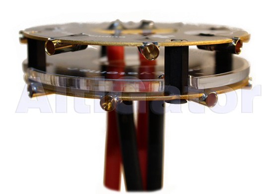

JLO..... Nice Rig there...... I am not up to that weight category but I have some reservations about the Power Hungry PDB which I have examine and modified.
IMHO - The aluminum plates with the heat conductive paste is not well engineered since the source of the heat is electrical resistance as a result of passing high current thru very thin copper film that is deposited on a PCB insulating base material.
Solid copper sheeting is vastly superior and would not require any heat sinking aluminum whatsoever.
I bought some copper plate and will be building one without the heat sink...... but need to test it in a high current electrical lab if I can find one.

JLO
attachment.php
Hmmmm! my initial thought is that my Power Hungry unit is made with 2 solid coper plates separated by plastic standoffs and am acrylic plate where do you get that it is aluminum made
take a look at the picture this is like the one I have

gtranquilla
RadioActive
You are correct! That is a properly designed PDB......
The name of the one that I have is so similar......I thought it was the same one!
Mine is the HobbyKing Super Hungry PDB as shown here..........
http://www.hobbyking.com/hobbyking/...ry_Board_Multi_Copter_Power_Distribution.html
a cheap knock off of your original!!!
HK copied a properly engineered product but used cheap PCB board material with thin layers of copper plate on both sides, then added aluminum heat sink plates to top and bottom.....
