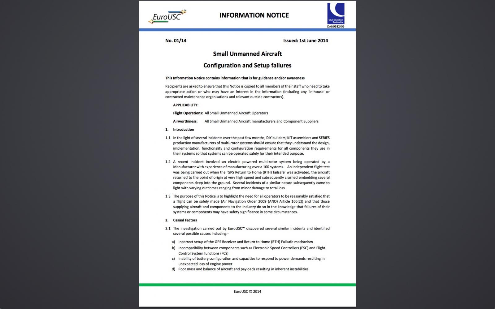

baja-king
Here for the ride :)
roryhinds
Thanks Ed, yes we are in communication via email now which is fantastic.
I've sent Ed and DJI all the iOSD logs I have. For some reason the first time I connected the iOSD only 2 files came up which where just logs from testing the rig on the bench before flying.
Hopefully they have what they need now to get the data and find out why this happened.
Tahoe Ed
Is this the one you're referencing Dave:
View attachment 23729View attachment 23730
Baja thank you for posting this. I think that there is some wisdom in the statements made in the document. It shows that for many crashes there is plenty of blame to pass around. I agree that manufacturers can do a better job of communicating the requirements of their systems. Some components do not play well together. When that incompatibility exists, which manufacturer to you blame? What responsibility does the owner/builder have in the equation? These are very complex issues that hopefully some wise people figure out.
