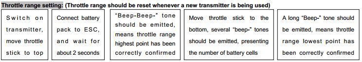

Some of the older ESCs need to have the throttle range setting configured in to the ESC such as the Turnigy Plush as shown here:
But I have never considered adding this step since I have never had any issues previously with the throttle range using DJI FCs and Turnigy Multistar ESCs.
Also it seems that DJI WKM and A2 built these ranging options in to their Assistant software anyway..... unlike the XAircraft configuration software that requires this to be done manually with RC system and bypassing their FC altogether.
So is it possible, that I need to reconfigure all my ESCs for the correct throttle speed range?

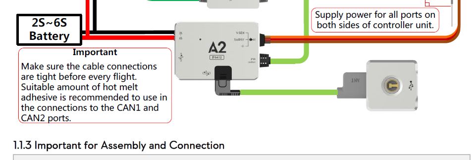

to all.... don't forget to affix the canbus connectors into the FC using a hot glue gun as explained in the DJI A2 documentation. Otherwise you might find GPS is not as reliable etc.:dread:
EHHHHH! Hotglue.. FFS please point me in the direction of the instructions that point to me having to 'HOTGLUE' connections on the "impossibly Precise A2"

Page 6 in newest version 1.16! called hot melt.... see image here. I missed it the first 3 times I read the documentation but noticed that the Canbus connectors seems quite loose.
View attachment 18798:highly_amused:

i had mentioned doing this in the NAZA review (or an A2 thread, I forget) because of all of the plugged connections. even the most expensive aircraft grade cannon plugs can have loose connections after being in service for a while so a bit of glue once all of the connections are complete is cheap insurance to make sure vibrations don't weaken contacts over time.

I understand your feeling but mitigation is the No.1 rule, if you can secure something further then do it. I agree that DJI should use a better connector but that's what we have to work with at the moment...
