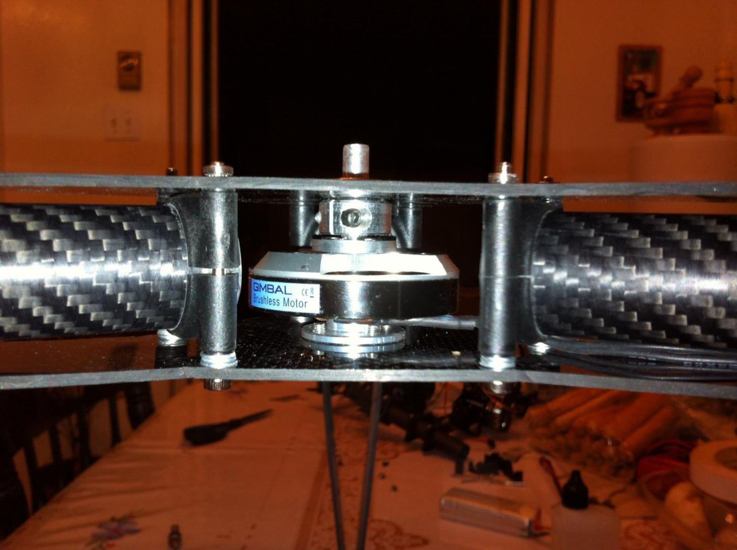

Hey guys, I set to making my 3 axis gimbal with old skool servo's a brushless one. So I set a couple of days aside to work in my workshop and put my 3d printer into overdrive. Anyway I bought two pancake motors that were prewound to 150 for $50 each and a Martinez board with gyro for $50 (www.buyitonline.com). This was my outgoings for the project as I have a 3d printer, material and various bolts and nuts already. Anyway gimbalzilla is now complete aside from the 3rd axis of which for now will stay using servo control.
Anyway with some PID tweaking I was amazed at the results, the movement is incredibly smooth and instant. There naturally is no noise either and it looks sweeeet. Anyway hope this all inspires you to do the same. The sad thing is my £130 upgrade makes my Radians, worth £700-800 worth nothing now :( I will post a video soon. Also a few people have asked me if I would like to sell the kit, I say yes but more testing is required before we all jump onboard.
One last thing is that I have made no changes to the frame or drilled holes and cut my gimbal. The motors take the place of the gear wheel and clamps onto the frame so all my old gear can go back on :livid: happy days. :highly_amused:

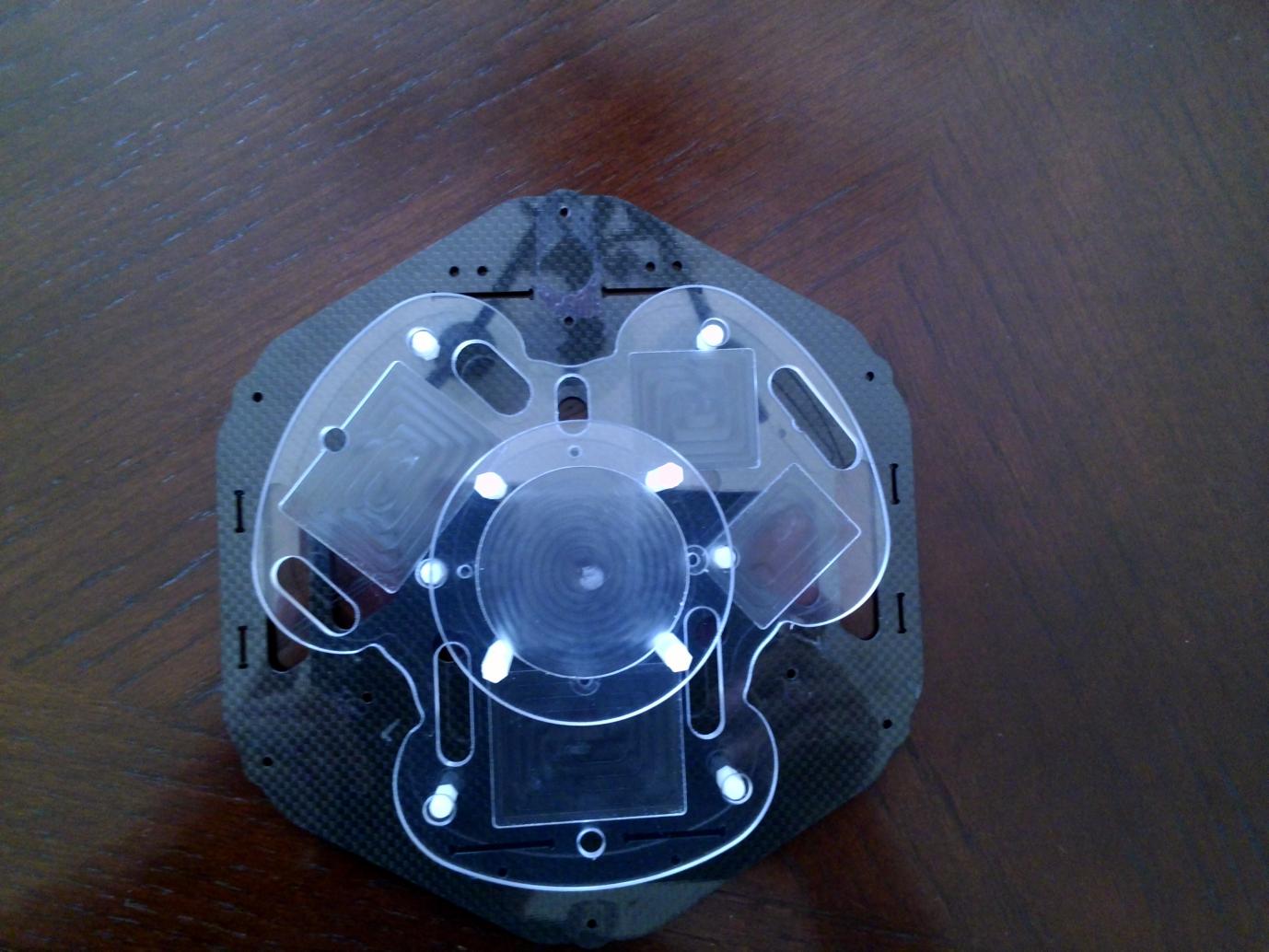

Ok So here it is!! The Brushless Conversion kit (unofficial naturally) for the Freefly 2/3 Axis Gimbal. Shapeways will 3D print and send you the kit from my designs that I have used on my Gimbal. The video of it and pics are on the product page. Anyway as I personally have not used Shapeways but heard and seen good things about it thought this would be the best way to go. The accuracy with the default material should be spot on, if not please let me know and I will have to make ammends even though the .stl file is tested correct on my gimbal. Anyway you will need various additional bits and bobs to complete the kit and this is all on the product page. The price is only for the mounting kit and only for the Freefly Gimbal.
