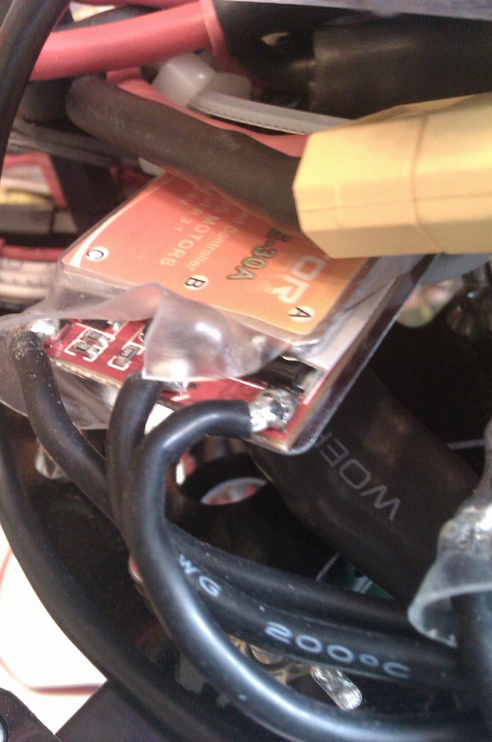

For my MK Octo xl with T-motors 2814-11 710 KV and 30A esc with props APC slowflyer 12x3,8 on upgrade to 5.06 set for start testing gains basic: P&R , Yaw= 200% Vertical 180% and atti 70%. Fly with 2x 4S 5000mAh for about 10 min with total weight of 4.5kg. When i land measure temp of motors they are warm 35-45 degree and ESC are hot 50-78. Also notice that silicone ESC transparent cover melted or breaking off (attached image). So could heat temp do that damage. I'm scared to fly again with these gain settings. When lowered gain on 150% basic, vertical on 130% and rise atti to 115% temp drop for about 10 degree. Outside temp was 24-27 degree.
With this settings cannot remove little jitter / jello effect from my video. Any suggestion? And notice also that is not quite stable on wind with these gain setting.
Maybe go and test with downgraded version or props are too big?
View attachment 4504View attachment 4505
