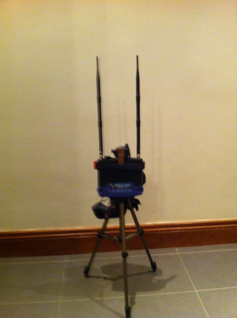

Rob, I have 4 guys & myself that have all of the sudden had issues with android connecting to the wifi module. I went and purchased a new one (the newer router model wifi module) and ditched my datalink. Works fine, but I have to load my maps on 3G in the field first, then do waypoints, and loose conenction when it is out of range. I hope Peter from ZeroTech isnt pissing it up too much over CNY celebrations.
Hi Nic.....It looks like Peter is going to be busy when he gets back.
Here is what I do to stop losing connection.
Changed the antennas from the usual 3dBi to 11dBi. Excuse quality of image
I have also stopped using a data link. I want to try and stay legal as much as possible.
