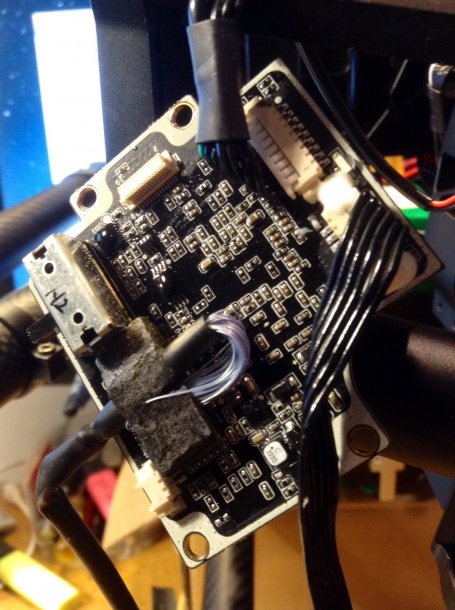

Here's this afternoon's FPV adventures: Tested my FPV screen in my office - all working fine. Take the s900 into the garden, switch it on - no image just white screen. Fiddle with camera settings, power up several times, try different power up routines - nothing. Oh well, I decide to do a hover test anyway. I take off and a few seconds later the camera view pops up on the screen, and apart from the odd moment when it disappears for a couple of seconds (i.e. not a typical fuzzy image from poor reception) stays on for the full flight. I take it all back into my office and the image is intermittent, so I poke all the wires in case there's a loose connection, but it stays intermittent and doesn't really coincide with my prodding. I try a spare video transmitter - no image just the white screen again. I switch back to original VTX and get an image. I try flicking through the camera modes but the image locks (but on the camera it's normal). I now have a locked image on my Black Pearl screen. I turn off the camera, and I STILL have the locked image on screen despite the camera being completely turned off. It only goes when I power down the s900. What's going on? :-(

Could it be a setting on the Black Pearl?
Timtim
Funnily enough, I just checked this a few minutes ago. I plugged an Immersion Duo receiver into my DVR, works fine with my Phantom2, but I get the same white screen as on my Black Pearl. It goes without saying, I've tried every possible permutation of setting on the BP and camera. I'm going to try swopping the gimbal HDMI lead next as there's a spare in the Zen box.
Timtim
OK, the spare HDMI lead supplied is not a GH4 size; it has a mini rather than micro HDMI socket. By the time I'd noticed this I had unscrewed the HDMI box. This may have been a good thing as I think my problem might have been a badly seating ribbon connector. I've re-assembled and got an image. That lead is well secured, so it's unlikely I've pulled it mounting the camera. That lead is secured by three layers of double sided foam tape inside and well held on the outside, so maybe it was not pushed into the connector correctly on factory assembly? I'm not counting my chickens until I've done a few test flights though, as I've been here before…update tomorrow

PMaughan
Well I was holding off sending my gimbal back until expected GH4 update and have a nice quiet day today so thought I'd have a good look at my instal after all sorts of issues with live transmission. So I've changed the hdmi cable and now all is well so fingers crossed it lasts! I didn't think it would be the cable as it was working on 24hz but I guess there's a lot of pins with HDMI so maybe it was just that.
