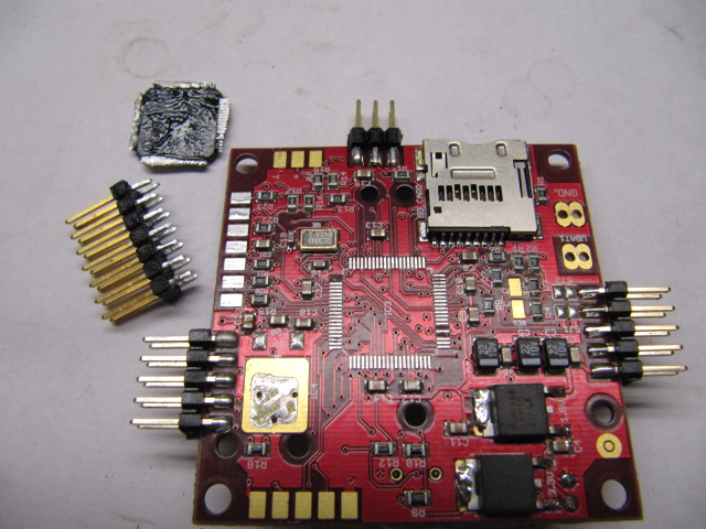

It's actually not that hard with the right tools. (see pic)
But you are right. MK should solder on at least some of the components. I think they do it so if the board is bad, they can blame it on the builder. ;)
Can you take a pic of the missing part on yours? I've been seeing a few parts falling off BL-Ctrls recently.

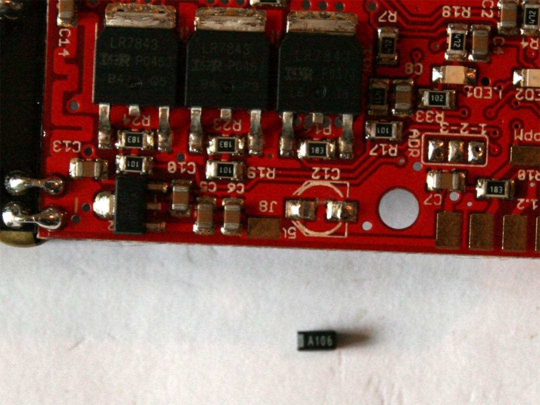

It is a small capacitor that fell off. MK said "... just solder it back on...". Well, of course it cannot be soldered because the solder pads are still on the board.

BTW This fell off one of mine
If you flip the cap over, are the metal pads still on it?
Any chance you can take a macro photo of the cap and failed joint.

BTW, MK sent me another capacitor to replace the one that fell of the BL board. The original one could not be replaced because its solder pads were left behind on the board when it fell off.
