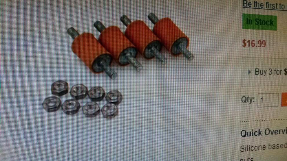

VIBRATION -BI DECK Dampening system got this idea from x heli and qav 400 I will put dampener like soft sponge with double sided tape or use the orange dampener i will use 2 lower fuselage plate drill holes and put the dampener in between them thus less vibriation here some pic- View attachment 16004View attachment 16005View attachment 16006so one of these or even moon gell will go between lower fuselage and thus separation from motor arms.
So what do you guys think will it help or not ? I will give it a shot i order a lower fuselage plate i will try double sided sticky sponge first.
