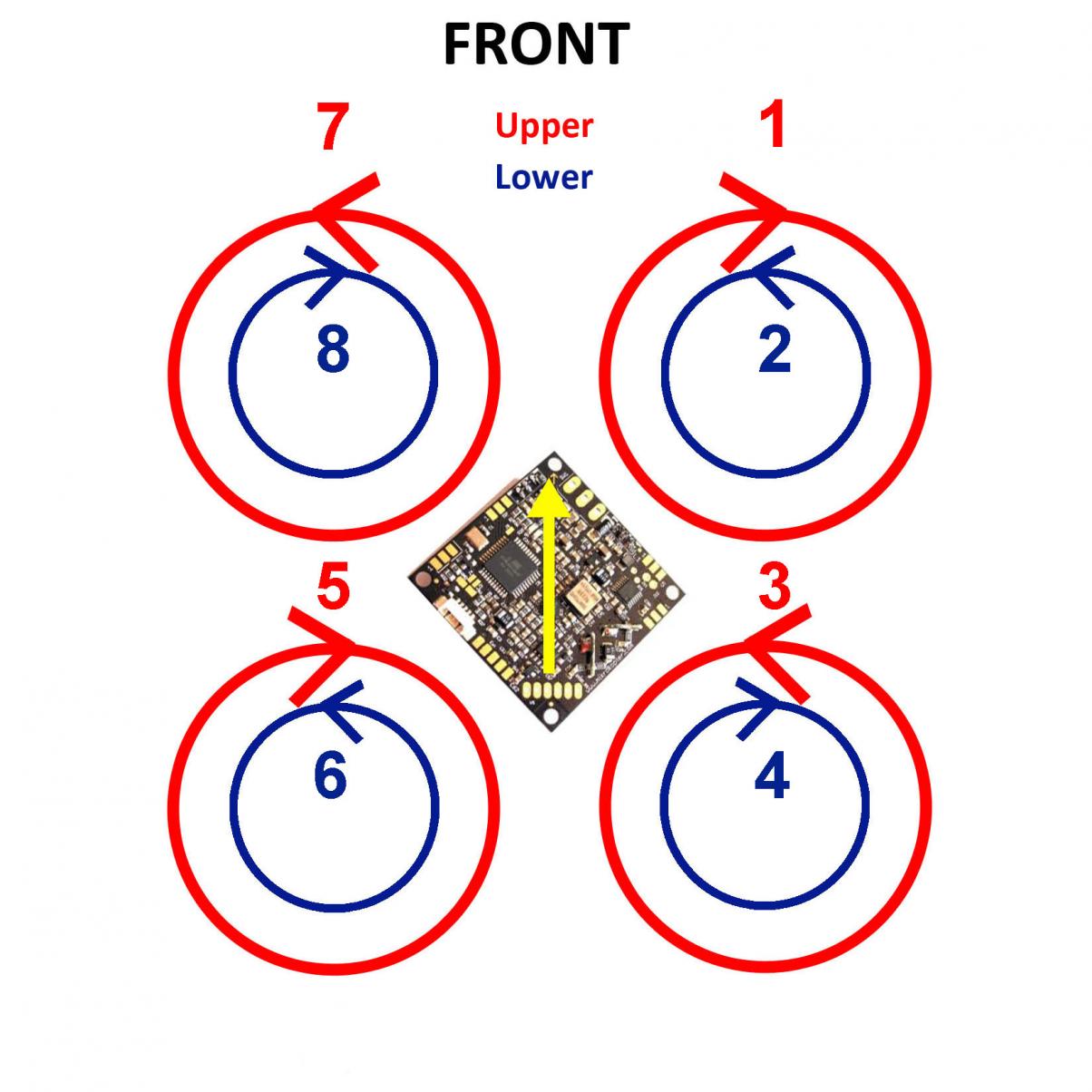

I put together a mixer file that I think will work for this configuration and would like to know if it is correct. This mixer layout will be ideal for those using the Okto power distribution board because it puts the wires from the arms exiting adjacent/below the BL's those motors are addressed to.
I used these directions (from Rusty & OMM on RCG):
Gas- All motors that are used get +64. Motors that are not used get 0 for all their settings.
Pitch (Nick)- Draw a picture of your copter, then draw a horizontal line through the center. Every motor that is above the line gets +64. Every motor below the line gets -64. If the motor is on the line, then it gets 0.
Roll- Draw a vertical line through the center of the picture. Every motor on the left side of the line gets +64. Every motor on the right side of the line gets -64. Every motor on the line gets 0.
Yaw- Every prop that turns clockwise when looking down at it gets +64. Every prop that turns counter clockwise gets -64.
Does it look right?
