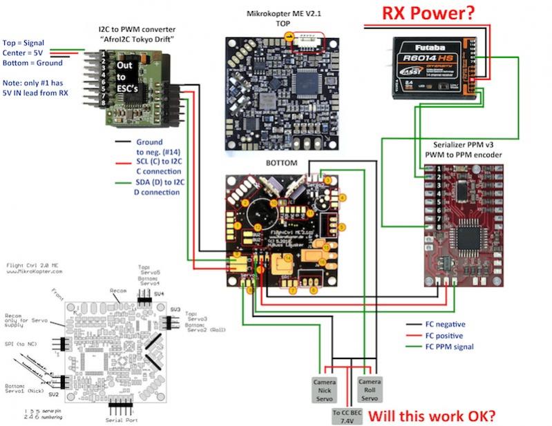

Two wiring questions?
I have been working on my diagram today to make sure I get things right and so I know what is what in the future. I would appreciate it if you all would take a look and let me know if you see anything wrong. Also, I have two particular questions:
1. Where should I connect the Futaba RX to power on the MK FC? I know there are several 5v sources but what's my safest choice?
2. With the HFP FC I used a CC BEC to supply the camera mounts nick and roll servos with 7.4v. Can I still use this setup with just the signal and ground going to the MK FC?
Thanks,
Shawn
attachment.php
zorba
Hi Mactadpole, The diagram here is wrong.
Here is the correct setup.
hi
top motors
top left motor no 1-clock wise
top right 3-anti
bottom left 4-anti (motor4)
bottom right 2-clock wise (motor 2)
bottom motors
top left 5-anti (motor 5)
top right 7-clock wise (motor 7)
bottom left 8-clock wise (motor 8)
bottom right 6-anti (motor 6)
for an X8 the fc should be pointing between 1 and 3

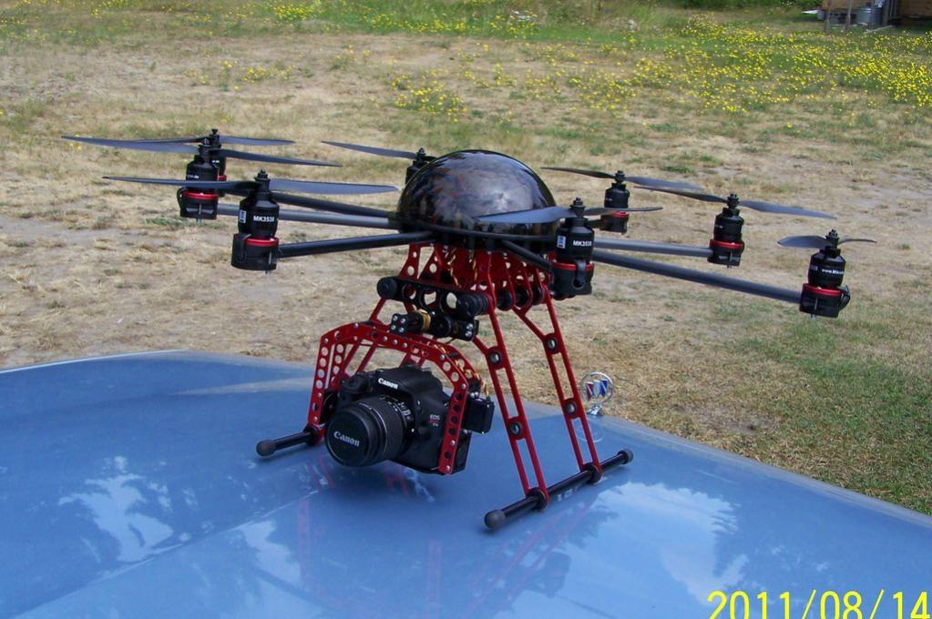

here's my 8X
http://www.youtube.com/watch?v=bkD9WZ4VV8M
Cheers
zorba
I have the almost the same setup as you except I don't use Futaba.
I connect the Spektrum sat to the 5V cause I am using the diversity board with three sats.
I also have the I2C converter from TC. It flys great. Do you power your converter from the FC?
I use the 1st ESC to power the board.
Cheers

I should have given more details...
This is my current motor/prop rotation configuration using a HoverflyPro FC. I am converting it to an MK FC but would like to keep my current rotation configuration so I can switch between FC's without having switch around motors and props. Since all the rotations are exactly opposite what you have I don't believe it should have any affect on stability. From what I have read as long as I have that .mkm file set up correctly it should work just fine.
I'm hoping to get confirmation on this. Otherwise, I will switch things around.
Thanks again,
Shawn
