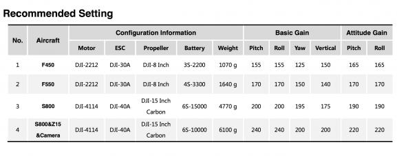

Hi Patrick,
I'm using the settings from the DJI website for my F550 and it flys much better.
.View attachment 11003
Cheers Paul
