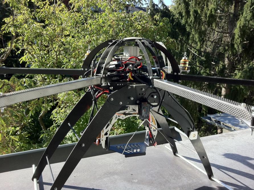

Finally have my rollcage finished. Do to the carbon I am going to try to mount the GPS directly hoping the rod will not be necessary anymore.
