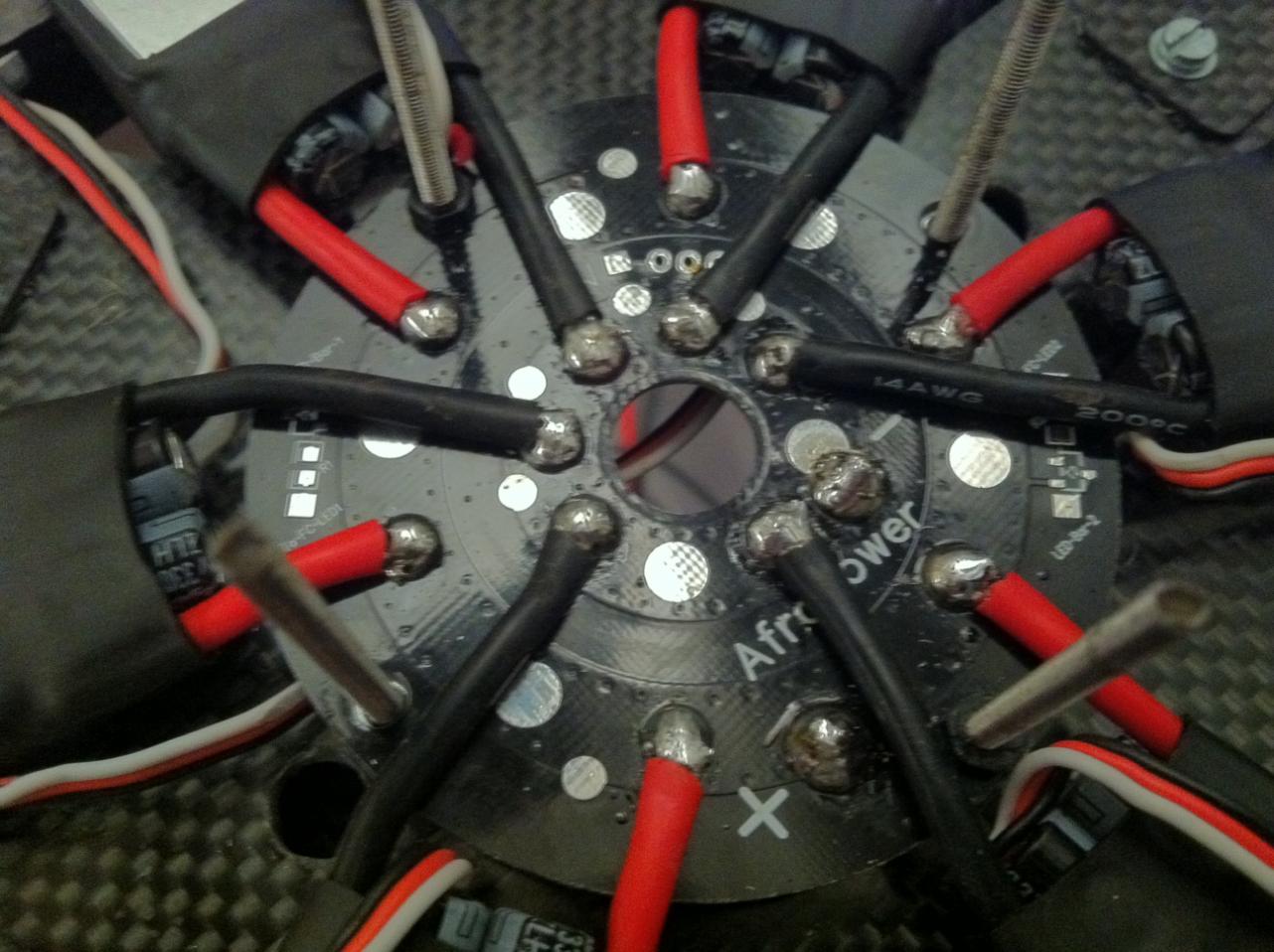

lets see how good this dist. ring turns out. Working with it was really easy and a clean job. I love liquid tape. Thanks to who ever recommended it. Only substance I cold start a fetish with :)
@ jes111 if you see anything wrong about the dist board don't say it bah bah dont ! :) I need one successful thing today ! :) even if its just an illusion !

I'm not an expert, but "Normal" sounds good ;) - certainly, the consequences of running too high on timing is excessive motor heat, which you don't have - so it sounds like the motors are happy with the setting you have.

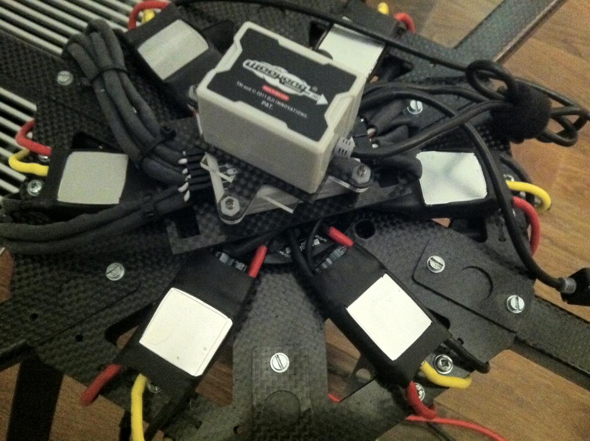

okay rebuild finished, changed Dist. ring and shielded every single cable, receiver ESCs :) with a CAT 7 shielding. A days work :)
Starting to test from tomorrow on again !

nice job! only thing I'd also do is twist the motor wires (loosely), at least until they are inside the arms and clear of everything else.
jes1111
Well, you can twist them all the way between the ESCs and the motors, but once the bundle is inside the carbon arm, the CF will have some shielding effect itself - and anyway the wires will then be a good distance from the sensitive components in the centre.
